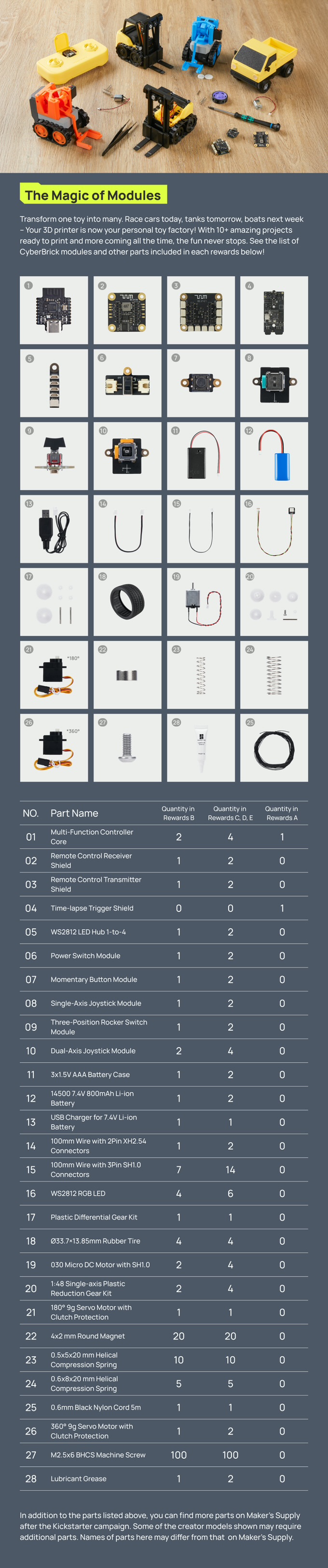

This list shows you will get less than twice of everything. Compare what you received with this and report back.

In the kit you will receive there is a booklet telling you what should be included.

I ordered the"Ultimate Hardware Kit" C and the Time-lapse Kit. I was backer #1164 and it arrived all arrived about an hour ago - despite not getting any tracking info. The list you show and the list in kit are different, items 1, 13, 14 and 15 are not in the kit list and only 2 of 19 are listed in the kit. Also these parts are shown as part of the “Ultimate Hardware kit” on Maker world. I got an unlisted bag of screws 10x M1.5/M2x5 and the Time-lapse kit is missing item 1.
The kit was shipped from within England. As has been mention, you cannot make to vehicles from the kit - advertising one thing and selling/shipping another is illegal in the UK (trades description act) so I don’t know how that works out here.
Item 1 is the core processor and it may be plugged into either of the Shield Boards. The cables might be included with their respective parts (switch, lights, etc).

Maybe check if they are already mounted on the shields (Transmitter and Receiver). This might be done to protect the pins during shipping and help beginners get them mounted in the correct orientation.
What @flummer said was the case for me for both the Ultimate Hardware Kit, as well as the Additional Hardware Kit 1V1R.
