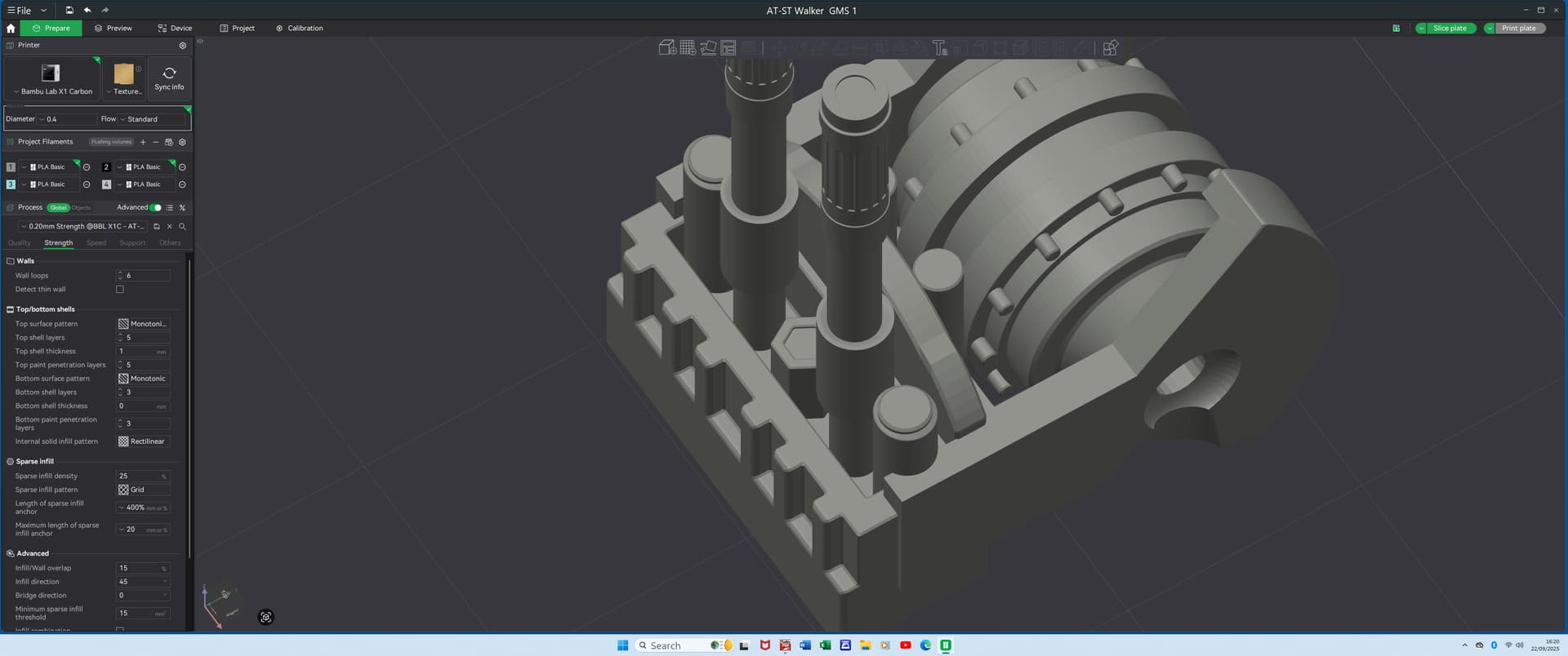

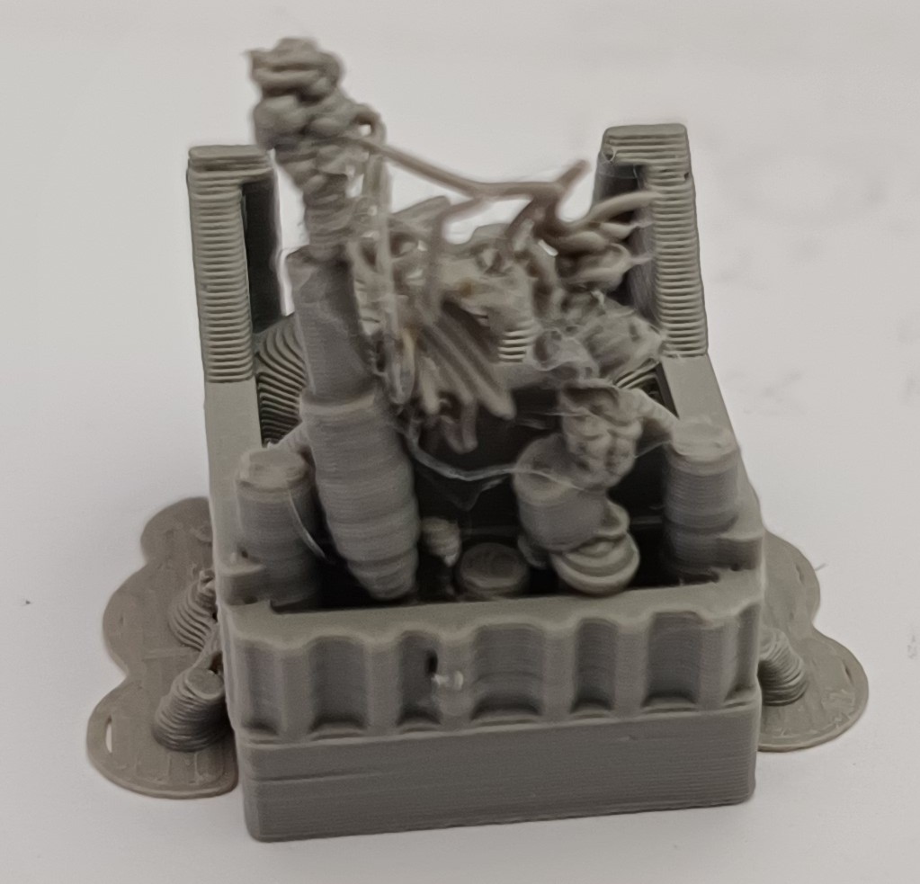

When printing the AT-ST Walker from Gambody the gun-Front did not print well.
This lead me to look at the .stl file which looks on the preview has no problems.

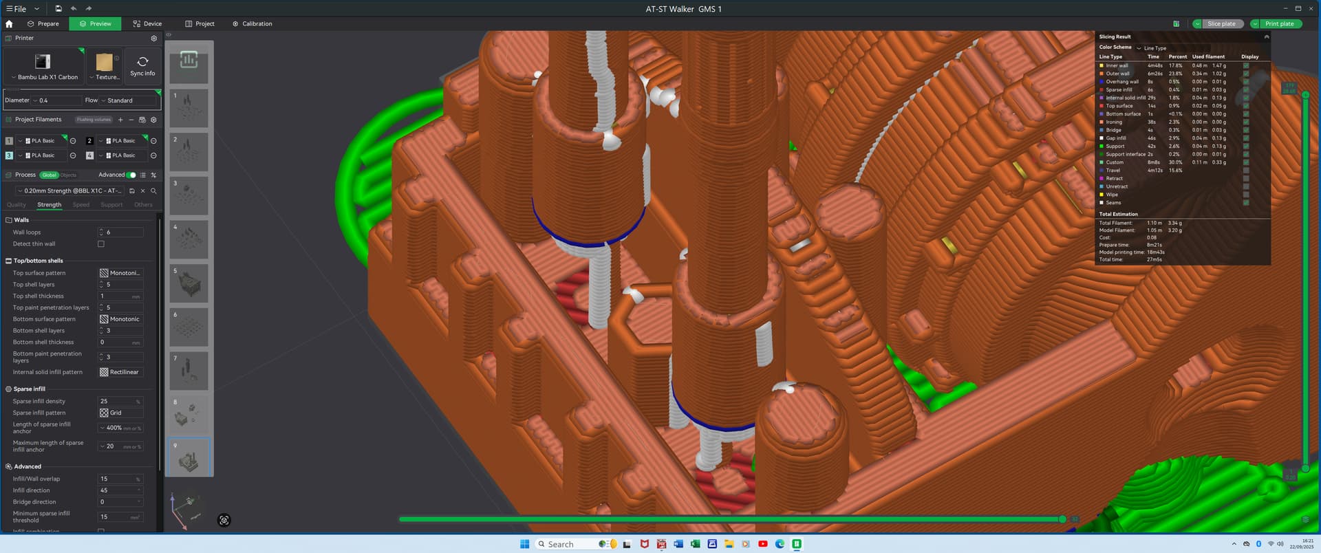

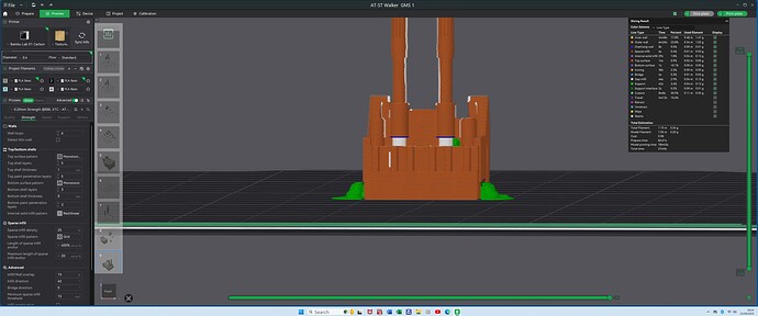

When sliced it shows that the base of the gun’s barrel is missing.
Since it shows a gap fill I take it that the G-Code is missing and that is how far my knowledge goes can anyone help me please?
I am working on an X1 Carbon and Bambu Studio.

  1. Does the stl need repair? Slicer should yell at you about this. Sometimes this is the reason stuff doesnt end up on the plate.

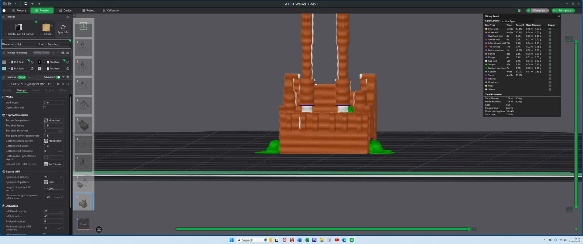

  2. Try WallGenerator → Arachne and dial down the minimum feature size. Does the pipe appear? If so, its present, but just very very thin.
Followed you instructions and as you can see from picture 5 Gun Front Arachne slice the base of the gun barrel is now showing. Will print it tomorrow when the other prints are finished.

Printed at last!
Really satisfied with print.
Thanks very much for the info and path to follow, I would never have found that on my own. Will have to read the WIKI page for the wall converter then get somebody to translate it into ‘Wiki for Dummies’.
