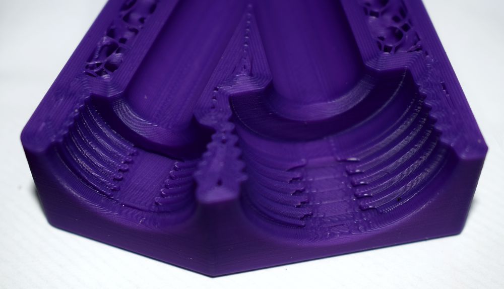

Well, this is different and new. I don’t see what I am doing wrong. I am missing threads at the 6 oclock position (plate side). I did another partial to show the issue better. Any ideas folks?
What does the gcode preview show?
Models with high wall counts an do weird things when sliced.
Maybe it helps to change wall generator to Arachne instead of Classic?
