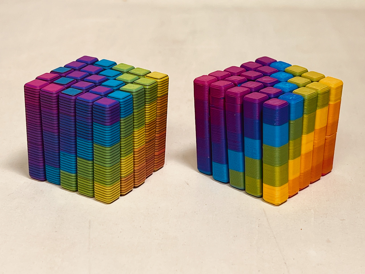

Is anyone using the Mixed Color Sublayer option with mixed color filament colors successfully?
For me, when Mixed Color Sublayer is enabled on a project that contains multiple separate objects, each assigned their own mixed filament slot, the slicer produces gcode with backward Z moves within each layer range. This causes the nozzle to dip back into already-solidified material, which catches on the print and knocks it over.
