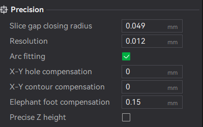

I have a model which has an approx 30mm cylindrical hole, but when it prints the 30mm hole is actually about 33.6mm in size, so it seems to be printing about 10% bigger than it should. I checked the dimensions in TinkerCad and also on the build plate in the design section of Bambu Studio and it looks about 30mm… so I am at a loss why it is printing bigger than the design.

Do you have “X-Y Hole Compensation” enabled?
@RocketSled
I’ve never heard of that - where can I check?
Never seen that before, but doesnt look like its on;

OK, I found the problem and rather than just deleting this cry for help and disappearing back into the woodwork, I am going to just own my mistake :wink:
It turns out that my digital calipers have a problem - you set to zero and then when you open them up they add a few mm to the result… so, when you close them up again it reads 3-5mm instead of zero :frowning :frowning:
So it turns out its a schoolboy error being unable to measure accurately :rofl:
