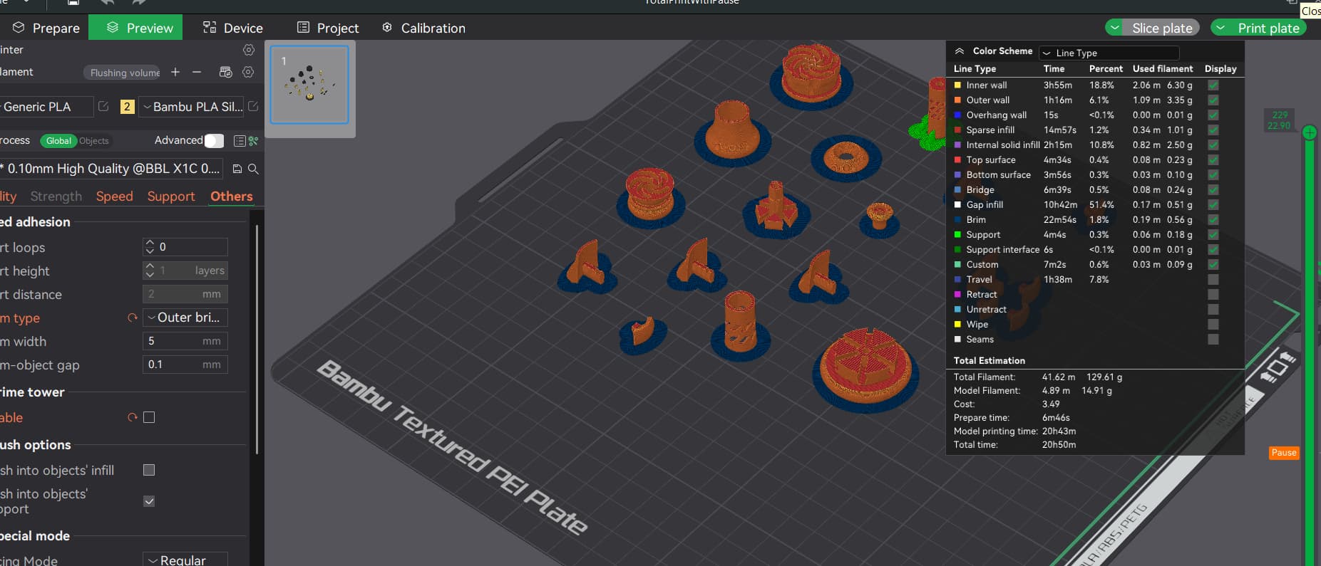

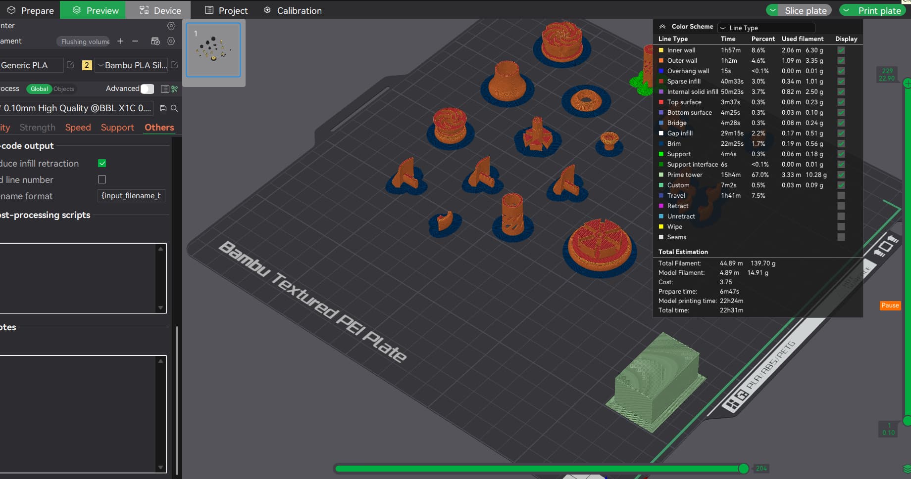

In this screenshot, you can see that the model I am trying to slice says the prime tower will take 16 hours. When the prime tower is removed, apparently the gap infill now takes 10 hours??? This can’t be correct.

Yet in the two screenshots that @BambuBanker shows, it doesn’t look like the estimate is generally off, but there happen really weird things. Printing with or without prime tower should have zero impact on the gap infill. Yet the time spent on it jumps from 30 minutes to 10 hours. That clearly looks like a bug to me.
That’s what I mean. The whole algorithm is a complete Charlie-Foxtrot. Whether it’s off by a few seconds or a few hours, I’ve found that it is only reliable when printing a single filament ±5%
Now i got it. Thanks for the clarification and I fully follow your thought.
