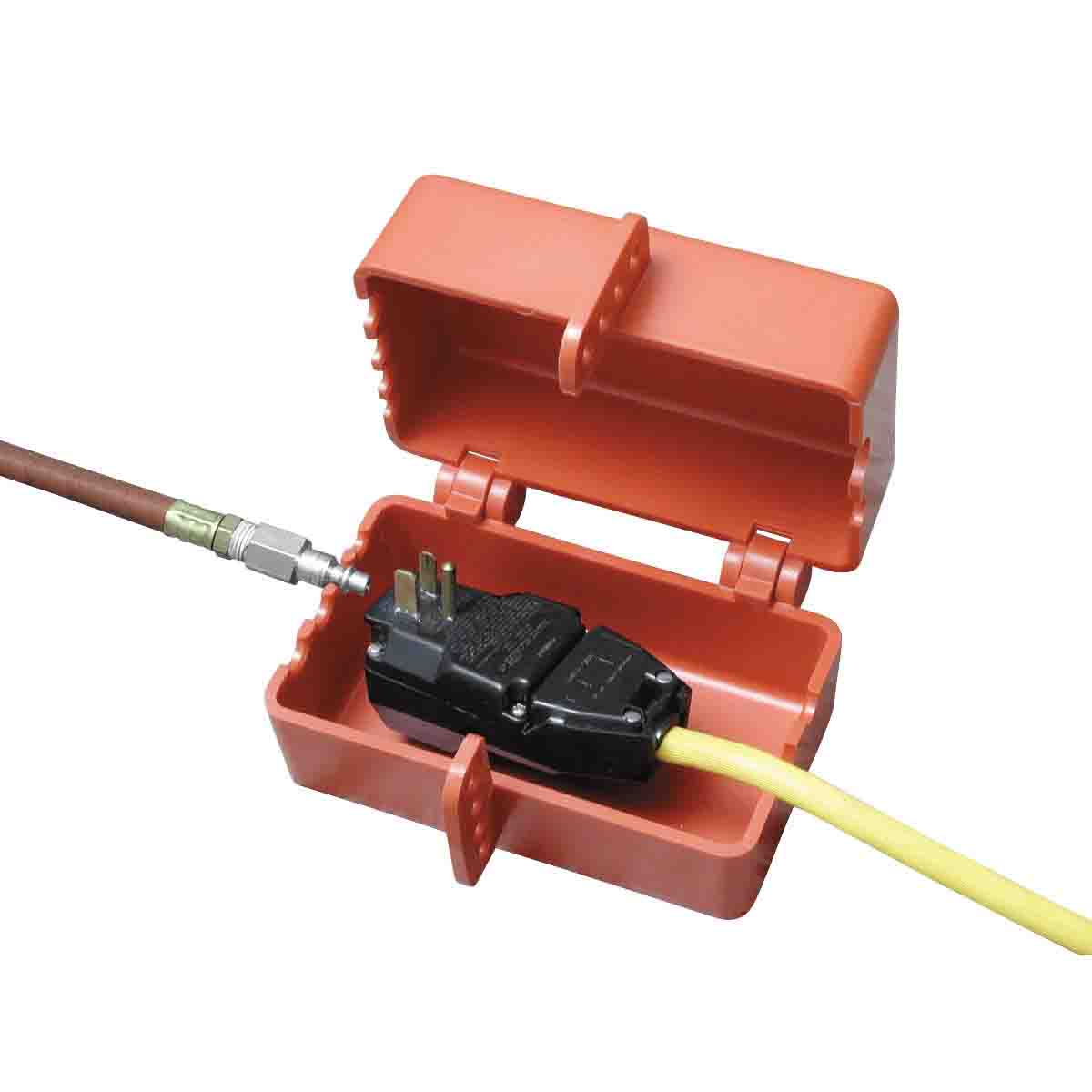

You can lock power out with one of these…
https://www.bradyid.com/lockout-tagout/electrical-plug-lockouts/detachable-power-cord-pid-148081

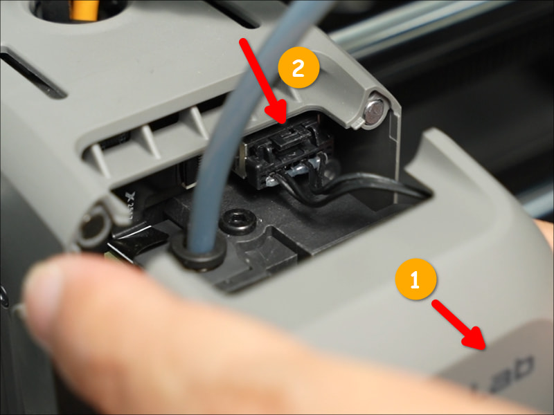

Or take the Toolhead front cover with you. I’m pretty sure the printer will error out and won’t print.

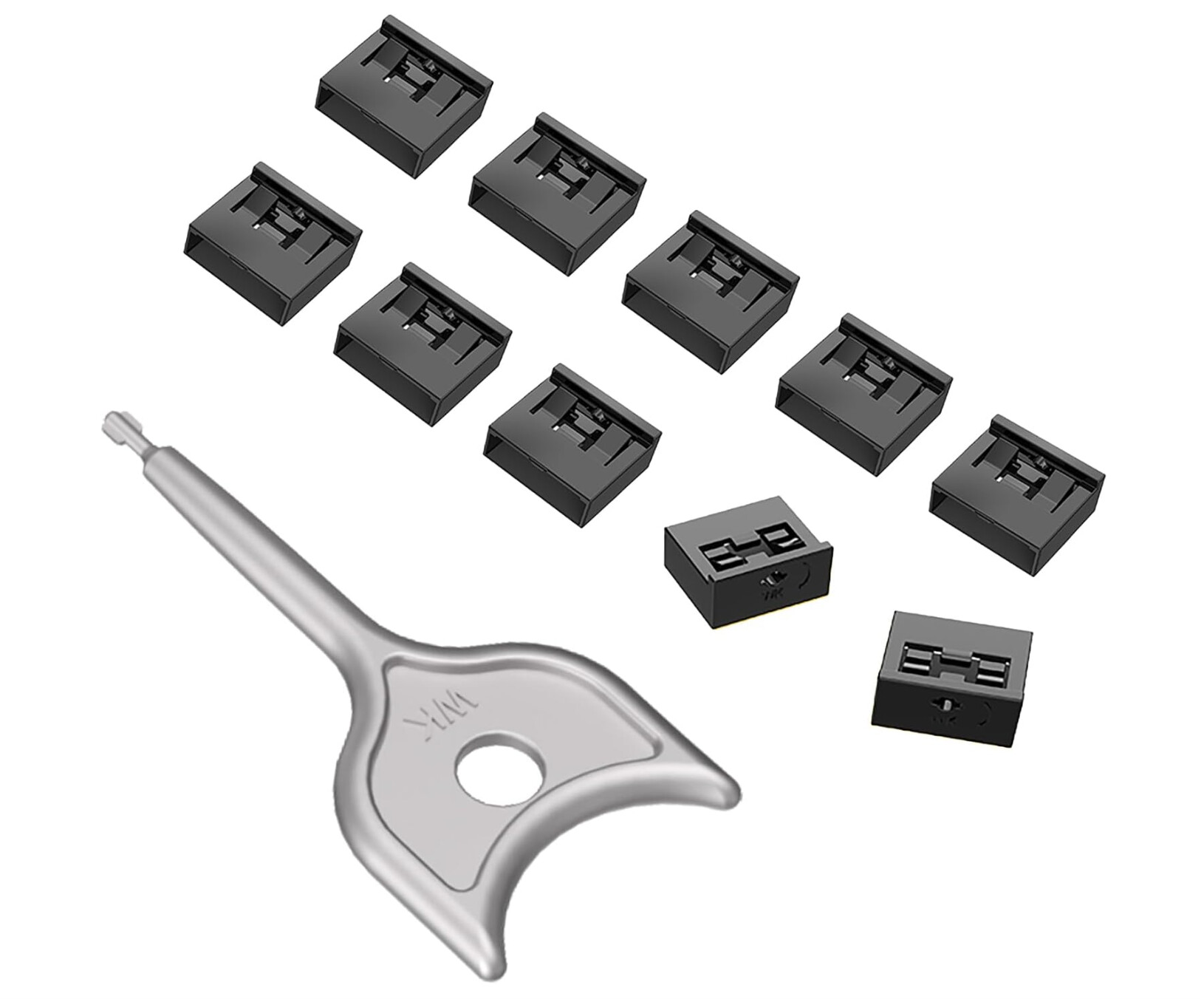

…or if it’s just about the USB port, then just get a USB lock for a few dollars. That said, I think MZip’s suggestion is better. I just wanted to throw that idea in.
This one can easily be removed with a pointy object like the tip of a pen.

Some of u recommended the Power Lock …. sounds good, but I am afraid someone will YANK it out just to plug in the power…. then it may damage my printer….That gadget is still a ‘foreign’ object that is somehow ‘pressured’ into the outlet
Maybe turn the breaker off to that circuit. Should be fine if nothing else is needed on that line. Won’t work if the stealer knowes about the circuit breaker.
It is hard to know from just looking at the picture but what physically/mechanically prevents the Lock-Out device from being removed with the lock in place.
I spent 30 years in an industrial facility and we went from no Lock-Out/Tag-Out system to a pretty comprehensive system that had lots of procedure and what type of locking devices to use.
Here is the thing about most systems like that. There is a high level of sort of what I would call the “Honor System” associated with all of those “Lock, Tag, Try” systems. The worker sees the device in place, mentally goes “Oh, that is locked out” and they move on. That said, someone who is determined to defeat the Lock Tag Try system can generally defeat it if that is their goal. From the picture, that device looks like you can just perform the same “unplugging” act and the device is coming off. Lock and all. Mechanically you need a pin that goes through both the male and female electrical contacts to fix it in place. It looks like it has a small magnet on the one face but I can’t really determine what it is for. Not saying it won’t do, just that I don’t understand how it prevents removal.
There is a huge industry dedicated to lock tag and try and I sometimes think we have tried everything at least once.
We’ve used devices similar to these but YMMV.
