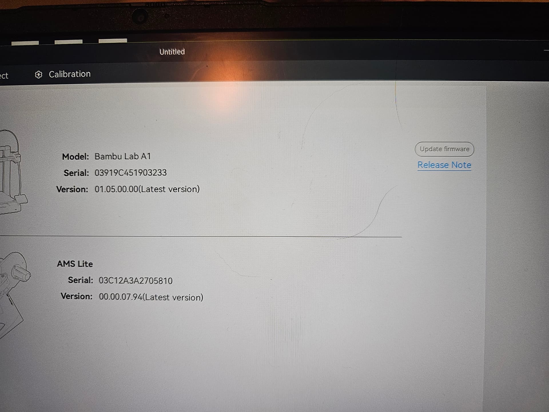

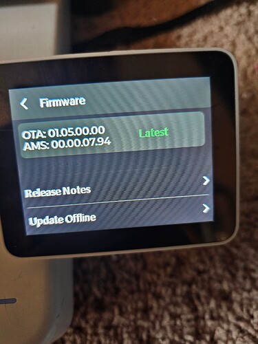

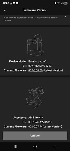

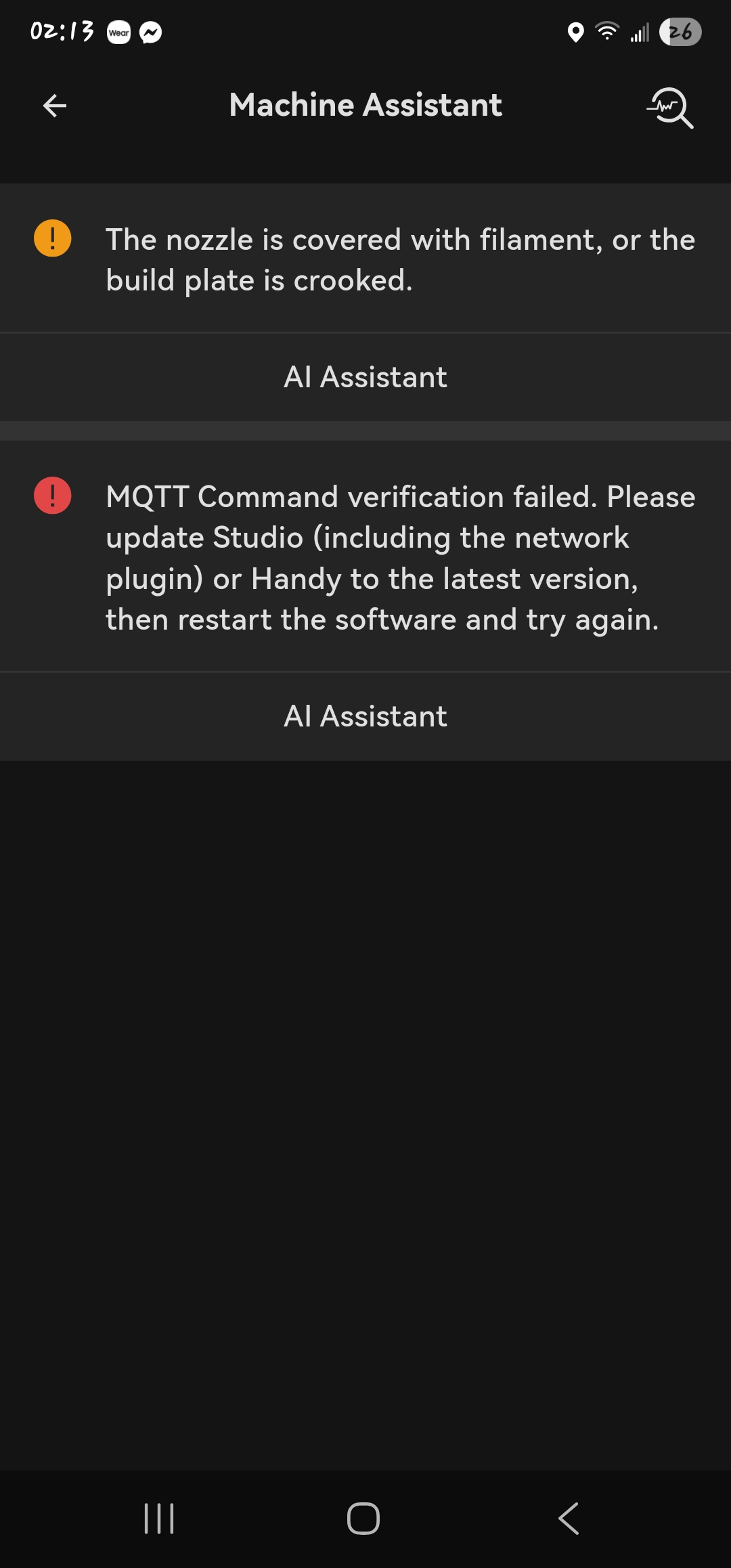

MQTT need to update?

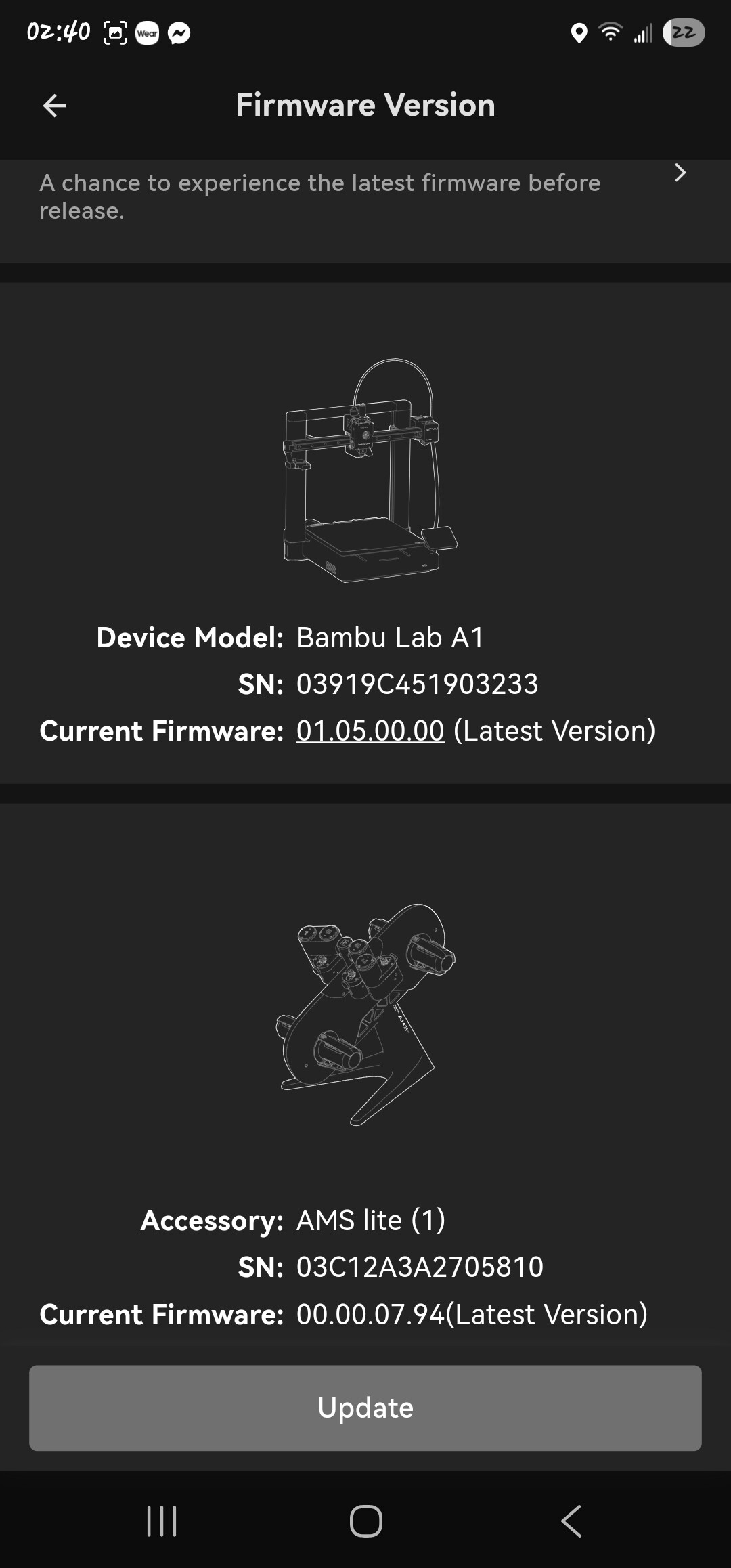

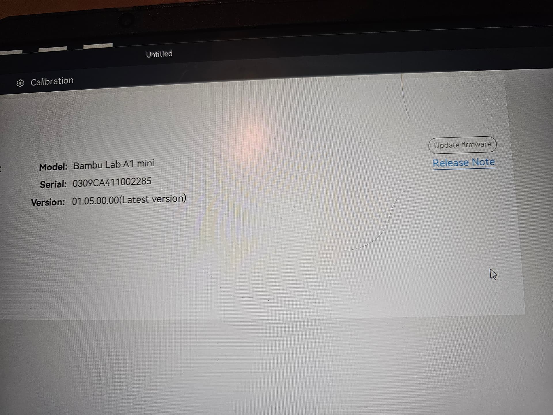

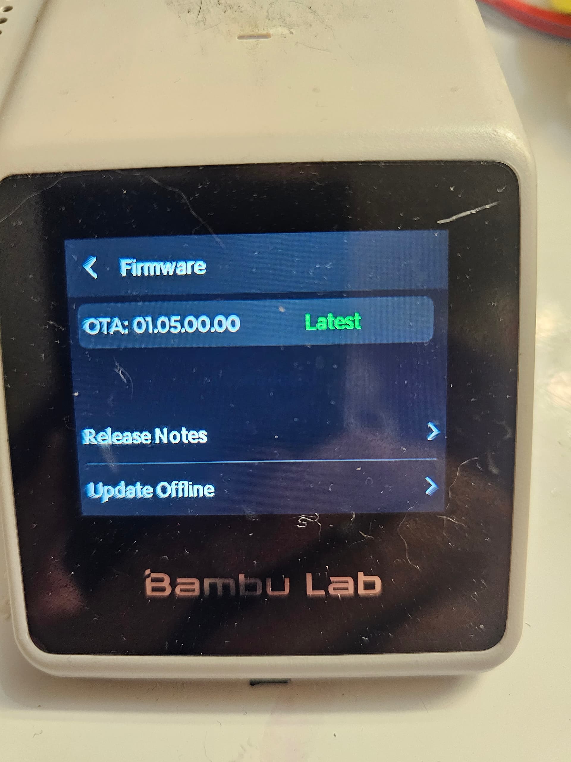

I have no idea how to update because I think everything is updated. I can’t print anything on my A1 or a 1 Mini from either the computer or phone any help would be appreciated

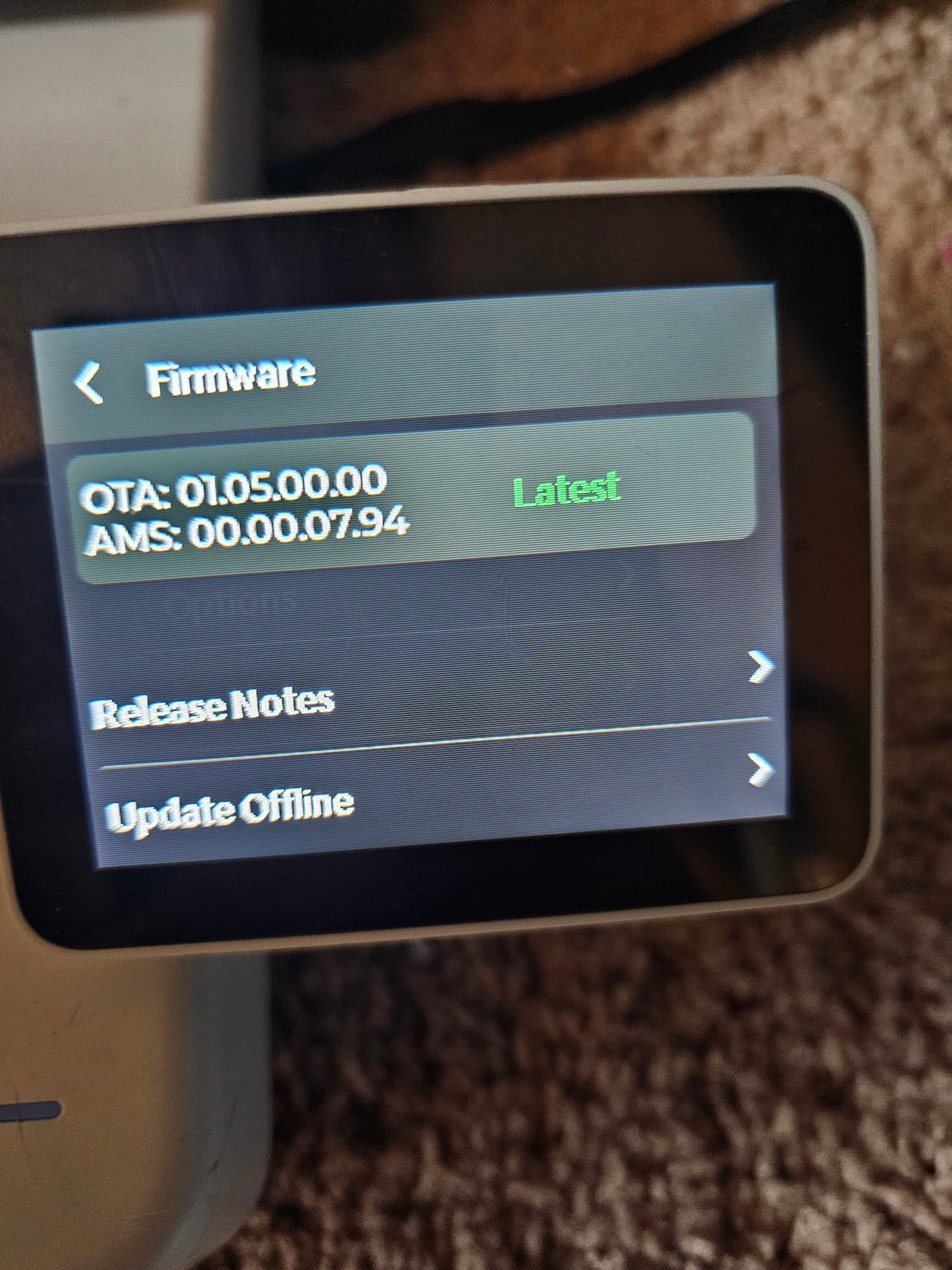

I have the same with my A1’s and P1S since the latest updates. Not always, but sometimes. But mostly after an reboot it good again for a while. so, reboot ?

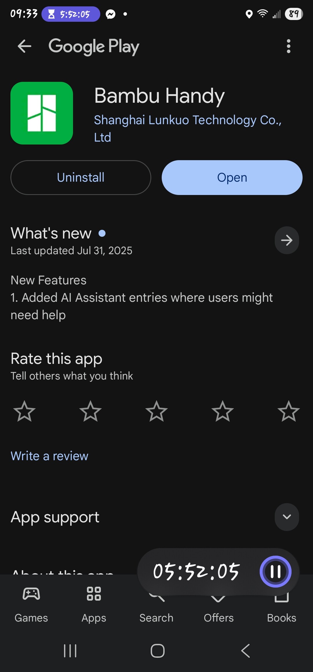

I’m also getting the same. A1 Mini, latest firmware, latest Bambu Handy app from android.

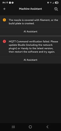

I can usually start a print find, but then can’t monitor progress as it shows this error.
If I force close bambu handy, open it and go to device tab, it’ll show the latest progress but then show error and freeze again
Mine wont let me even upload a print. I can print from the SD but not from my computer or phone
I’ve turned it off and on and did a ■■■■ down and restart on my computer.

I rolled back my firmware and the problem went away. I’d do that until Bambu fixes this.
