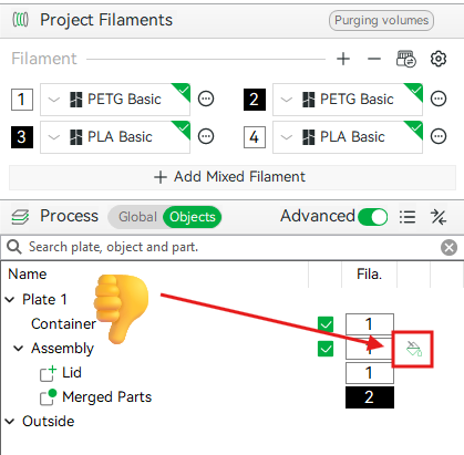

Ok, this was stressing me out. I had just created the exact same merge with a shorter object and it worked 10 times, but time did not. The fix is as follows–and I’m dong this in picture form and highlighting in Red boxes and arrows:
  1. I looked for differences between the working and non working and found in Prepare > Process > “Objects” (not global) a little paint icon. But no paint icon in the working multi color sliced model. I figured out you can’t choose colors both in objects and in the top panel. And the same parts within each assembly have to be same color. If the little paint icons shows in the object panel it means that object already has a color and it must be removed for the object section color choice to work.

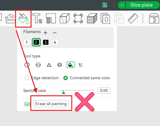

  2. To remove and fix the paint icon: Choose the “Assembly” so you are editing the top level all at once. Choose the color you want which changes the color for the entire assembly. Click the small paint icon next to the assembly color. The top Paint manual painting window opens automatically > click “Erase All painting”. (do all the assemblies one by one to remove all the paint icons so only the assembly colors exist and not the manual paint and their icons that represent they have already been colored).

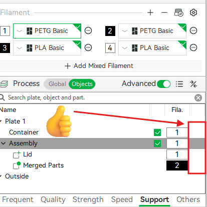

  3. Notice now all the paint icons removed in the Process panel and your object color auto corrects and paints the entire assembly to the color you chose in the assembly in the previous step once you clicked erase all painting:
  4. Done, Slice and Dice and Print baby! Colors show up as normal in slicer and colors actually print too :star_struck: .
