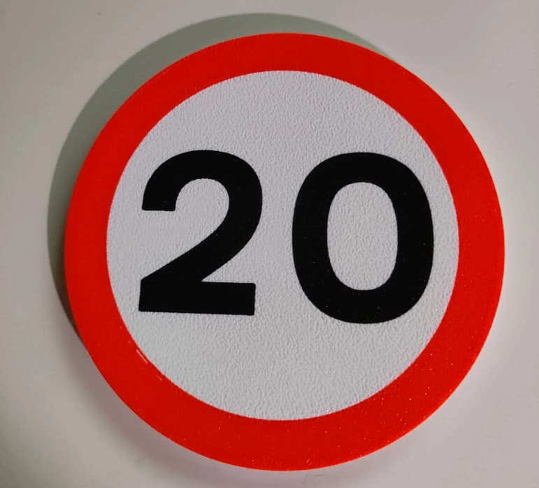

An example of simple multi-color model (3 colors on the first layer).
455915971-435a6253-d006-457c-8e5f-e64e57a1cacc
