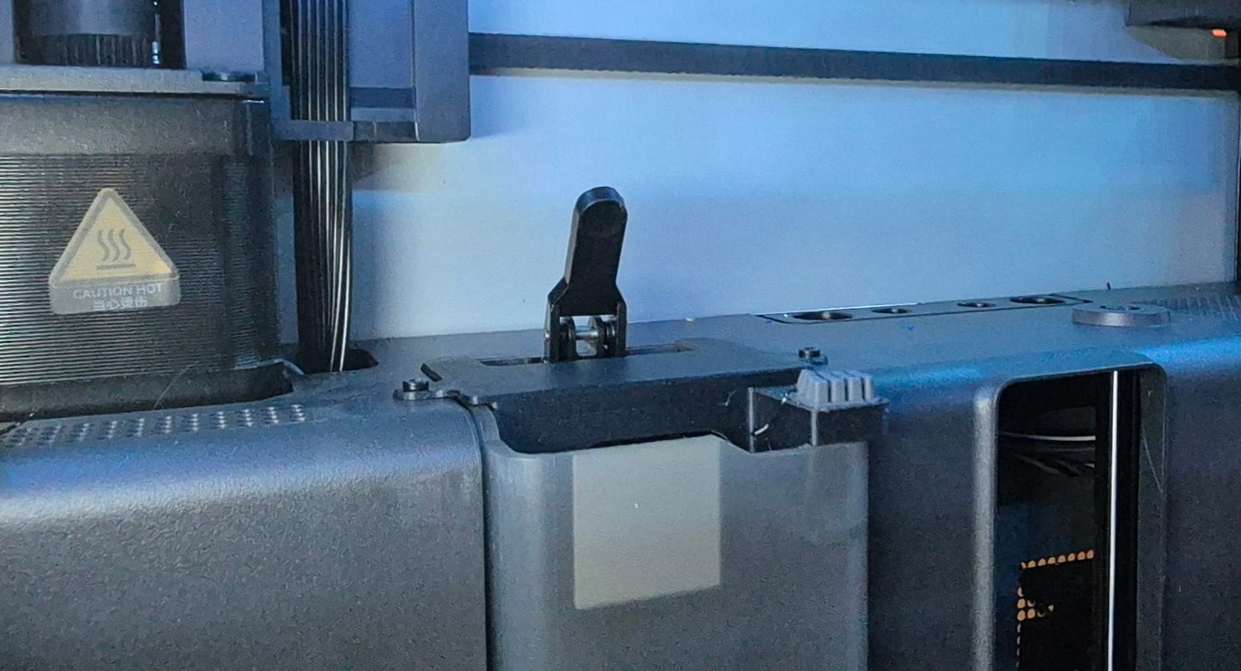

I have owned the X1C with AMS for 5 months and have been very pleased on the whole. I have had a couple of issues which Bambu were very good at helping resolve. Most of my printing is one colour PETG and looks great.
However I have tried to produce multi colour prints on a couple of occasions and never had a good result, which defeats the object of the AMS. So, I was wondering if anyone can help. On nearly every attempt it is a poor first layer which means that the end result is poor. What seems to happen is that the filament is dragged across the bed when it goes to change colour. I have attached a photo of my last attempt as this shows what it looks like. Incidentally I have modified the wiper, as I have read that lots say that the original wiper on the X1C is not up to scratch. I have attached a photo of the modded wiper too - so you can see what I have done… but to be honest this was only done before my last attempt, so isn’t the root problem. I have cleaned everything to within an inch of its life… the only thing I haven’t tried is replacing the hot end which is why I thought I would ask on here to see if anyone thinks this could be the problem?
Also attached is a close up of one finished two-colour print and you can see the poor finish of the first layer.
As an idea of usage… I would estimate I have used about 5 x 1kg rolls of filament. I am using Bambu branded PETG HF as I thought using generic filament may have been the problem. I also had similar issues when I use PETG support (very expensive… but also Bambu supplied) - which of course is also in essence a two-colour print.
Anyway, any help will be gratefully received.

You haven’t mentioned how you are drying your PETG?
Poor bed adhesion can be finger oils or other oils on the build plate, improper temperatures, etc. Wash the plate with warm water and plain dish soap, handle by the edges, thoroughly dry.
Another thing that can cause bed adhesion issues is filament moisture. Filament moisture can also lead to stringing issues but so can filament retraction.
On the stringing in the print, for most prints it’s better to print light colors first and go progressively darker on the first layer. You can set color orders in Studio in the options button for each build plate. Basically the lighter colors are a barrier to the darker stringing that can come later. They can still string but the issue is less noticeable.

Doubling down on what Jon said - drying is important with PETG HF as well as other especially hygroscopic filaments.
PETG HF likes to lift corners off the build plate if it has high moisture. Surfaces can look doughy too with little defects all over.
Here’s before and after drying of PETG HF prints of the same print file. Nothing changed but drying the filament and you can see corner lifting and the surface defects vs the prints made with well-dried filament. The second print has beautifully flat sides with no dough or surface defects like in the first photo.

You can dry filament with your printer bed. It’s not the optimal solution but it will dry filament.
When drying, there are a few things that may help. If you have a scale with enough capacity and resolution you may want to weigh spools before and after as you get used to drying filament. Around 2kg capacity and 0.1 or 0.01g resolution is needed to see the changes well which tend to be around 2-4g.
But weight alone doesn’t tell the full tale. Keep an eye on humidity in the filament dryer. There are clips on MakerWorld that prop filament dryers open a little so the humidity can get out and they help a lot. If you have high ambient humidity, just know standard filament dryers may not be especially effective. Same for build plate drying.
The way I’m instrumented and drying, hitting 24% relative humidity in the filament dryer with PETG HF isn’t quite low enough for good prints with some colors. They seem happier if I hit 20%.
Getting drying sorted is really important for good prints with low defects.
I don’t know it’s what is happening, but with single color prints, there is no pause while filament gets changed. The top surface of the model can cool while filament changes, and the anecdotes here are some colors print better than others. Printing single color is a bit more uniform just from being single color. I think multicolor printing is more demanding for those reasons.
About drying filament in an oven, be very careful. Ovens don’t all have good temperature regulation and with powerful heating can overshoot. If you heat filament too much it can apparently become brittle. Also, some filaments are more noxious than others. You probably don’t want those fumes redepositing in your oven to come back off when baking. And last, gas stoves produce moisture as a byproduct of combustion and raise humidity in the oven. Bakers love it but it slows and stops drying prematurely.
