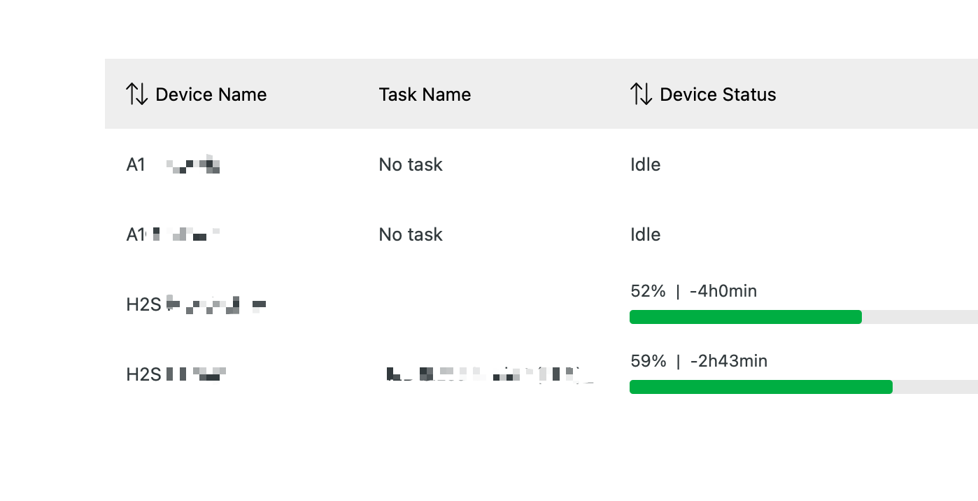

The H2S is listed, and has been since day 1. But my H2D? nah
Really can’t think of a reason for, there’s literally nothing dual-nozzle-y involved for just fetching what’s already available in livestream tab.
