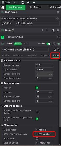

Hi All,
I had my workflow down while using Simplify3D and now I’m lost trying to do the same things in Bambu Studio. What I’m missing most right now – and not because of convenience but necessity – is being able to print several parts in sequence. I want to be able to print an entire model before moving on to print another one. Not only does this save time, it also cuts the time needed to cleanup strings between parts. By printing an entire model before moving onto the next one, I would only have to cleanup one string between models instead of a string between each model for every layer. I thought plates might be some way of creating multiple processes but I was mistaken. If this isn’t possible, does anyone have any workarounds? Any help would be greatly appreciated.
Got it! Thanks. I consider this question answered. I know the following should probably be it’s own thread but hear me out. Although this is absolutely the answer to my question, I tried it and although it works the way it should, there are things about it that just don’t work the way I need them to. For example, if you print several objects into which you want to insert, let’s say a captive nut, you would insert a pause at a certain height. The problem is the pause is per object. You can’t make it print all objects and pause once for you to insert all the nuts. It will pause at each object and you have to be ready to insert the nut at each pause. This means you would have to babysit your print. Not a very efficient way of doing things.
