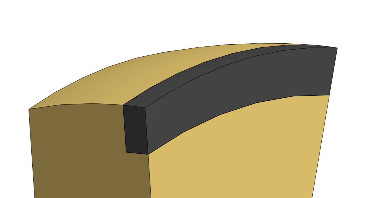

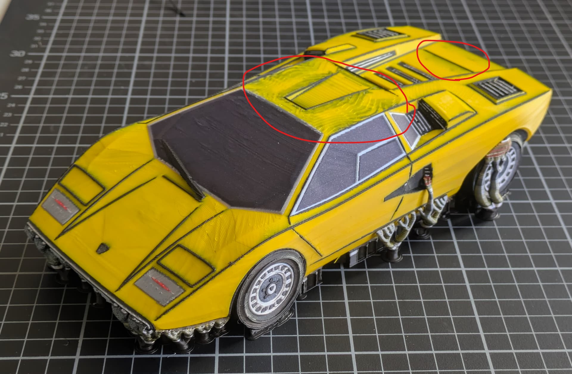

I regularly print multi-color models with numerous colors on each layer.
However, on horizontal surfaces with slight curvature in both directions, I’m seeing significant color bleeding because of how the slicer distributes colors:

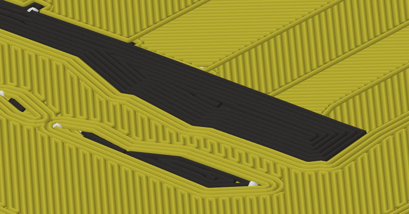

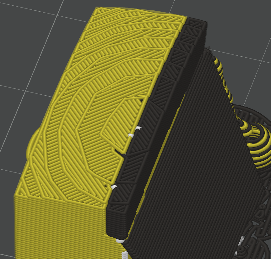

This is how it looks with with the example of the sphere section (I already added a support structure for the next step):

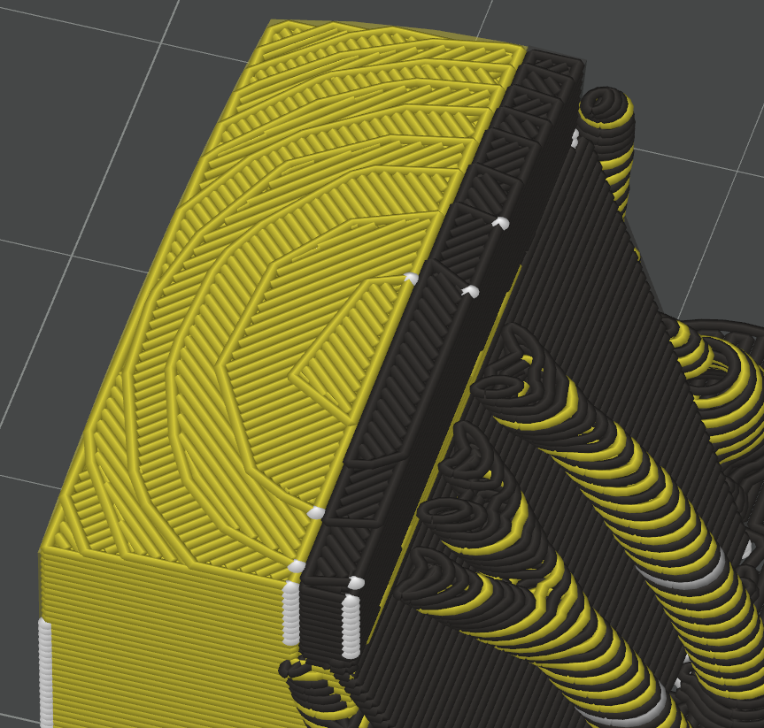

And here is how it look like after separating to objects which is normally not an option for me but it shows how I expect the slicer to distribute the colors:
So the issue is fairly simple but not easy to fix.

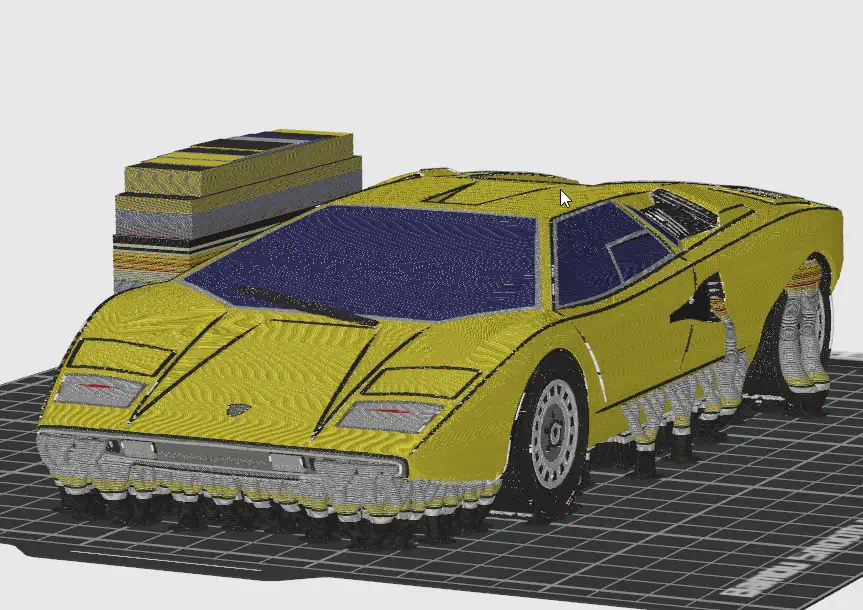

Changing the layer height does not help at all. In the slicer it looks a bit like it since you have more layers of the dark material, but since these are also thinner, the result is pretty much the same.
Here is the same with 0.08mm layer height:
FYI: the photo of the car shows 0.08mm layer heights, the other images/animations of my first post show 0.2mm

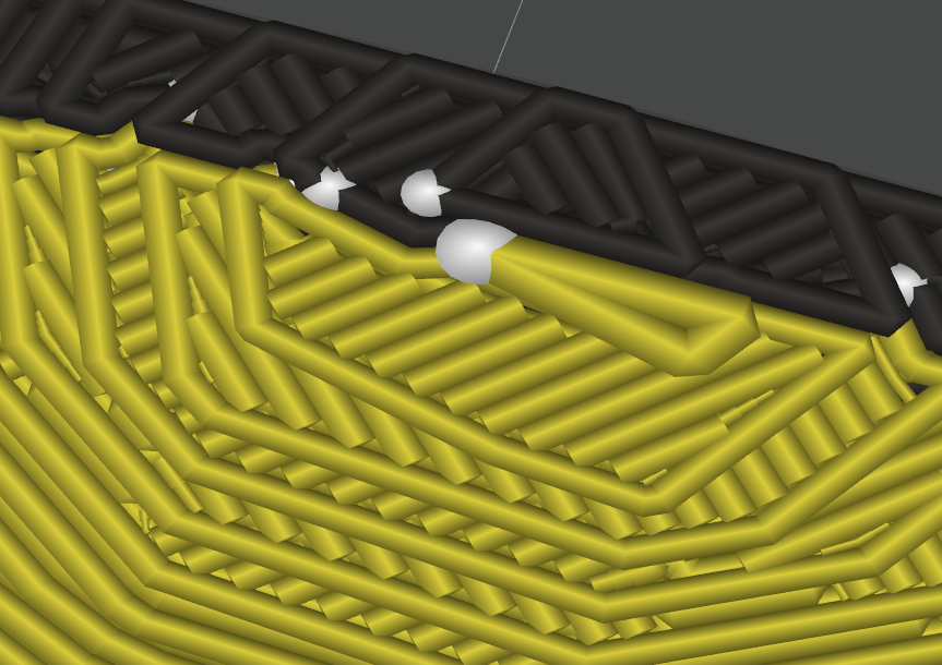

if you put it through the slicer you will see how multi colours bind themselves to a print / model so the are not seperated , on models that have very few layers at 0.2 you will see an opaque effect until it builds up layers
your model is built up with black (dark) and yellow which is very light
the roof of your model appears to be built up of very few layers on top of the dark colour hence it will show

In general, my second post shows clearly that this is in principle a solvable issue. However I’d have to split the object into one object per material and make sure that the slicer does not move every split object onto the ground. How can I do this if there’s no other solution?

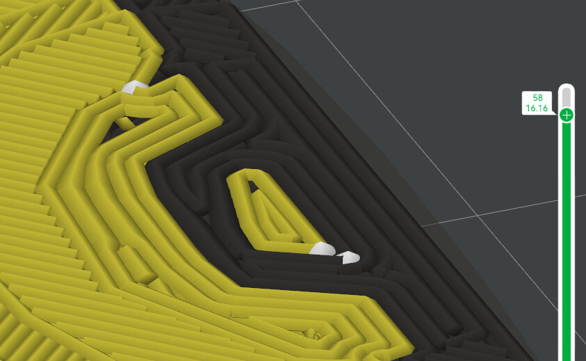

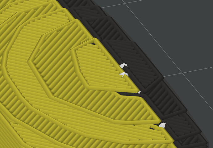

Here you can see a bit more in detail the actual print: The top layer is yellow but almost everywhere on the roof the second layer is black (0.08mm)

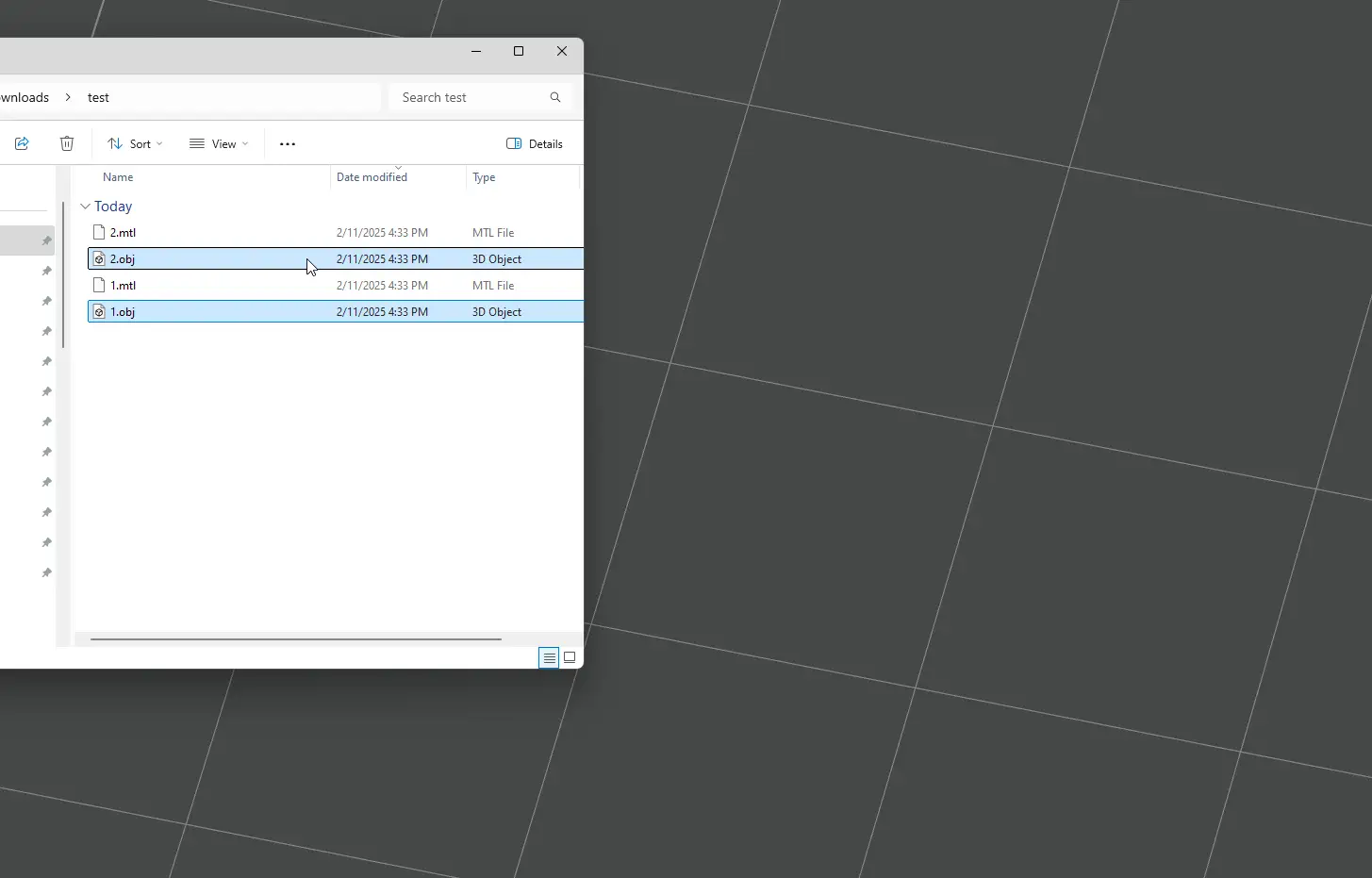

When importing just select all the objects in your file explorer (for a 4 color model that should then be 4 models).
When you drag them into bambu studio it will prompt something like “do you want to import these objects as a single grouped object” selecting yes will group these with the correct location that you had in your design software so everything is lined up and grouped so nothing will be moved. Even when using the auto arrange feature.
