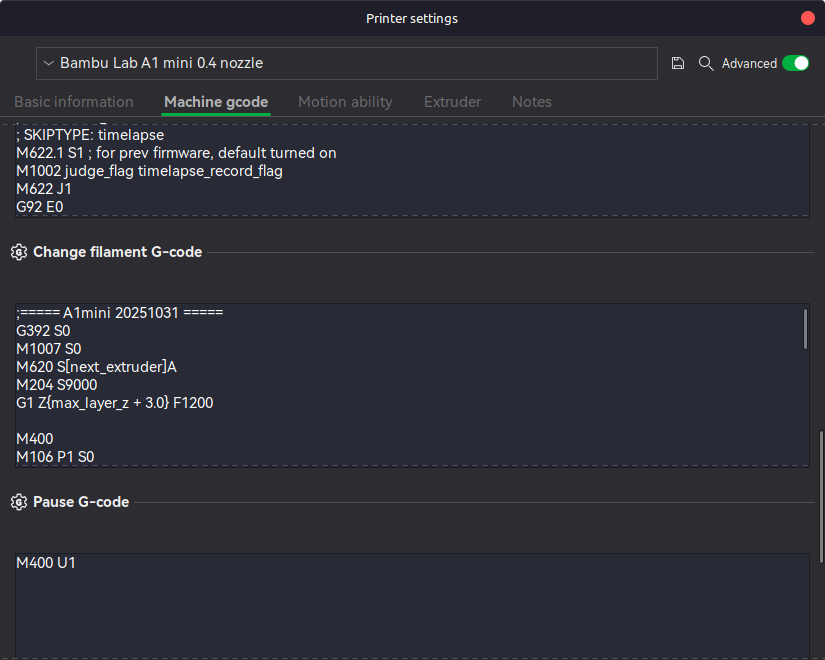

  1. In Bambu Studio, on the selected printer click the edit icon to bring up the “Printer settings” dialog.
  2. Go to the “Machine gcode” tab.
  3. Scroll down to find “Pause G-code”, which is probably just M400 U1. Select everything in that box and copy it. Now scroll up to “Change filament G-code”. Clear everything in that box and paste in the code you copied for pause.
  4. Click the Save icon and you’ll be prompted to save a new profile. Save it as a user preset and give it a name you’ll recognize like “Printer name 0.4 nozzle - No AMS”.

First of all step 3, I´ve searched and couldn’t find the “Pause G-code” or “Change filament G-code”.
I’ve got an A1
@CVeigas
There are multiple scroll bars due to the different sections - if you use right-hand most scroll bar and move it all the way to the bottom you should see those sections
