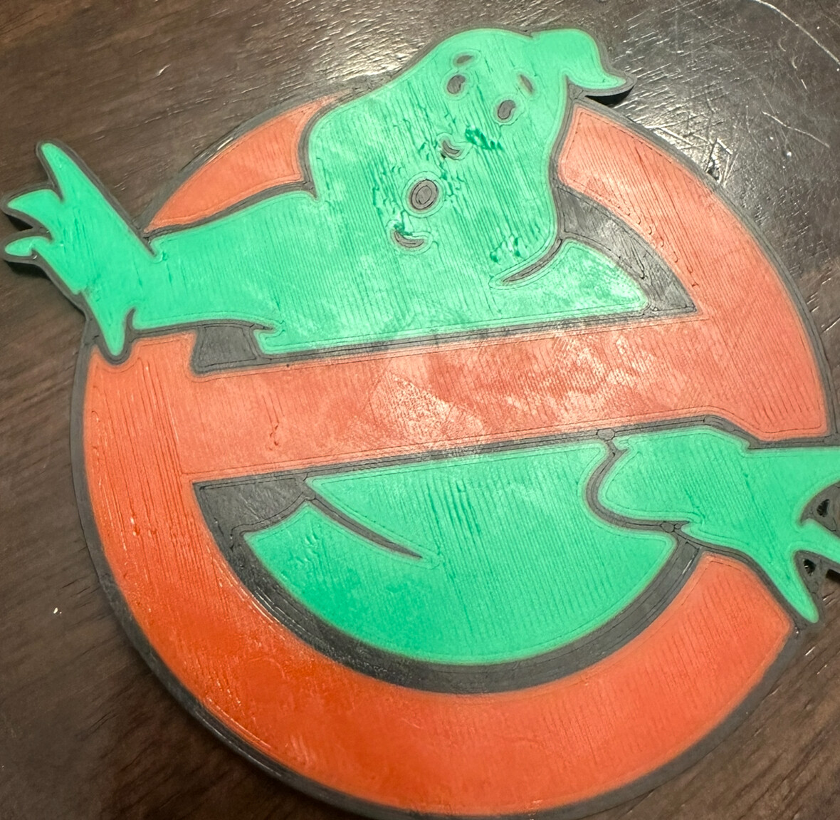

MultiColored Prints only Printing in One Color
You can’t update because the printer is busy, as it says in the image you posted. Make sure it is connected to the internet because that is a pretty old version.
I updated yesterday, then it told me I had the latest version. I guess I should have checked version numbers for the latest
After this print I will try again.

I’m curious why it would tell them it’s up to date after updating to an old version?
Don’t forget to power cycle after a firmware update and run calibration again before getting going.

So I am making progress after a factory reset, I have been able to update the firmware. However, because it was so out of date I’ve had to update multiple times and I am still not up to the current version.
You have to keep updating it until you hit the last one as per the wiki i posted. better be safe than sorry.
But since this topic is marked as solved, guess that’s it.
Good luck :wink:
It was just the firmware not updating. I factory reset and then updated. 3 test prints all successful.
