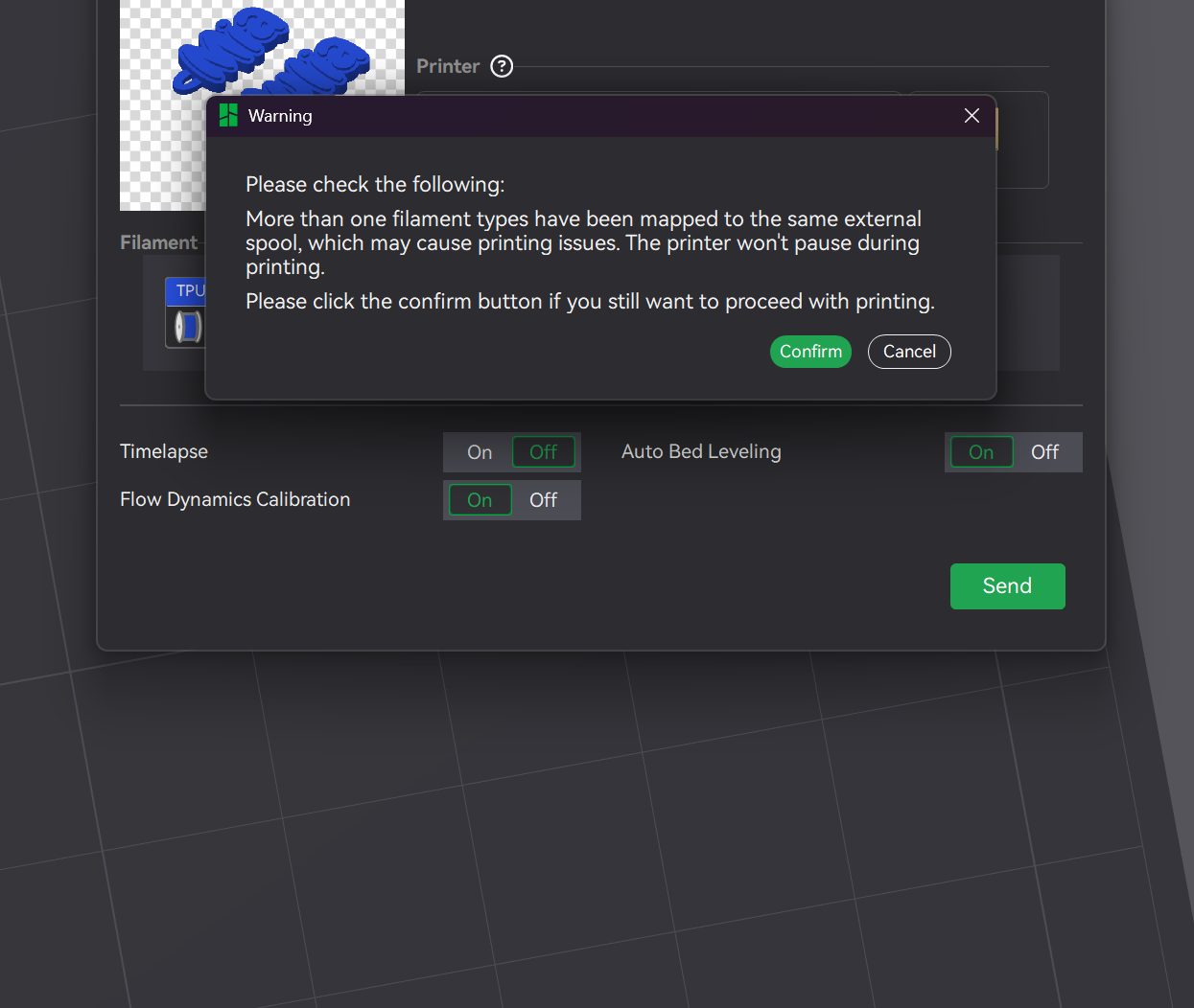

Sadly doesnt work for me. When trying to send the job to printer, bb studio warns me that it won’t pause mid print as ,multiple filaments are set to the “same external spool slot” :((
Trying to combine TPU for AMS with TPU 95A HF
