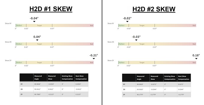

The parts we’re printing are roughly 295mm x 275mm x 275mm. Its important for us to get fairly straight square walls but we are seeing some skew on our first test prints. We ran the V3D Calilantern Mk2 calibration print at the 200mm size and found the same skew results we were seeing in our test prints.
Here are the results:
The ZY (front to back) seems far off for the height we are trying to print resulting in the top of the part being about 1mm off in the Y direction when compared to the base on printer #1. This was checked with the part base sitting flat on a precision surface using a machinist square up against the wall.

Are you seeing the YZ skew on the top surface, bottom surface, or both? If you see it only on the bottom with a square top, then yes do bed tramming, if you see it on the top or top and bottom, then the issue is related to the alignment of the printhead y axis and lead screws. This will be nearly impossible to fix.

I cant upload the image, but the best so far has been -0.19 in ZX and +0.16 in ZY on the same machine.

I’m pretty sure the skew values he’s referring to are in degrees not mm like the results I posted. So the part will increasingly be dimensionally inaccurate the taller the print is. Such as what i’ve seen in my example mentioned with a ZY skew of 0.21° resulting in a 1mm shift at the top of a 275mm tall print.
