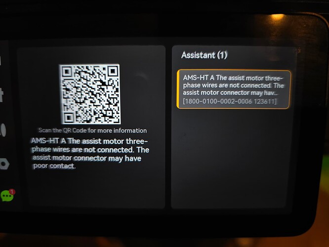

Ok so first off, its been month since i turned on my m2d, i didn’t have any time to print and was tired trying to figure out why somehow my print are now horrible.
But…because why not, it seem my AMS-HT motherboard died on its own and without having it on.
That doesnt inspire confidence for a 2700 euros machine.
It just refuse to spin the motor inside,
feeding it doesn’t do anything, trying to make it work via the h2d doesnt do anything, turning it on and off doesnt do anything.
This is the qr code link
Did this happened to anyone else ?
An no the unit is on my h2d, never fell, didn’t get shaked or anything, it actually being collecting dust and that about it
Of course the screen work

The qr code give a link saying i have to open it up to check any disconection between the motherboard and cable, but i am sure this won’t do anything, i was working fine before and it just stopped, so i would think the mb go fried for unknow reasons, but why ? I live in paris, all the circuit of my appartement are new from 2013, and we don’t get power surge, it would be a first for me to have something that fry while being OFF.
The message mentions a possible disconnected Connector of the drive motor. It might be worth To look at the connectors inside. The wiki might help. AMS HT Disassembly and Assembly Guide | Bambu Lab Wiki

If the issue persists after reconnecting the cable, it may be due to a damaged cable. Replace the cable connecting the motor and the mainboard.
  1. If the problem remains unresolved after replacing the cable, the motor itself may be faulty, possibly due to damaged coils. Replace the motor.
  2. If the issue continues after replacing the motor, it may be caused by a faulty AMS HT mainboard, which will need to be replaced.
If your AMS 2 Pro is still under warranty, please contact our after-sales support team for further assistance after attempting the above troubleshooting steps.
sure i got a spare motor and an extra motherboard just in case my new 3d printer break, anyone got one of those just in case, what is next ? replace the whole assembly of the printer, if it doesn’t work call the factory in china for help, then and only then contact the after-sales support team.
anyway, open it up, didn’t see anything, all cable are connected, no burned cable and still got that message when i power it on
so no solution ,every cable is perfectly connected, the only out of this that i know is that 3 month off and the AMS-HT can die

I had the door sensor unplug on my H2D out of nowhere. Sometimes things dont get “locked” and heat/cool cycles will back the out. It clearly happened after a high temp print the night before.
I wouldn’t write it off as fried, it could very well have not locked or backed out.

i opened it up, check all the connection inside, even the cog and everything seem fine, so the issue might be the feeder motor because it doesn’t start even when i feed it or something else got broken/fried for not being used, that being said you can see the picture i took of the cog and see the design of it, it look like its compress by design, so i hope its not the same thing in the motor.
