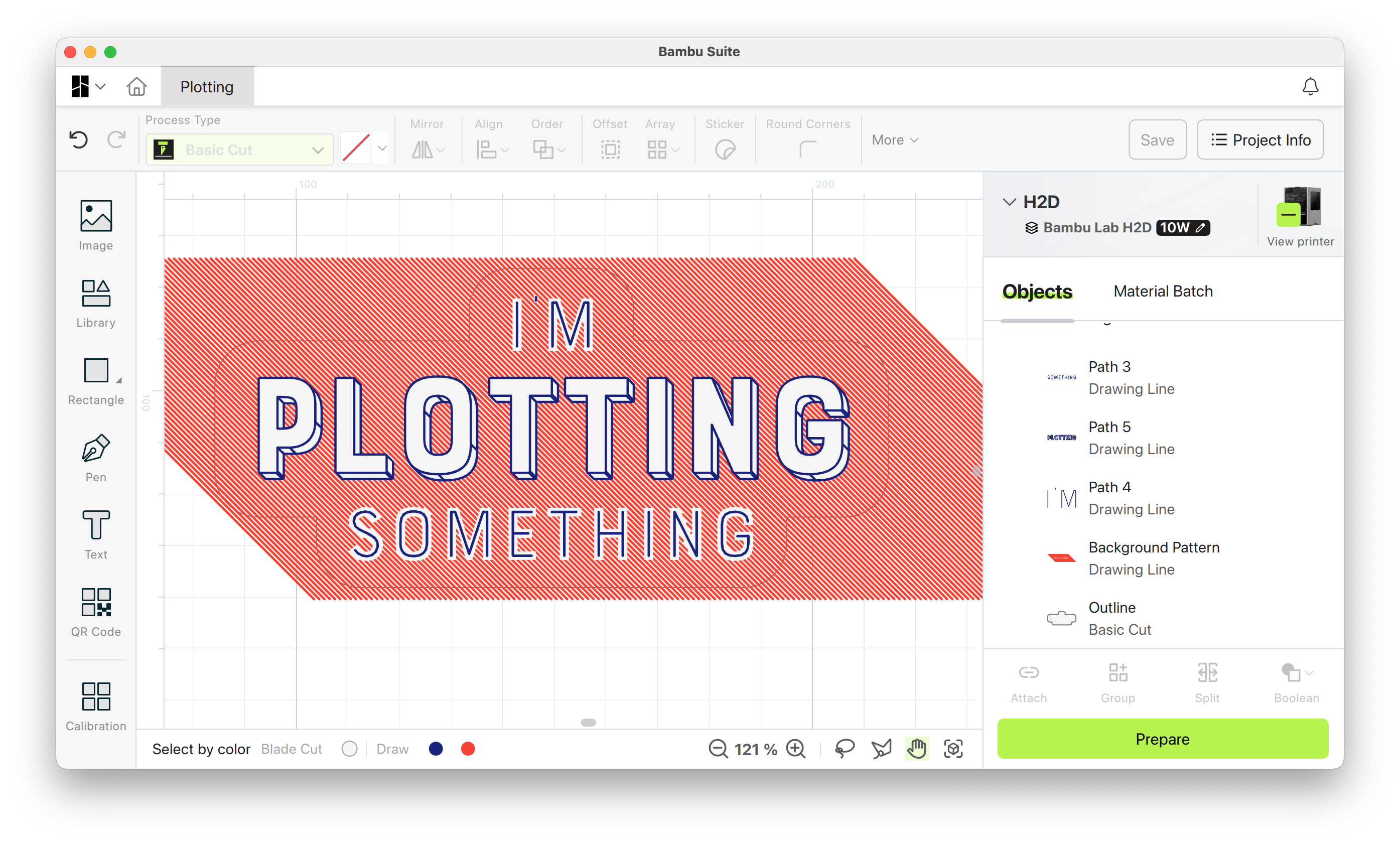

To test the workflow, I wanted to create a file with multiple tool changes:
  • As with the previous examples, I created my design in Affinity and then exported an SVG to import into Bambu Suite.
  • Then, I could assign an operation to each path or group of paths: draw line, draw fill or cut. Additionally, I could assign a color for the drawing portions.
  • You can preview the operation just like in Bambu Studio but the preview doesn’t seem to have an indication of tool changes. You can tell where a tool change will be because the you can see the toolhead home in the preview.

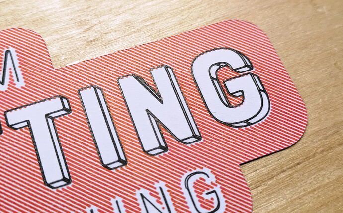

  • The process was kind of mesmerizing to watch - I used Pigma Micron pens which were a little low on ink - this led to a few lighter areas.
    Plotting
The process pauses automatically when there’s a tool change - including when there’s a change in ink color.
  • You will notice that the black ink in my example is slightly offset - this wasn’t intentional (look at the very bottom of the L). I may need to experiment with the pen changing process to prevent this.

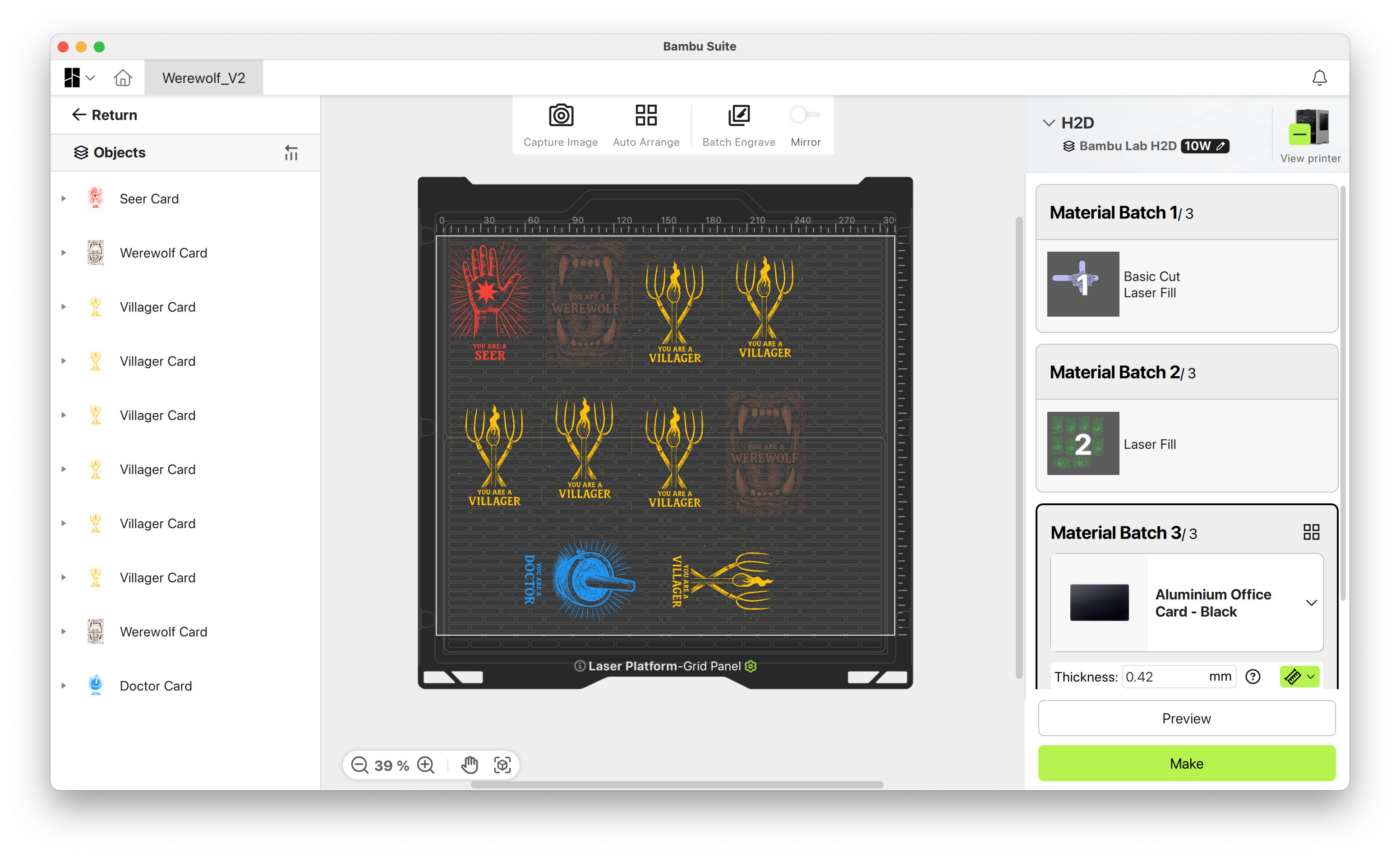

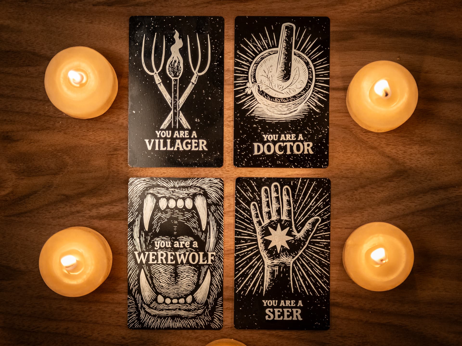

A few quick updates that I’ll share here instead of posting a new topic. I worked on another small project to keep learning both the cutting and laser modules. Here’s the posted project for reference and here’s what I found:

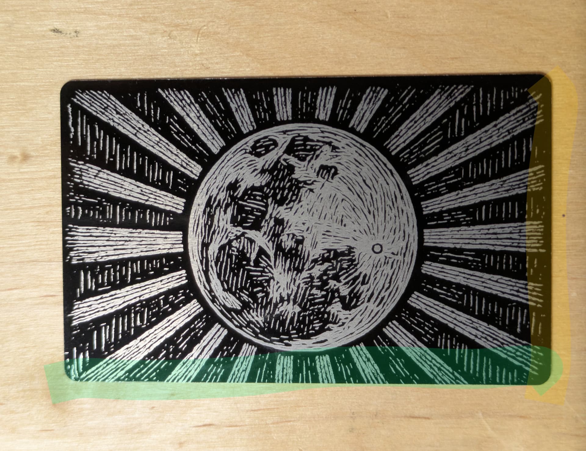

The Black Aluminum cards had a great finish - very high contrast and a nice, shiny surface.
Alignment in Bambu Suite proved to be a challenge for the aluminum cards - this may be due to the fact that they are black and blend in with the laser platform. I temporarily placed a sheet of paper under then to improve contrast for alignment and then removed the paper before processing. Here you can see a card that appeared centered in Bambu Suite before processing - I ended up solving this by having the image slightly bleed over the edge.

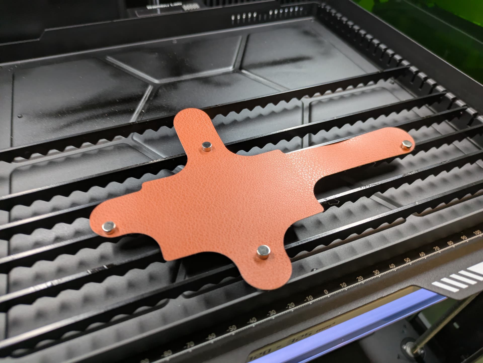

The brown leatherette cut flawlessly. I was also able to etch the surface using the laser and the color difference was subtle but I thought it looked quite nice:
I’m hoping that the laser grid is release soon because I think it’ll be a big help with holding materials in place. In this case, I used some magnets to hold the leatherette steady while being processed by the laser:
In Bambu Suite, I haven’t been able to figure out a way to rearrange material batches. For that reason, I’d recommend planning your batches and adding them in an order that requires minimal tool changes. For this project, I only used the cutting module once and the rest was laser - I needed to re-add the batches so that the cutting could be first and all laser processing second.
