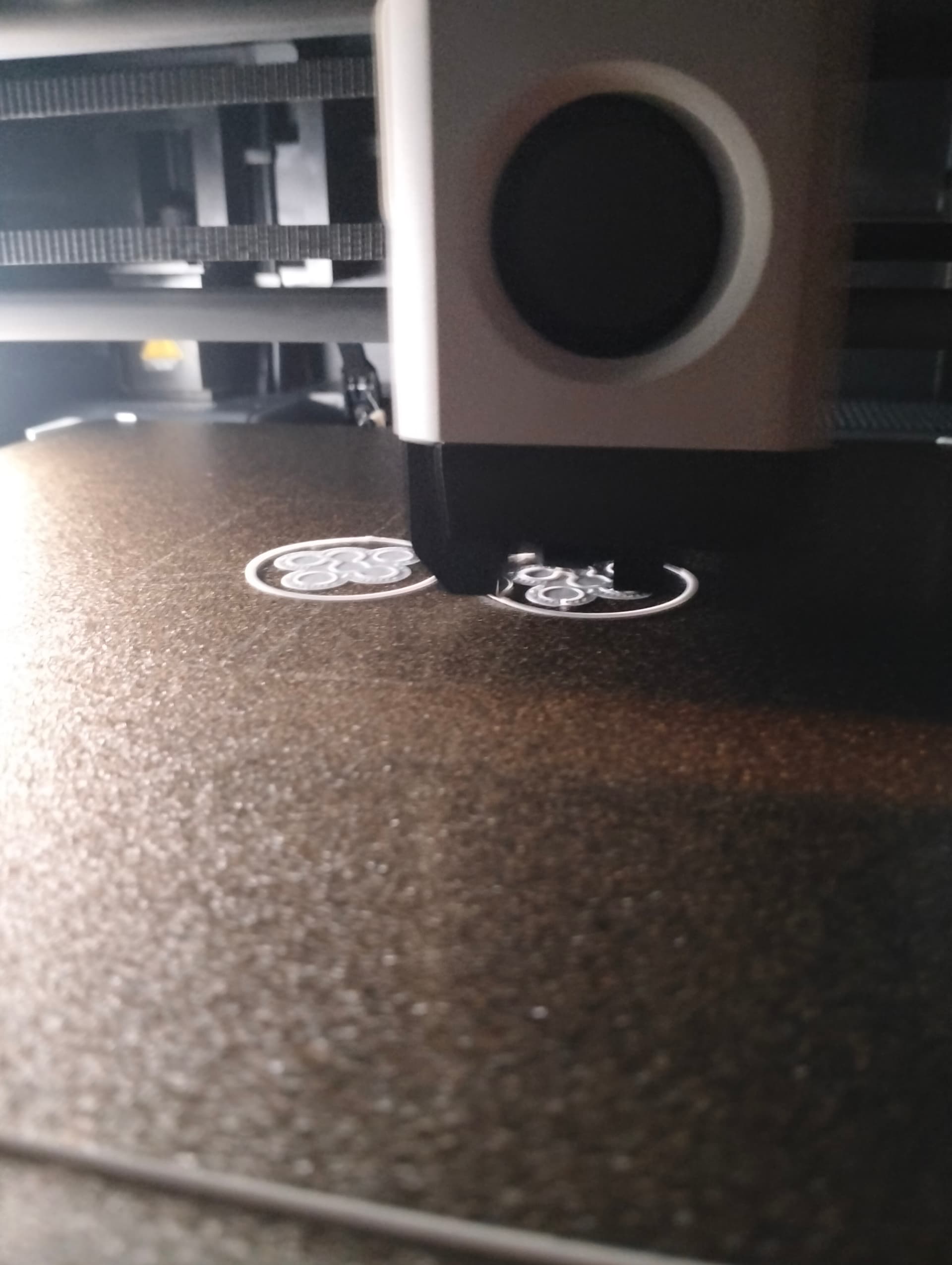

why my filament won’t stick and keeps breaking? previously there was no problem. my filament has only been used for a week and 3 days I put it in ams p1s then I put it in airtight plastic with silica gel. why now my filament doesn’t stick and breaks easily
Have you cleaned the print plate?
To expand on the question above…
How are you cleaning your plate?
I use alcohol 70% and clean with cloth. I used other filament its find i just find the problem with my white sunlu PLA+. Before i theres no problem this filament.

The reason why we recommend detergent for cleaning the textured plate is due to its textured surface. Alcohol might just spread the oils on the print surface instead of removing it.
Detergent acts as a degreaser and using a sponge or scrubber to wash the plate will ensure the detergent reaches inside the textured surface to clean it and improve adhesion.
Thanks you for the tip, but my others filament its find. I just have problem with my white filament maybe my filament its broke?

Hello, thanks you so much, you save me. I follow your instructions and it’s working :slight_smile: , i so appreciate your solution :pray:
