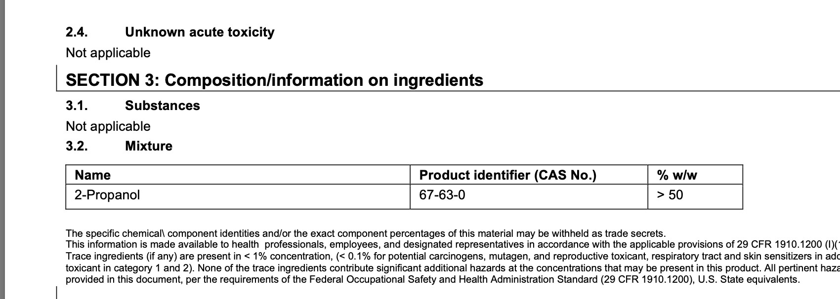

If there were some other solvent it could be diluted into (without destroying it), that might be a good way to both water it down and spread it around.
Send them an email, they are good about replying promptly. Propanol alcohol should work as that is what they use, from the MSDS:
Perfect! surely that would work if it’s already more than 50% that.
Let us know how it works out.
