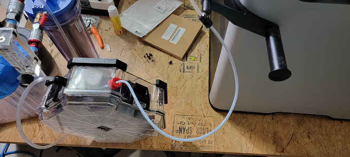

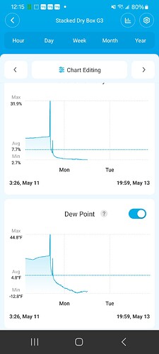

BTW, here’s how I was able to keep my PPS-CF ridiculously dry while printing:
Basically, I pump a constant stream of desiccated air into the drybox, creating a positive pressure so no ambient moisture can get inside.
