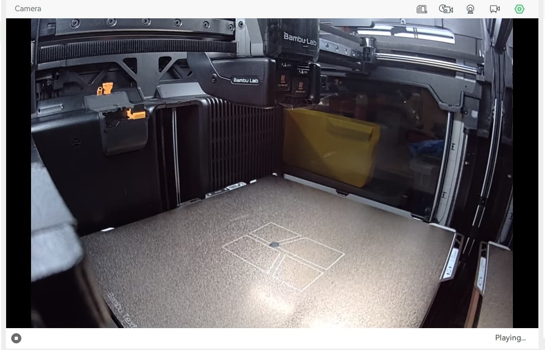

By the way, I was informed by one of the computer vision experts on the forum that interior reflections from the right window likely impairs the performance of the Bambulab H2D AI vision system for things like spaghetti detection. So, I figure a “perfect layer test print” done on the H2D in PPS-CF could be repurposed afterward and hung up against that window using Kapton tape as a means of mitigation. Given the natural flame resistance of the material, and its tolerance to very high temperatures, it would seem like a natural choice. It has a matte black finish, so there should be virtually no reflections. :sunglasses:
I currently have my Bambu AI set to medium sensitivity, because I did have problems with false positives after setting it to high sensitivity. Maybe with this adjustment I could set it back to high sensitivity and without false positives. Worth a shot I suppose.
Thanks for sharing makes perfect sense, and especially with the printer operating under different lighting conditions could also be effecting the AI the smoke glass dims and diffuses incoming light, but it doesn’t block it entirely.
Because I didn’t buy the laser version, mine is closer to clear glass.
Alternately, I suppose one could mount some kind of diffuse planar light source against the outside of the window. This would serve the purpose of 1. limiting the view of possibly distracting objects outside the window, and 2. overpowering the reflections, so negating them as well.
In general, I like to stick as close to stock as I can, so I haven’t tried either method, at least not yet, but I may in the future, as neither would demand much effort. My preference for stock configuration is that it’s the Bambu Model. Few good ways to tweak it, so I figure it’s maybe best to just closely conform to it. In the limit case, that would imply doing nothing extra, which is what I’m currently doing.

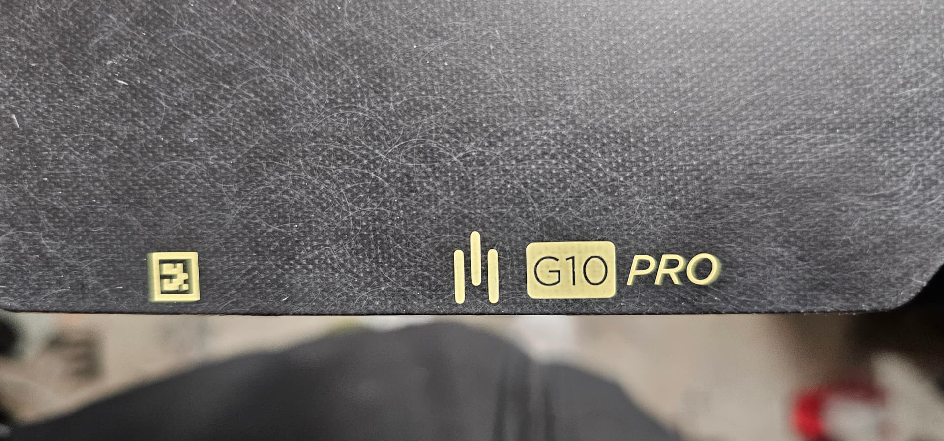

Are lightyear g10 plates no longer a thing? They worked great after a wet sanding
My X1C lightyear g10’s bubbled (both black and white ones), so they lost their flatness. Big bubbles, like giant blisters of a sort. Not super high, but definitely not flat,. And I wasn’t the only one. Others reported similar. Maybe it’s been fixed in production since then? I don’t know, I haven’t tried more. When did you buy yours?
Nope, they went out of business. The owner is a scam artist though, so I’d suggest staying far away if they ever make a comeback. He created a bunch of fake businesses and scammed a bunch of people, myself included.
First release. I bought 2. Not used very often though.
They sucked until I added a fine satin texture
@Qjo
Funny that he went out of business because I had also bought 2 for the mini when it came out and they never showed up.
Another example of the scam artist. Hopefully you were able to get your money back. Fortunately I used PayPal so I was able to file a dispute and eventually get my money back.
It was was one of those weird “order and wait” for the double sided pro plates. By the time I remembered I had ordered them, it was probably too late to dispute. Im not sure if he ever even shipped any g10 pro mini plates
Yeah, I never did quite get around to sending my plates back for a warranty claim. Some people did, and he replaced them. But if, as you say, he’s now out of business, then I missed the return/exchange window and it would be too late now. Bummer! While they did work, they worked quite well.
