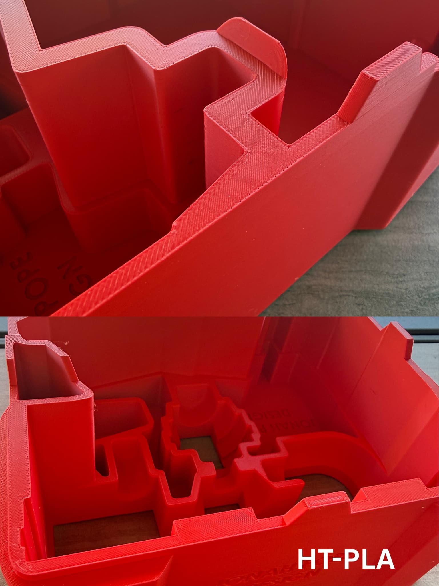

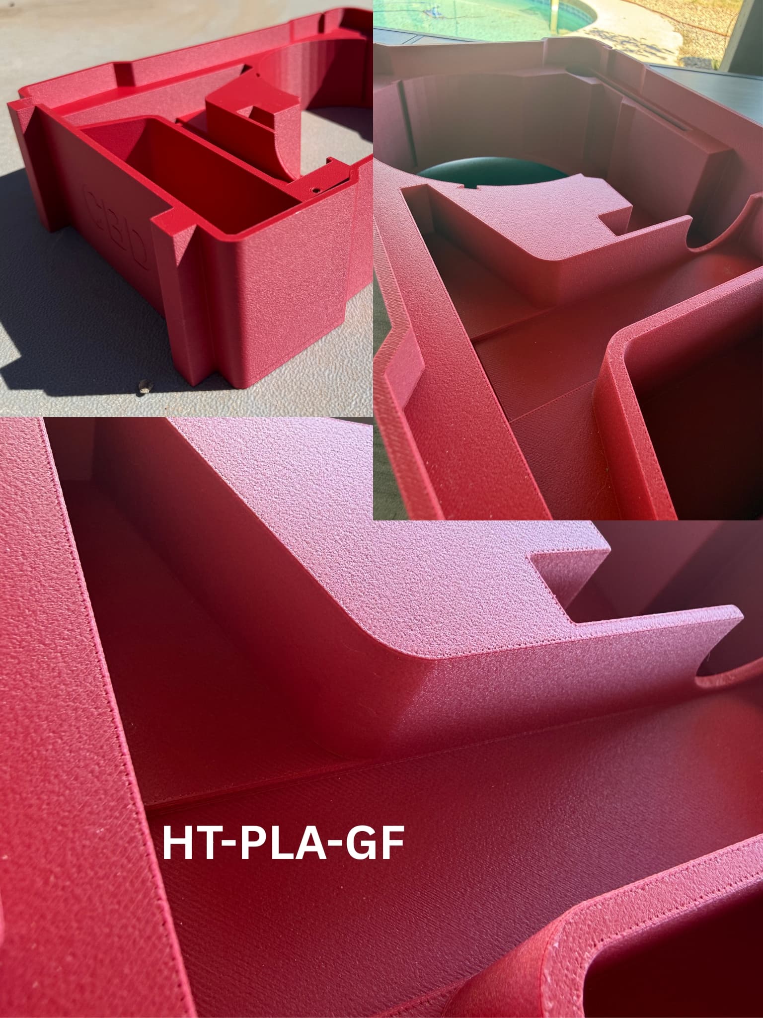

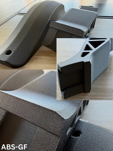

No post-processing was performed on any of the prints shown beyond brushing away zits or removing supports. These are all printed with generic or Bambu profiles, depending on the filament used.
These are my Milwaukee Packout inserts. I was very happy with how all four filament types turned out, particularly the GF variants: ABS-GF, PETG-HF, HT-PLA, HT-PLA-GF. As for how the HT-PLA variants hold up compared to the others, time will tell!

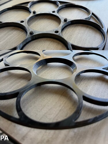

These spool desiccant containers were printed in PC and hold desiccant for the spools that need it. They fit into a spool-sized frame printed in PA that allows me to dry a bunch at once in my AMS-HT. Quality on both was excellent. The PA frame needed glue to get good bed adhesion on the smooth plate.
The excellent spool holder & spine by MadeInMeidling on Makerworld printed wonderfully. The spool holder was printed with BL Matte PLA in the Bone White color, which has become my favorite white to print with. The spine has a dovetail and mortise joint that join the various pieces together and the tolerances with the ABS-GF were perfect. The parts fit together easily and have zero slop when fully seated, though that’s as much a testament to the model’s creator’s skill as well.
