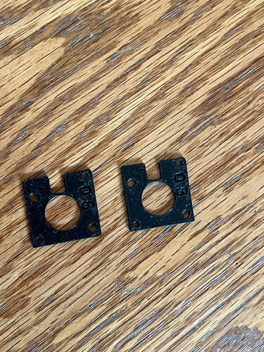

I then attempted to reduce the pressure from the magnet/hall sensor. For this I tried different spacers between the magnet spring and PCB. I tried different thicknesses (0.6mm, 0.8mm, 1mm). 1mm was too thick and the hall sensor was not triggering, 0.8mm was not reliable, 0.6mm was perfect. I cannot say it improves the friction or not, some tests seem to make it better, some seem to make no difference. I also tried some softer springs with same result, again not worth the trouble.

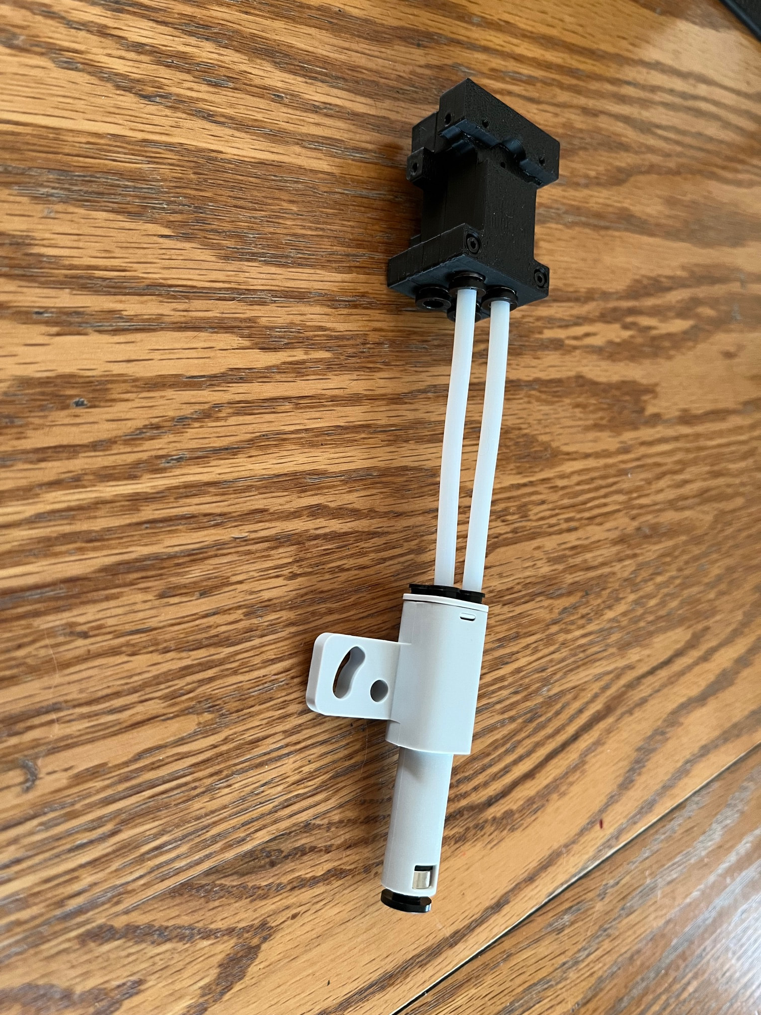

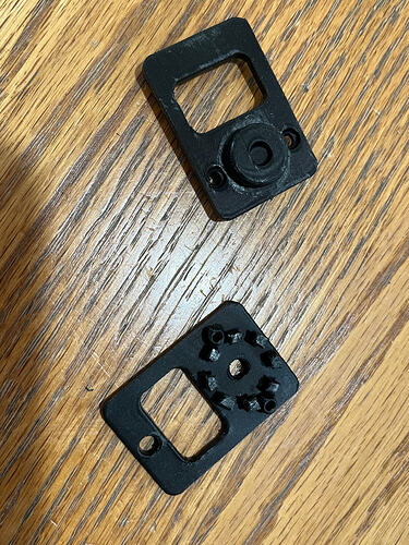

I also experimented again with my switch mount as during my many experiments I was sometimes too lazy to mount and dismount the switch from its support and when it was free to move just kept in place by the PTFE tubes, the flow was better. I then just designed a small rotating adapter between the switch and its support to allow the switch to sort of self align rather than constraining the PTFE tubes to a forced orientation and further improve the flow.
This adapter can be installed on any mount, bambu’s or alternates.
In the end, my final configuration is (until I find more things to tweak):
1. Vertical support on the left and down from the printer inputs to keep a certain length and nice curves
2. Filing of the switch levers on both sides
3. Rotating adapter between switch and support
I’m now satisfied, the filament now flows freely (at least I’d like to think so) with only minimal more drag than without the switch.
