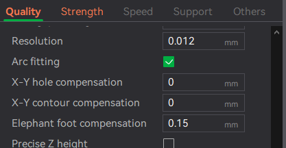

There’s actually a setting in the slicer to account for this. XY Hole compensation or something like that, can’t remember, not where I can fire up the slicer to look.

The 1.2mm is indeed to small for the .6 nozzle but may work if I experiment with the XY Hole parameter mentioned above.
