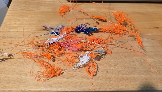

My poops are long and stringy!
Ok, not a huge issue but I couldn’t find a report of this (or maybe I missed it).
Here recently one of my X1’s has been purging rather strangely. Instead of the normally compact waste wads, these are all coming up stringy and they can get caught in the chute. Printer still seems to print just fine though. Any ideas on what might cause this?

Here’s a quick video as well. You can see the filament coiling up at the bottom of the chute. https://photos.app.goo.gl/VLGXN8ZsJNDuuuGM8

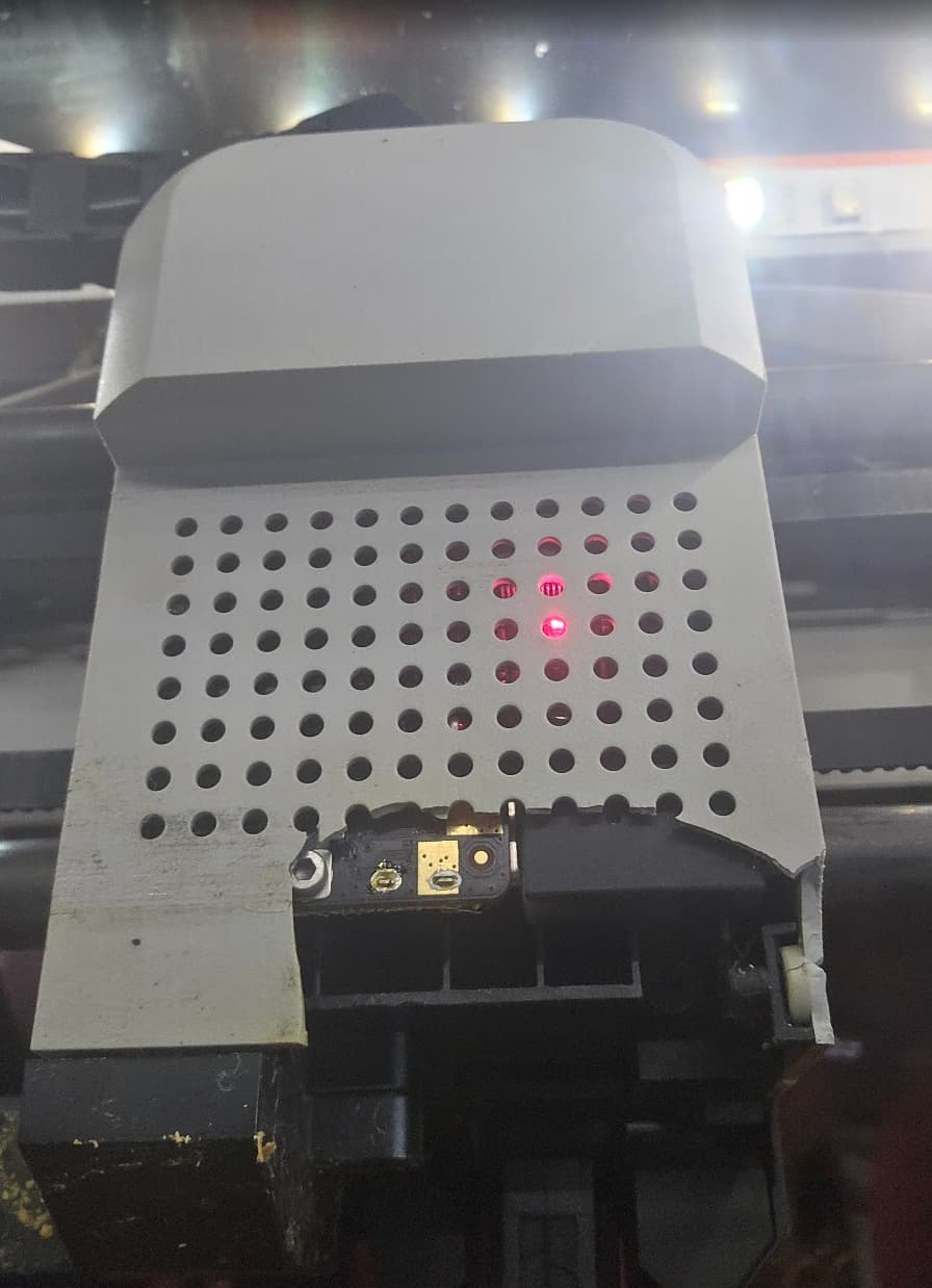

Well, went through a few troubleshooting steps with Bambu support like swapping nozzles and extruders with my other X1. That didn’t help anything. However, since I had some downtime today, I had time to really watch both machines and the purging cycles.
I realized that the issue was the toolhead in the problem machine wasn’t making good contact with the lever in the purge chute so that lever wasn’t actuating the swinging “trapdoor” that typically catches the purged filament.
Well, after a little more digging, I discovered damage to the housing on the backside of the toolhead which was causing the lack of interaction with the purge lever. There must have been a collision at some point but I don’t recall ever seeing this broken piece so perhaps it went down the chute.
Anyways, just figured I’d share this in case anyone comes across this issue in the future.
So I searched the interwebs for hours looking for a solution to the stringy purge and to my dismay a lot of the comments are, “your printer needs more fiber, change the printers diet, printer needs gluten free filament.” None of them helpful at all. Which doesn’t surprise me. I read your post(which was very helpful) and decided to look at the back of my toolhead and it was fine. Then I looked at the purge chute and I found that the issue is that the purge chute flap holder(swingy thing in the back of the printer) is broken or missing. It is staying open when the toolhead is purging and allowing the filament to string to the bottom of the chute, hence the stringy poops. Either put in a warranty claim or just buy a new p1s/x1c purge chute from Bambu for $14.99 US and a quick 5 min still and your purge is back to normal. I hope Bambu comes up with a better design because the purge flap holder is plastic and with constant use it now seems to be a wearable part. Hope this all helps.
when mine was doing this i found that the back cover of the tool head was broken and that allowed the flap to not close . i at first gued a thin piece of plexi across the broken area that worked great and then i just printed a new cover hope this helps someone took me all day to figure out what it was
