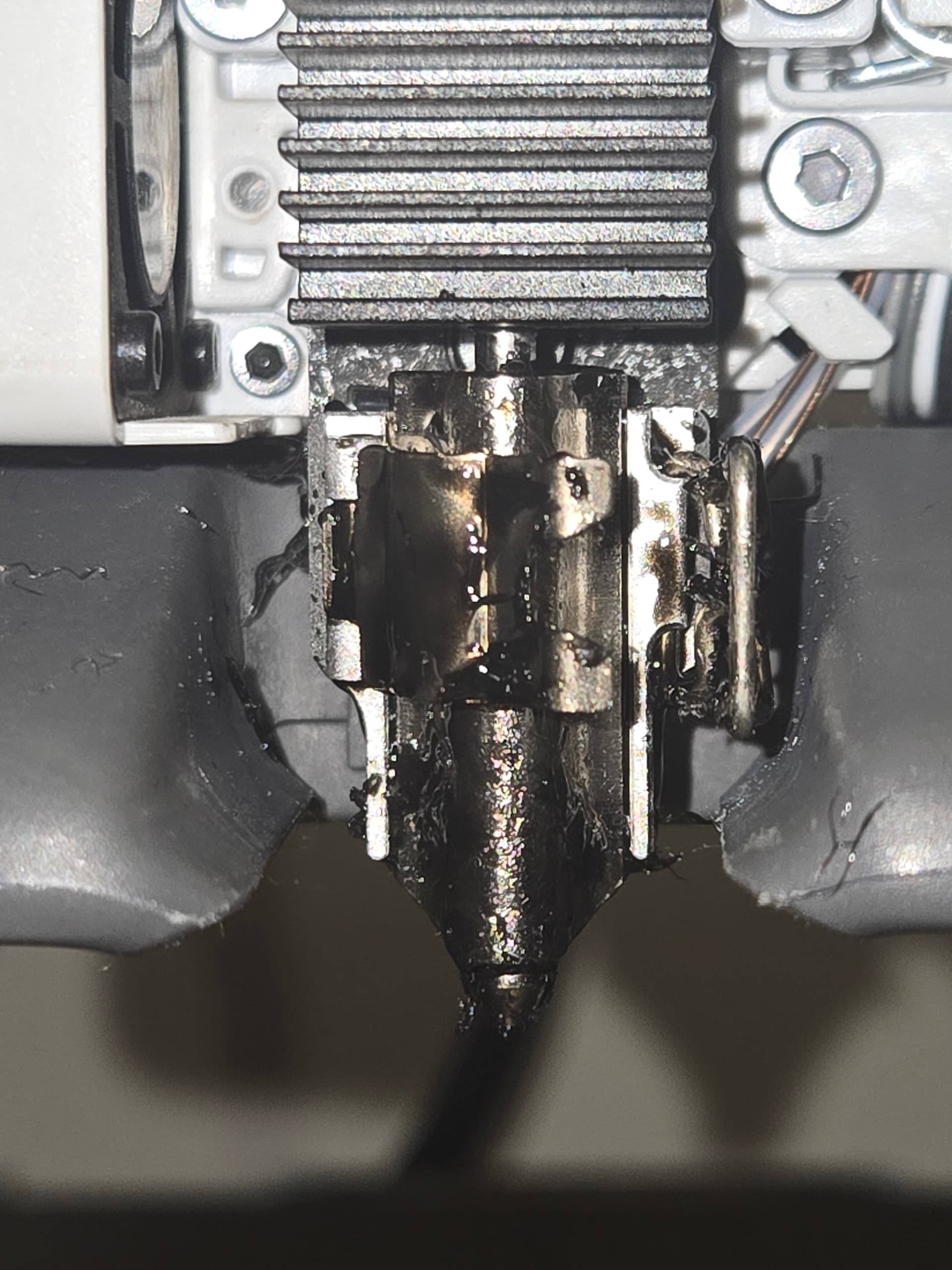

My print failed, is there any way to clean the nozzle?
Never had a print cover my nozzle to this extent. Is there any way to properly clean this? Material is petg
Heat the nozzle up and use a brass brush to scrub it off.
I would heat it up to 300*C and see how well i could clean it.
Definitely use protection for your hands. Safety first.
But imo its best that you get a new one and maybe clean this one and keep it as a spare just in case
Wow-how did that happen?
But yes, heat it up to 300 degrees, then using 2 pairs of pliers, open it and use a scraper or other scrubbing object (steel wool pads at the expense of some scratches maybe) to scrub it off. Be careful of bubbling and always scrape it into a plastic bag or non combustible collection point
I think that this page could help you : Hotend Clumping/Blob Cleaning Instructions | Bambu Lab Wiki
the answers are always broadly the same, whatever the methods used: heating to soften the plastic and brushing to remove it. Be careful to protect yourself from the heat of the nozzle
I agree, it doesnt go more indepth than that!
Mark that comment as the solution!
I’ve had it happen a few times too, where it just essentially fills up the rubber boot and shuts off, then hardens to a very frustrating block.
Got to that point as well with a PETG print that went off without being detected. Heat + towel was fine for the head, and a part of the nozzle, then as previously said, brass brush + knife did the rest. The silicon boot couldn’t be saved…
Some rest kept coming back for some prints, I used the paper towel trick and brass brush again until gone. Hope that helps!
One symptom was it was difficult to swap for a different hotend.
