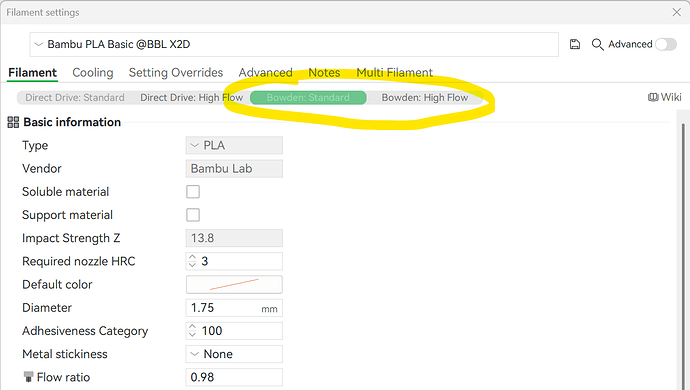

What are you talking about? If you are complaining about settings, they are right there in the filament profile settings:
But… I know many reviewers said that the second nozzle is “fine” for the dual-color printing… at the end of the day, it is still a bowden extruder setup with all its drawbacks. Don’t expect is to work as good or as fast as the main nozzle.
I didn’t say we need settings for it, obviously there are settings, I said we need a setup recommendation for it, can you read? ffs. You wouldn’t even apply it there anyway, it would be in PRINTER settings since you would want the Bowden settings to apply to all prints in terms of retraction, etc.

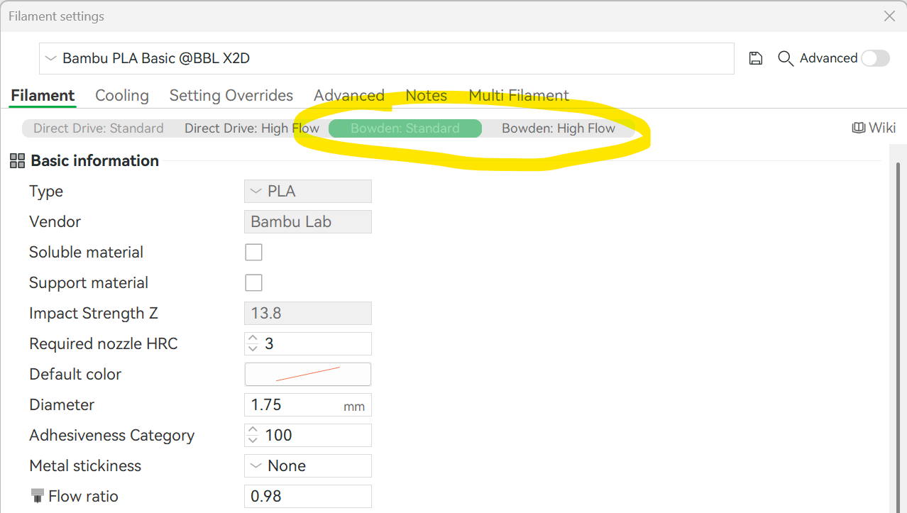

Same place. :dotted_line_face:
That’s why there exist profiles for different filaments. If Bambu profiles don’t work with BL filament, then you can report it to them and they will likely fix it.

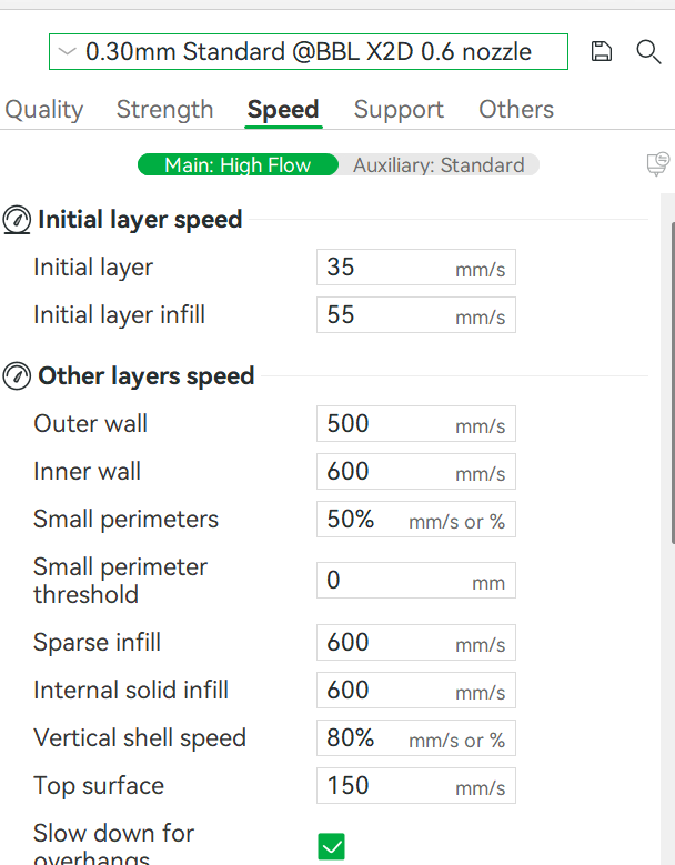

Nah man, I think they mean all the other settings that are under print settings and not filament settings. Outer wall speeds, infills, whatever. Some things there would actually be nice not to be bundled up as global settings and something like AUX nozzle outer wall speed clild be a useful setting to manually fine tune.

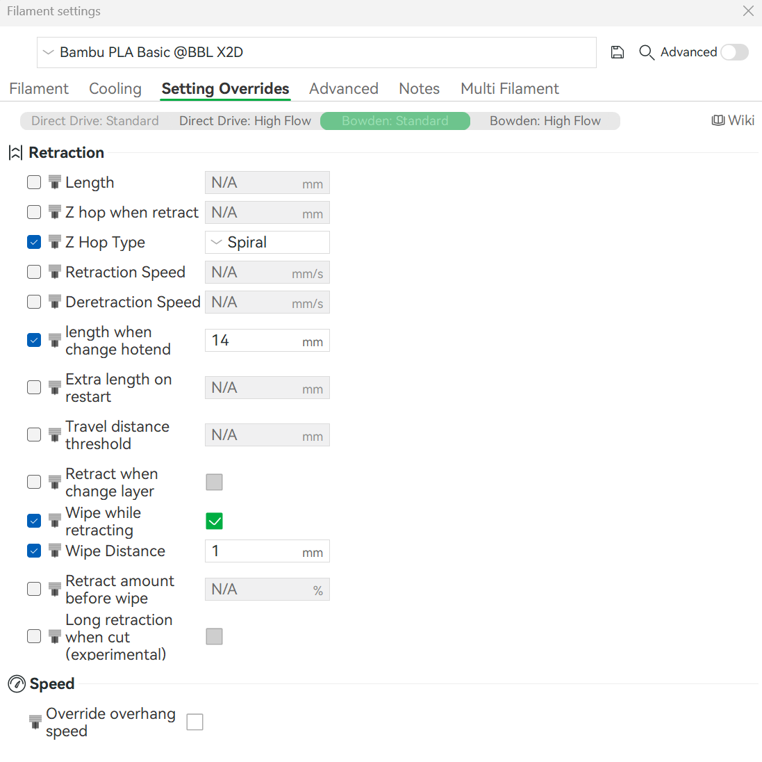

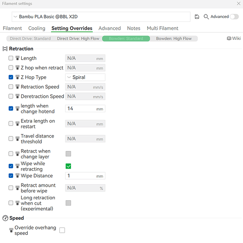

Retraction settings are in filament profile settings.
Speed settings do differentiate between nozzles.

Like, the settings override section is fine for some things but the Bowden retraction distance you NEVER want to change, no matter what filament. It’s about the behavior of the bowden drive, not the filament passing through. And you can only use a select few types of filament in the second nozzle anyway. In the “Printer” settings, the big icon with the printer picture, click on the diagonal arrow when you mouse over. Retraction should be in there.
Anyway my point is that the retract settings are not correct on the second nozzle, no matter if you change them in the filament override section or the printer settings. I wish there was a community thread with everyone’s ideas about how to fine tune it. I would be a lot happier with the printer if I could nail that down.
