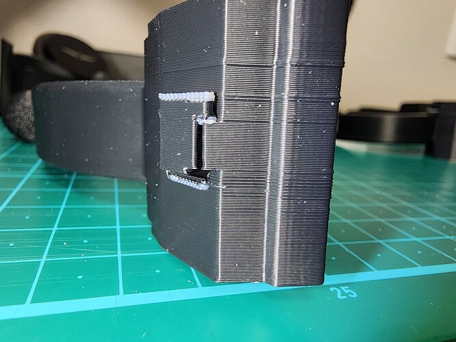

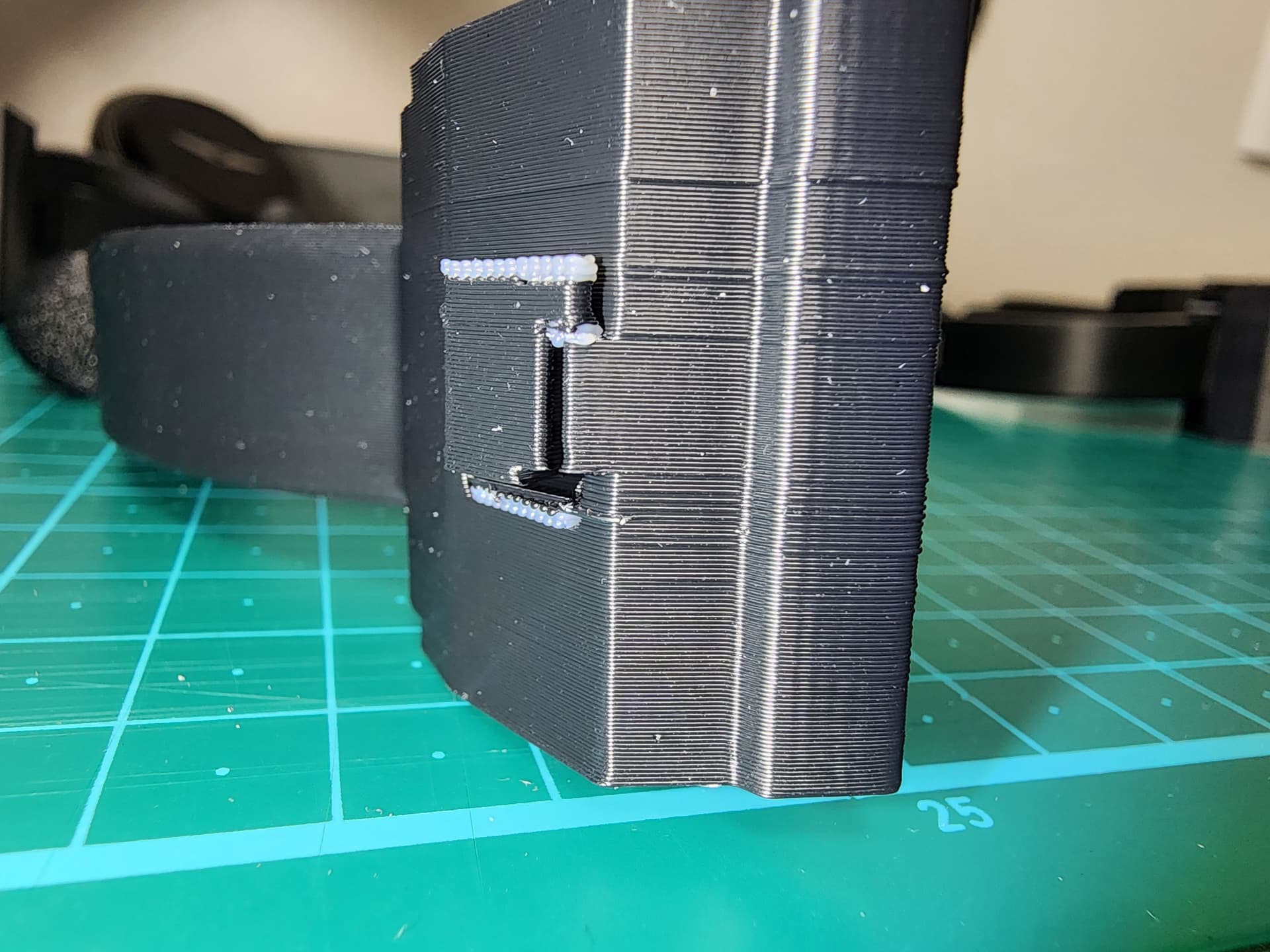

I’ve read through a lot of posts regarding issues with ASA and tried just about all the suggested methods. But I just can’t seem to solve this layer adhesion / shifting issue. As a result it feels very brittle, a liittle bit of force will take the layers apart. I do not have plate adhesion issues whatsoever.
I’ve tried
Slowing all speeds to first 150 and now also tried below 90
Chamber temp above 50C
flow rates in between 0.95 - 1.00
Letting it cool slowly (chamber temp 35ish) before removal
different nozzle temps 250 255 260 265
Tried different brand ASAs about to order BL ASA as my next try. Not a lot of brand choices here.
What causes this??

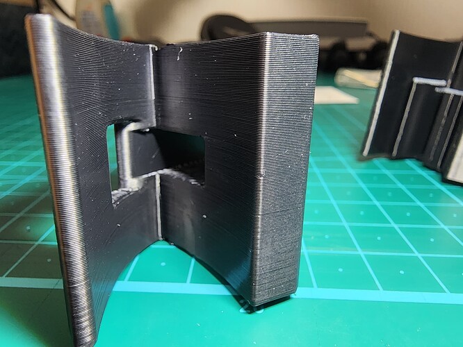

Important update:
I’ve done more testing since my first post… I’ve printed dozens of these now :face_exhaling: but finally, I’m 99% sure what the culprit is. It is the support interface material I’ve been using, HIPS.
Took me too long to realize this but once I did, I printed the model again without using HIPS and it came out flawlessly!

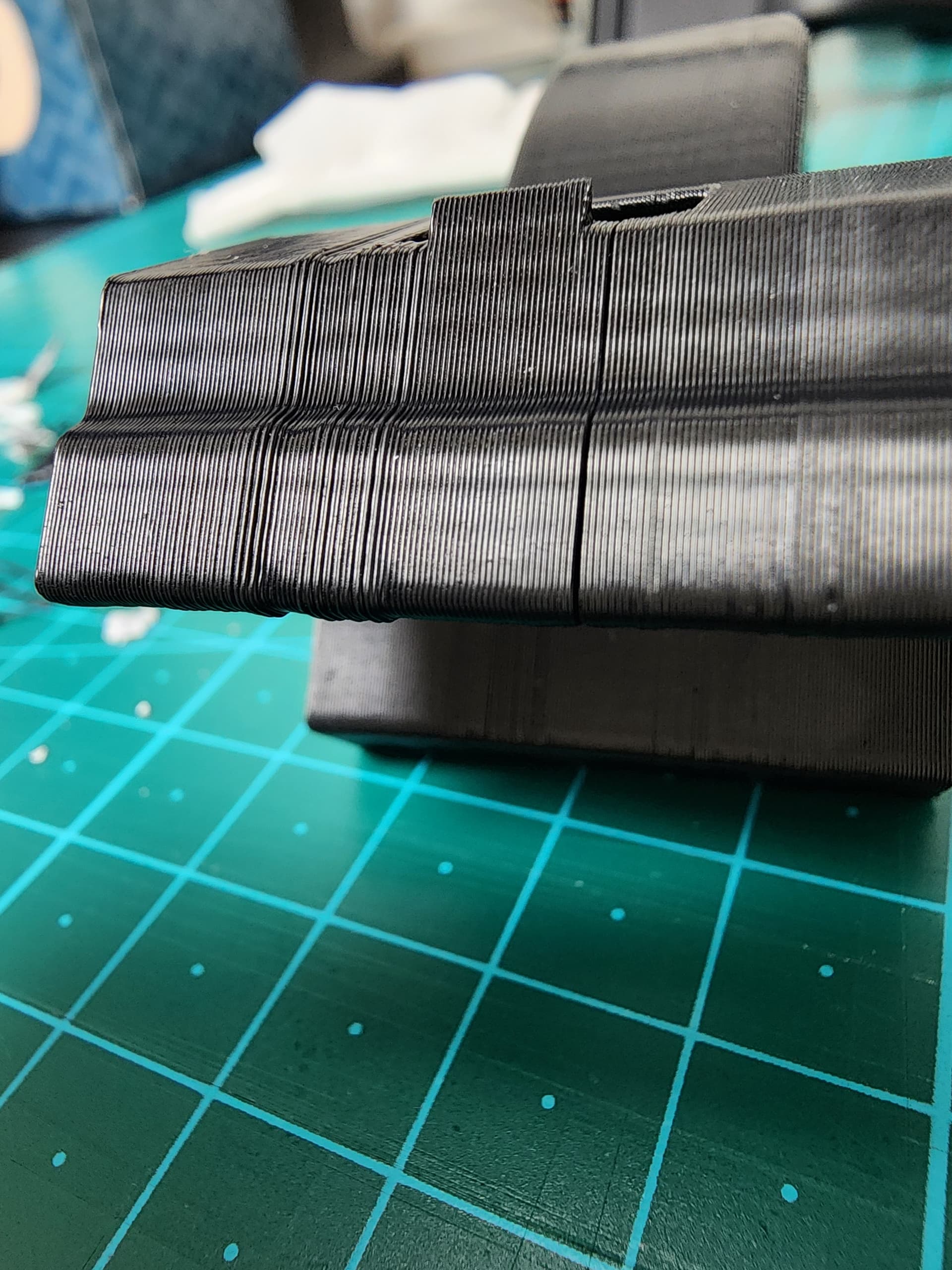

So on my next print, I changed ALL of HIPS’ setting values to be exactly the same as the ASA’s. The results were an improvement but not perfect. I no longer had cracks (image in first post), but I still have the layer shifts and you can see they’re happening on the same layers where the support interfaces are.
So I guess I should be looking for a HIPS expert now. :joy:

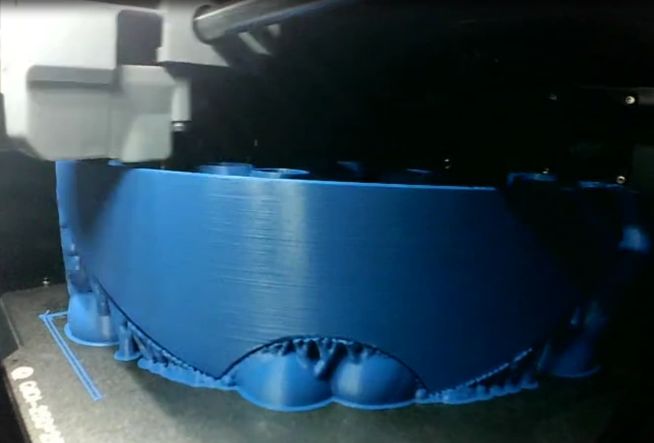

Aha! Different materials through the same extruder can definitely cause problems if the nozzle is trying to change temps. Even just the pausing to purge between layers can create layer issues if the previous layer has cooled too much and the new layer isn’t hot enough to heat it back up. Although you tried higher nozzle temps so I don’t that was an issue.
ASA already has enough of a problem with layer adhesion that has worked out well to not use a support interface material. My supports tear away cleanly without issues, and that was on a pit droid dome angled in on its edge to get it to fit.
You need to max out the flushing when going from HIPS to ASA and ASA to HIPS. Otherwise the materials mix together, making the HIPS harder to take off and making the ASA weaker.
If maxing out is not enough, or if it is clogging the chute too much, then you can add another small part beside your main part, and make sure it’s layers are printed first and that the order of printed layers is always ASA then HIPS.
I use ASA with $$$ dissolvable support interfaces. In my experience, the support ruins layer adhesion is there is ANY mixing. Keep increasing flushing volume/ size of prime tower until the next layer is great.
