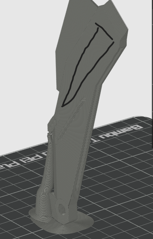

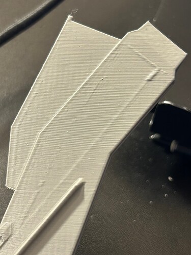

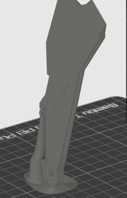

I’m trying to figure out why a part I have seems to develop geometric depressions (either that or there are bulges in the print outlining a shape?) in a part I am trying to print.
The part in question has a cutout from the back-side of the part, and the depressions occur in the walls parallel to the cutout, roughly in the area marked in the screenshot below as well as on the opposite side of the part The surface of the part should be flat, so the depression is not intentional. Sharp corners on the part are also bulging outwards/rounded slightly, so I tried addressing this in case it would resolve the depression. I have not been able to prevent either.
The part:
The approximate area of the depression
The issue in real life:
I am printing the part vertically like this because it wasn’t really originally designed for filament printing and I am just experimenting with what I can do (in other words, there aren’t many good surfaces to put flush to the base plate), but the depressions only started to appear when the cutout was made (so it can interface with another part). I have to assume it is related to how the thin walls are being created.

Hi there, welcome to the forums!
I noticed there seem to be layer lines on your filament. Is your filament dry, or has it been in contact with moisture? I also notice that there are very few supports on your build plate, perhaps increasing those will lower the stress on your print? Regarding the main issue, it seems to me as if you are talking about the little V-shapes… is this correct?

  3. Yes, the main issue is the sort of V-shaped area composed of bulging print lines and a slight triangular depression inside that V

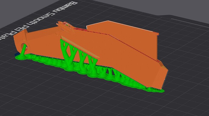

I just looked at the 3mf file and have a general question: Why are you printing it upright? The higher you print, the more likely vibrations are to become noticeable, especially at extreme heights with an extremely narrow design?
Wouldn’t it make more sense to approach it this way? You can still go over the surface with a file afterwards to make it perfect; this is not noticeable with white filament. Perhaps very hot water will suffice, too. Or if you’re brave, use a hot air gun, but please be careful! Quick and straightforward.
If you print it this way, put it in the freezer for 5 to 10 minutes along with the printer plate. Then you can remove the support more easily and cleanly.
Furthermore, for such extreme requirements, you should not use the standard 0.2 profile, but rather a “High Quality” profile and start your settings from there. Because the speed of the printer is reduced. What you did great and is important: Gyroid, perfect!
However, I would set the wall thickness to at least 3, as 2 is insufficient in this context. Just look at how fragile it is with only two walls:
This probably won’t solve your main problem, but it will significantly improve the quality. Poor-quality settings and problematic orientation also contribute to the issue.
In short, I believe the main problems are vibration at high speeds and the extremely thin tall construction. With the standard profile, the speed is probably too fast, causing it to vibrate. It’s not as extreme as it sounds, but it’s enough to cause mistakes.

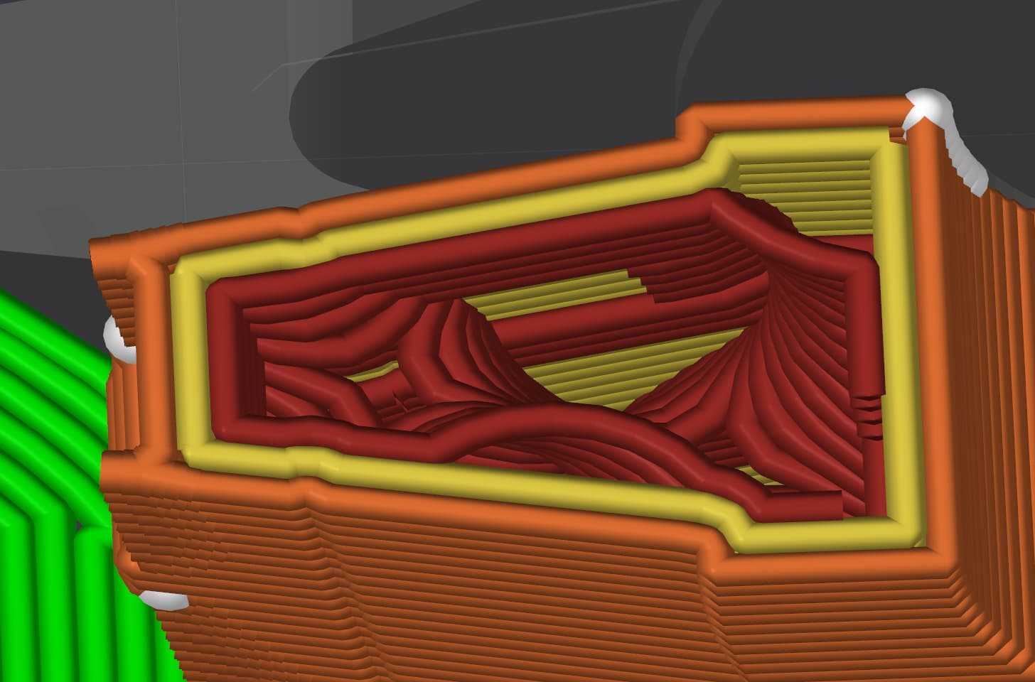

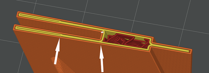

The bulging lines correspond to places where the internal structure changes thickness.
The outer surfaces of the part are tapered, allowing more walls at the outer edge than at the beginning. The bulges occur at the transition between three and four walls, and at the end of the slot.
Try combinations of a smaller nozzle with a narrower line width, or thinner walls. The part is not very thick, so your options are limited. Thinner lines may just create more, less noticeable bulges at different locations. If a single wall is strong enough, the surface may be smoother because the overall thickness variation will take place in the infill, but the infill may show through.

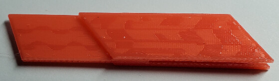

A small test section, one wall, 0.4 nozzle in scrap, damp, somewhat translucent, PETG.

I think ikraus identified it right, and if you can fiddle with the Arachne wall sizes enough, you might be able to get it to use full independent wall loops through that whole area. This will prevent the extruder from having to retract and travel to get to the next spot, which is likely causing some of that effect. You will be able to see this in the preview.
Just following up, Ikraus hit the nail on the head. It was absolutely the change from two walls to one solid infill. I’m gonna go play around with settings more, but a test where I knocked it down to one slightly thinner wall made the issue go away. Thank you!
