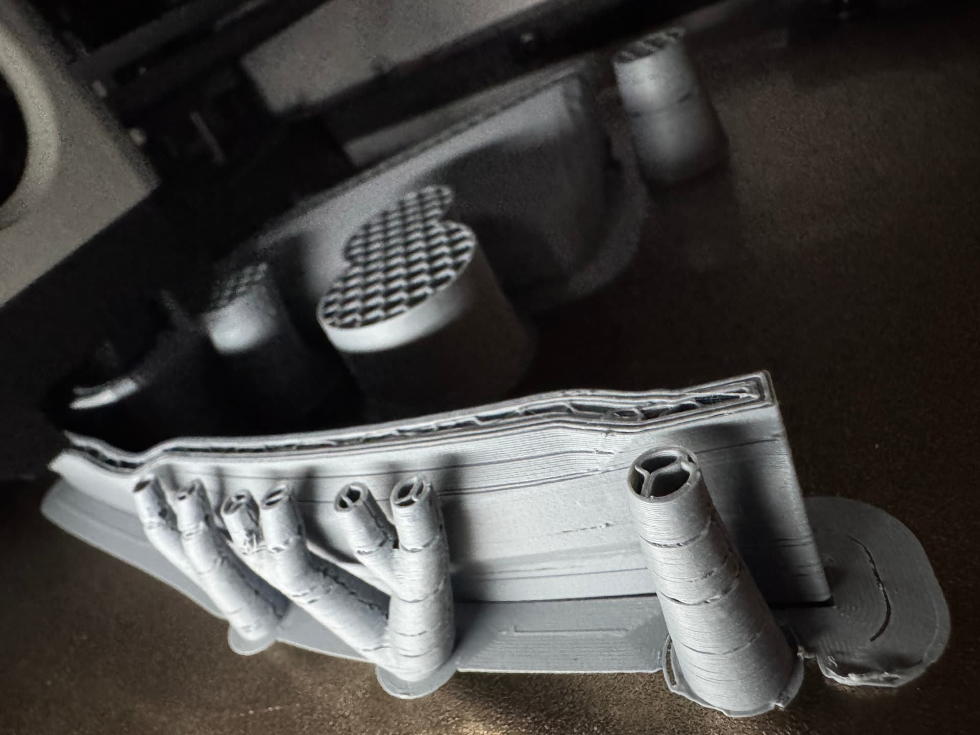

Need some help. Was getting some missing lines / gaps in my print. Happened halfway through a 12 hour print.
Door was open. It is PLA. I have performed a device test including a manual test of the fans. All appear to be working. I then Used once of those cleaning wires to try and make sure not a block and printed a benchy but no joy, still getting those defects. Cleaned the nozzle again. Did a cold pull and yes I saw “bits” on the pulled filament. Did another nozzle clean with a needle but still having issues.
So I fitted a brand new hotted and it is still happening. Please can anyone provide any guidance.

Indeed, that does not look good. Since there are number of things that can cause this, I would recommend this troubleshooting chain:
  • Of course the filament needs to be dry and the temp should be sufficiently high and stable. For PLA (only), I have found it does not matter much if the door and top are open. I prefer to things closed.
  • Do a number of hex key cold pulls again. It is common that multiple pulls are needed to clean a partial clog.
  • While having the hot end in your hand, check the thermal paste. If it flakes, renew. This is also good opp to check that the nozzle is straight.
  • Before trying a print again, clean the extruder in case of flakes/filament dust travelling back and forth.
  • While doing that, have a look at the filament cutter in case it is blunted or likes to stick.
  • Check and if neccessary replace your PTFE’s, in particular to the extruder and from the AMS to the Hub/Buffer (they tend to be my personal pain points).
I hope that one or more of these points are helpful.

The picture you provided is helpful, but could you upload three more? These shots would provide a clearer understanding:
  • An oblique angle lower to the plate.
  • A view of the entire build plate with the whole model.
  • A “focused” zoomed-in shot of this area. The current image is a bit blurry, and a sharper image would help to confirm some theories.
If you hadn’t mentioned you were printing with PLA, I would’ve guessed you were using a TPU profile. Are you using the default profile or did you calibrate it manually?
There is a clear temperature difference in how the filament was laid down. The filament at the top is at a much cooler temperature compared to the lower layers. The most likely cause is that your fan is turning on when it shouldn’t.
Investigate your fan settings or simply turn it off for testing. I’ll outline the suggested testing methodology below.

Thanks both, I had some time for remediation today. I have changed the hotend as the last one was the original and had 2300+ hours print time. I also cleaned the extruder and there were some bits in there. I washed the plate, twice as you suggested and tested all the fans again to see if they all still come on and they do.
Only had time for 1 test print. The Grey benchy is before and the white is after the above actions. The bench was as 20 layer height and was a 39 min print.

I would definitely NOT be happy with this benchy if it came off of my printer.
Thanks for posting a known model. This new information really leads to a filament that is out of calibration. Moisture is a possibility even though it’s PLA. Drying your filament can’t hurt so consider that as a first step in troubleshooting before you go any further. Or you can simply try another filament just to see if you can reproduce the problem.
Based on the line in the middle, it’s clear that you’re experiencing filament shrinkage at the deck line. This is caused by the filament behind the wall having more mass so you’re getting shrinkage which is causing the outer wall to shrink at a different rate than the other walls that are thinner.
Now, you could easily go into your slicer settings and change the wall thickness or switch the wall sequence from the default inner/outer to outer/inner, but that doesn’t address the fundamental issue, which is a filament problem.

Thanks for that. Have dried the filament and having the same issues. Printer has 2300 hours on it, filament is the same I have been using for a big project. Got a new extruder on the way and will fit that first and then go back to calibrate.
Given the issue occurred during a very long print after 2 weeks of almost non stop printing I am really thinking a wear and tear issue. Have tested the fans i.e. on and off manually works in case this is to do with heat.

That is a viable theory that I always forget to check. When you get the new extruder, and if it remedies the problem, please post photos of the worn extruder so that he rest of the community can benefit.
BTW: On that line of thinking. You may also want to ensure that your PTFE pathways are unencumbered. Check the wear of the tubing as well as any binding. If you’re using an AMS, one diagnostic step that may help is to do a direct feed bypassing the AMS as a possible culprit.
This theory would also explain the inconsistent layering you’re seeing.
Thank you. I just checked the PTFE pathways and the one that comes into the X1 and goes to the extruder had a ridge in it where it had rubbed.
I replaced that AND bypassed the AMS but unfortunately the result was the same. On the upside I can now rule out the pathways and the AMS. New Extruder has been despatched and will report back in a couple of days when it arrives.

New extruder fitted and so far so good. Big improvement over the cube above.
To anyone who finds this thread after issues then I strongly suggest you follow the great advice I was given above. thanks to @Olias and @EnoTheThracian for their guidance.
The extruder that was replaced does not move smoothly when compared to the new one so clearly it has been worn by the 2300 hours of printing. Going to get another one in to replace the one in the other X1 I have as that has also passed the 2000 hour mark.

Here are a few pictures. One is of a first layer of a small print so people can see that issue was fixed with the extruder change. I also took the old extruder apart and took some photos in case people wanted to see what they look like after 2300 hours of printing.
Regards
Josh
TBH, I would have expected far worse after 2300h.
Many thanks for sharing :slight_smile:
1000h to go on this extruder…
WOW!!! There’s your smoking gun. Look at that wear and tear. The great news here is that you were able to identify and remedy the root cause. That’s got to be cause for celebration. :clinking_glasses: Thanks for sharing.
