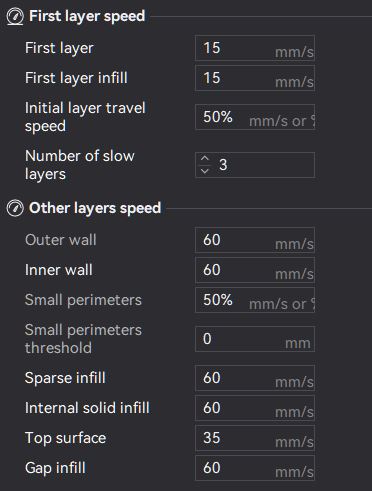

Thank you! I was trying to print significantly faster than your presets. I believe my speed came from some Bambu defaults. Let me try to slow print speed down.

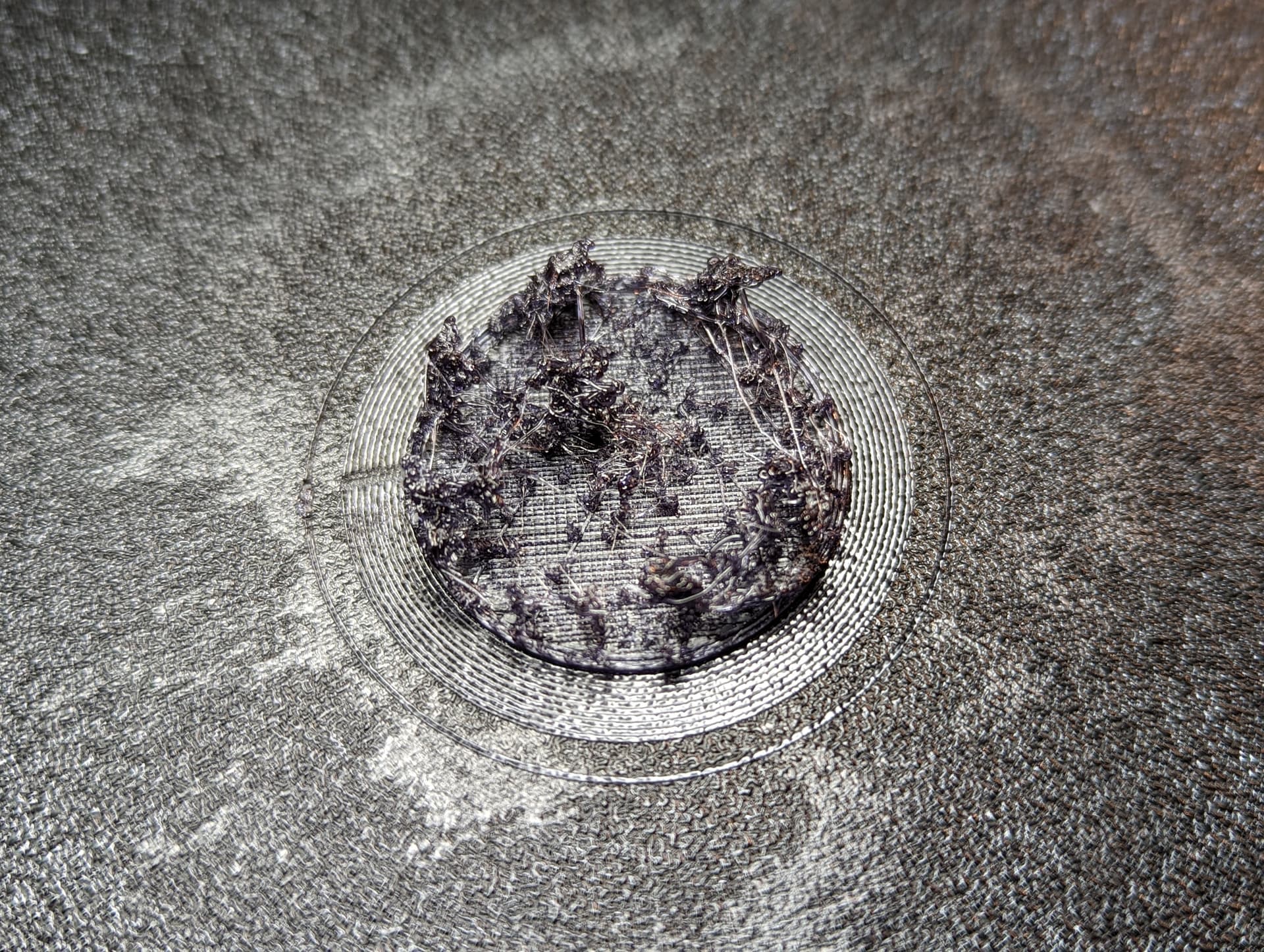

Would you mind exporting your config? I’ve been battling with this roll of 910 all weekend and not having very much luck. I started out printing at 255/50 but actually had better luck at 270/110 which seems contrary to what Taulman recommends.
I’m not having any issues with adhesion at all, first layer looks perfect, but after that things just kinda get worse. The top layer seems to almost disintegrate and turns into this rough sparse layer of random small nylon particles.
Appreciate any help you can offer. I did dry the filament so I don’t think that’s the issue. Also, I haven’t heard any popping sounds at all to indicate moisture in the filament.

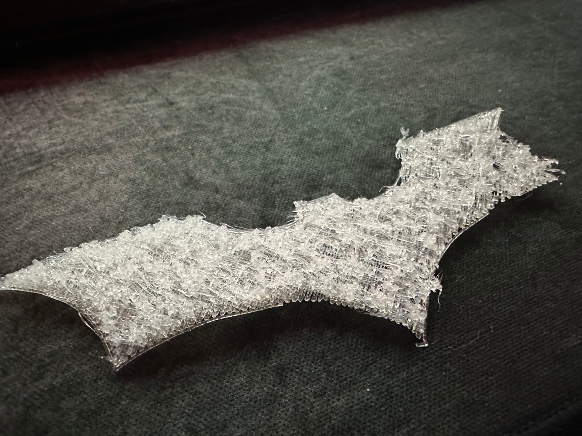

Yes, that is the same issue I am having: perfect first layer then hairy forest. See attached pic.

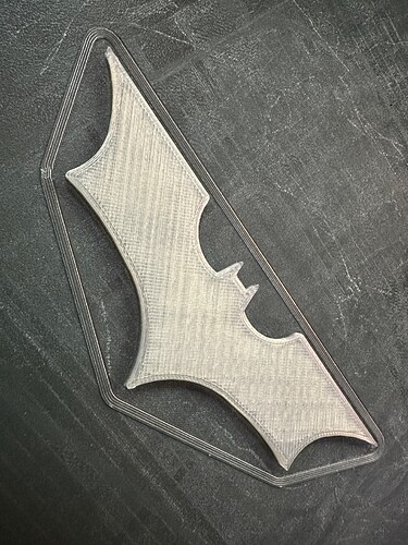

Well it looks like I finally solved the mystery of the 910 sponge prints. I got my food dehydrator today so I figured I would toss the filament in there for 12 hours and give it another go (it actually ended up being closer to 16-18 hours). I didn’t think it was going to help since I had never heard any of the popping sounds associated with moisture, but I figured why not. Unfortunately, I got the same results, in fact I would argue they were even worse than previous attempts.

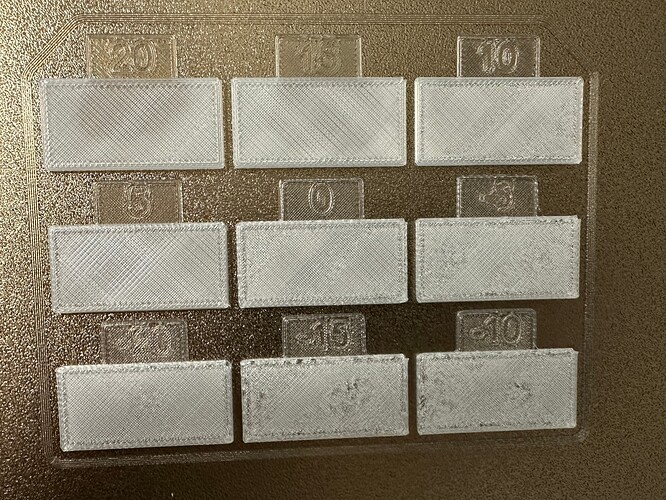

So since I have been running the Orca Slicer calibration routines for a few other filaments the past few days and I had never run it for the 910, I figured I would give it a go. I started with the flow ratio test and to my amazement, a few of the samples actually looked good. Quick note: all the test prints I had done to date were with a flow ratio of 1.
The samples +20 and +15 looked the best, so I updated the flow rate and ran the pressure advance test. That too was way off, so I adjusted and with fingers crossed, printed out the Batman test again.

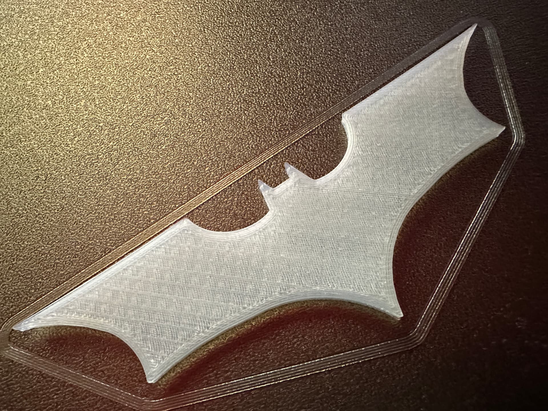

With all the trash prints I’ve had previously with this filament this looks perfect. The truth is there’s still some minor warping and the tips have raised edges so probably need to adjust retraction, but I’m happy where things are for today. So long story longer @sergei.sharonov try running the calibration routines in Orca Slicer, at least the flow rate and pressure advance tests and see if you have better results.

Since your best results were at the limit of the flow ratio test, I think I would run it again to see if further adjustment could provide more improvement.
That’s a really good point! I hadn’t actually considered that, I’ll have to give it another go this weekend.

BTW, I tried extrusion test as recommended by 0x80O0oOverfl0w with the same failure - all samples look severely under-extruded and very inconsistent. The same Bambu Lab Carbon X1 prints PLA and PC just fine.

I think they stopped making this filament but for posterity sake here is my solution. Maybe it applies to other nylon filaments? It seems that either aging or multiple cycles of drying change filament in ways that require increased flow for successful print. Just try printing flow test pattern and it becomes obvious.
