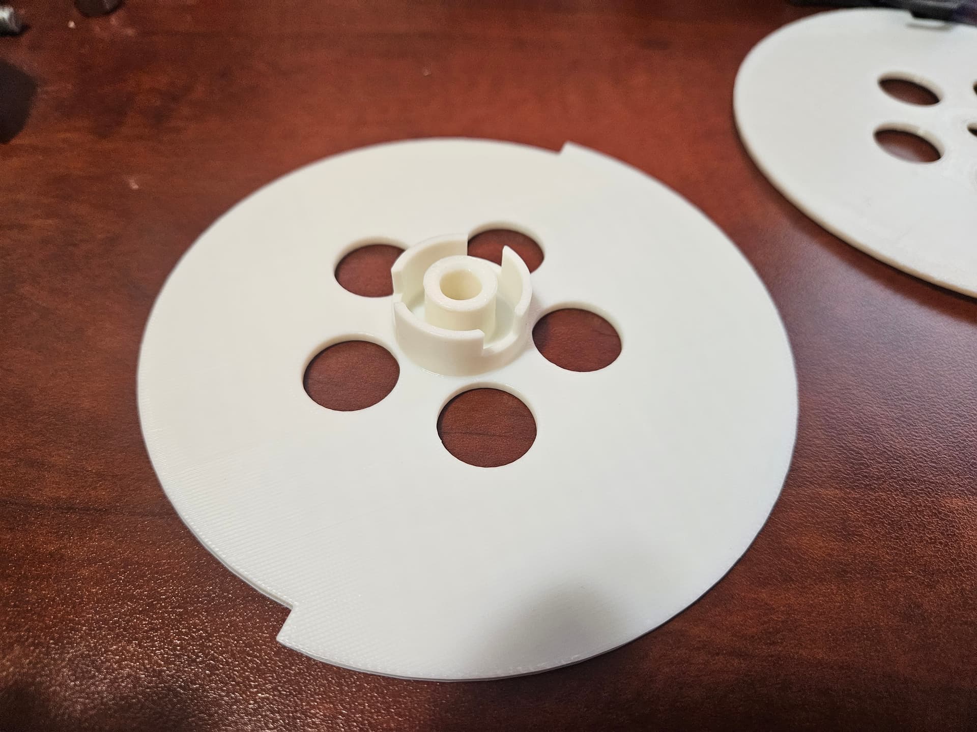

Maybe this can help. I started printing Bambo ASA for the first time this week. I was using the Textured plate, as that works for about everything else I print with
, but not the case with ASA. Tried three prints and they all warped so bad I had to stop and try again. Even used a brim, in which the part warped so bad it came up from the brim and finally popped off the plate and had to stop the print.
This is what worked for me. Went to the Bambo High Temperature Engineering plate. Cleaned with alcohol, then used a glue stick where the print was. Used the Standard Bamboo settings for ASA, other than I added a 10mm Brim with 0 gap. Turned off ALL fans. This part is about 5" in diameter and 1/8" thick. Anyway printed, then let everything sit until all was cool, then removed. Part is nice and flat. Hope this helps.
