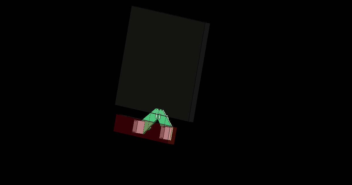

Here is a 3d view of the project to print out brackets to hold a KEF XIO soundbar which weights 20 lbs. The green brackets L&R are printed in two pieces and the grey is an extention to place the soundbar infront (Red in view) of the tv (White in view) ,
So my questions are what is the best orientation of the green pieces on the build plate for greatest strength and what infill and density.
For the grey etensions is it best to print them as part of the green bracket or print separate and bolt to the green bracket (the soundbar (Red in view) attaches to the front of the grey extensions, so concern about stress of the soundbar on the brackets

I’d be more concerned about the stress of your TV on the bracket, or is your TV already mounted on a VESA bracket? And mount your soundbar separately and closer to the wall. Didn’t it come with its own bracket, or at least holes in the back to hang it on a set of screws?

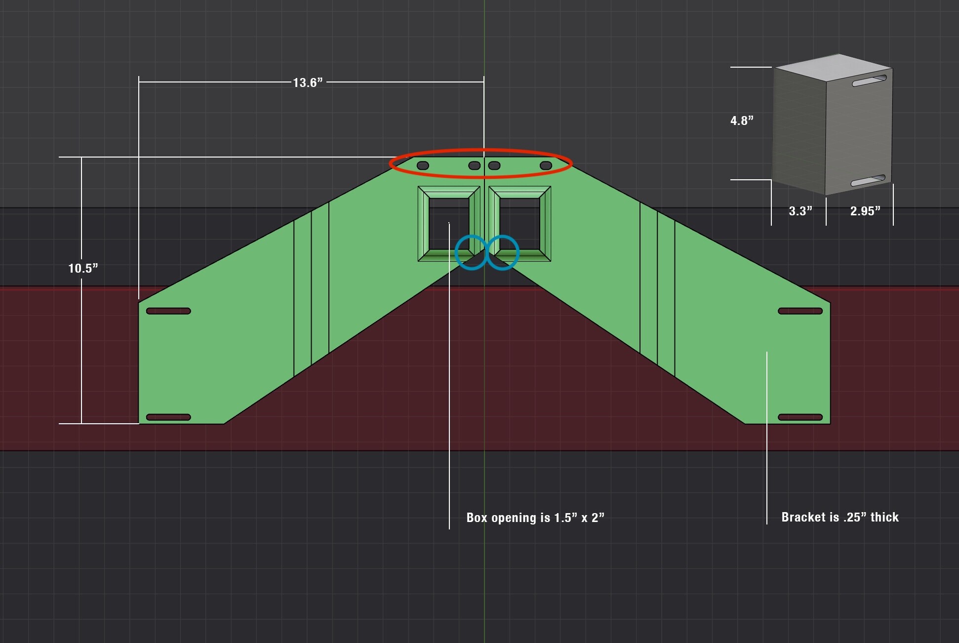

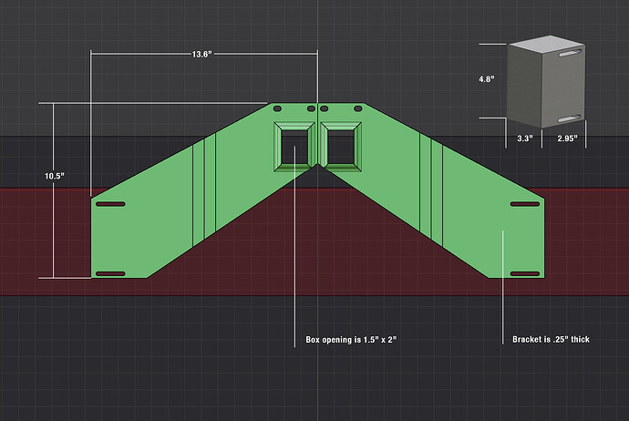

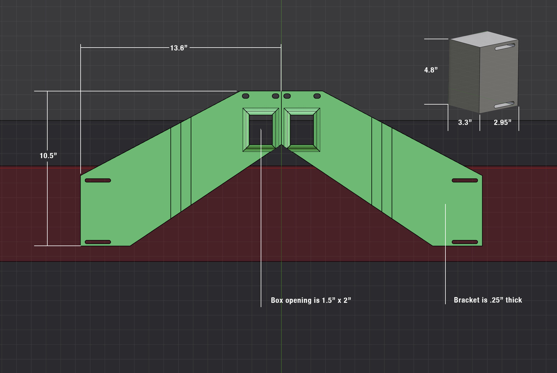

the tv mount can hold the weight of the tv and the soundbar the sq holes on the brackets are because of an obstruction from the mount (for our existing Bose bar that attach to the tv wall mount so the new soundbar is not attached to the tv but the wall mount, the measurements of the bracket are in the new illustration attached hope this helps and thanks for your insight

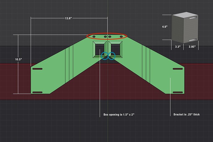

I’ll try in an image …
The red area: that’s where the torque of all of the weight hanging in front of it needs to be absorbed in a very short distance. Try to increase that vertical distance if at all possible.
The cyan areas: why so thin there ?
And add some ribs on the back side.
