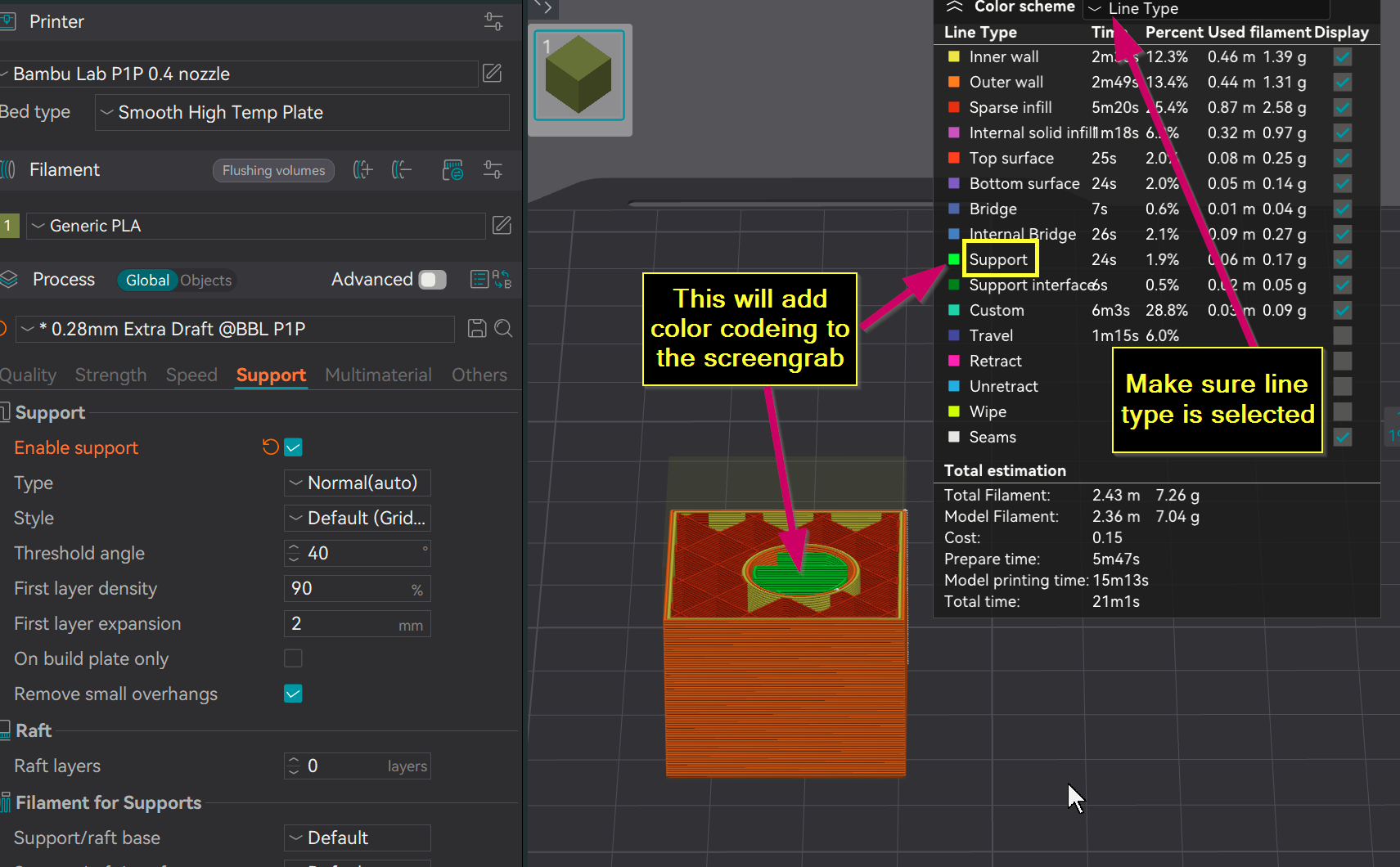

In Bambu studio I’m creating a negative part to bury a magnet, simple eh. When the negative part is sticking out of the object, the hole is a perfect cut and fit, but I want to have a couple of layers of filament to hide it and when I bury it, Bambu studio creates an infill hence nowhere to place the magnet. What am I missing? I’ve done this in the past and I’m sure it worked just fine.

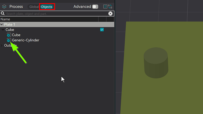

Click on the part & choose add Modifier.

What I am looking for is the structure of the assembly. This is the parts of the screen that matter most in your screengrab:

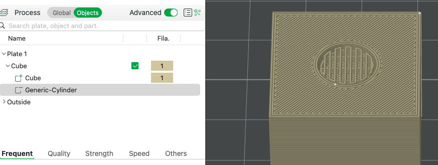

Here’s an animation that shows a correct result. You can see it’s possible.

Yes, that’s exactly what I’m trying to do. Is this image what you need to see? Thanks
OK. You have supports turn on. They need to be either disabled or blocked using the support paint blocker tool.
Also, when posting screengrabs, it’s important diagnostic tool to ensure that you have line type selected. You have filament selected which the slicer will default to if you’re using multi color print.
With supports turn on

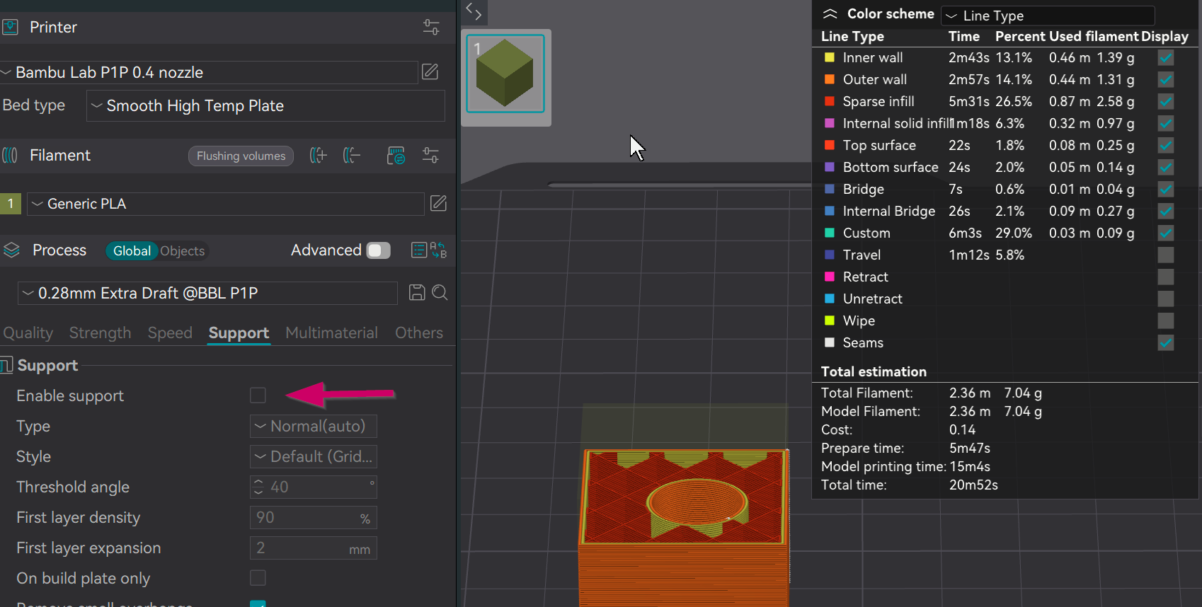

With supports turned off.
■■■■! How did I miss that… Thanks so much for the help @Olias that’s great, much appreciated!
