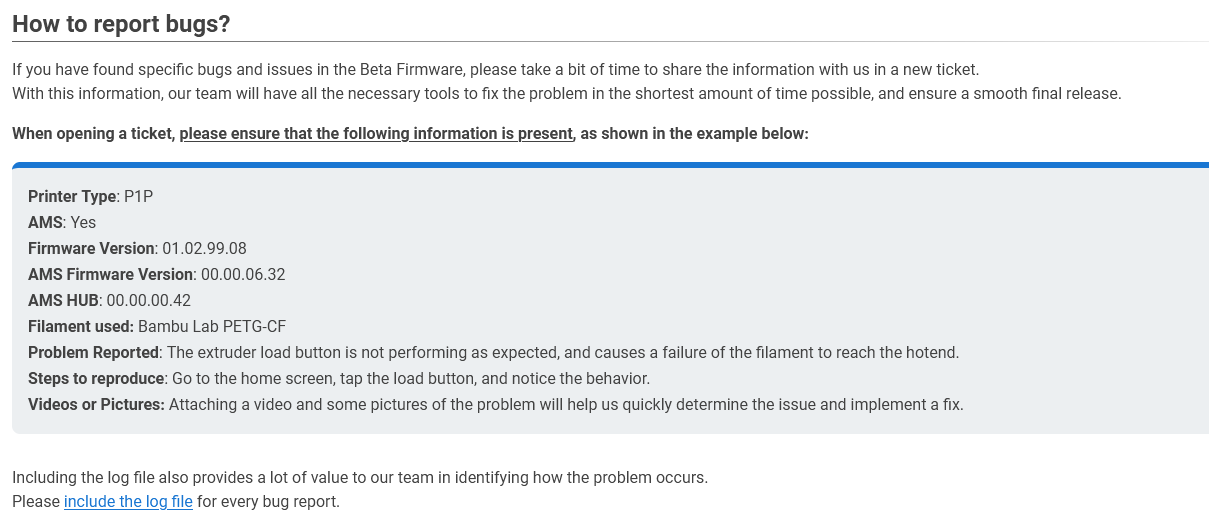

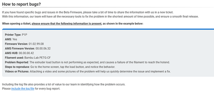

The page about beta firmware states this:
The developers do not follow the forum, so issues mentioned here are unlikely to be seen. Even if they did look, the complaints seldom have enough detail to be helpful.
Bugs need to be reported with a support ticket, with as many details as possible, including project files and logs.
