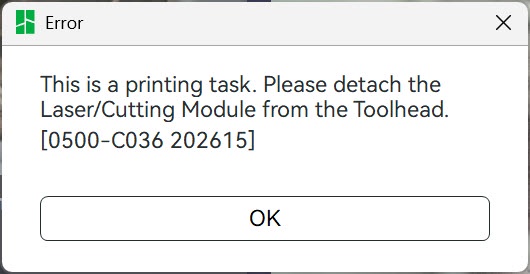

So, 30 hours into a 33 hour print I got this message:
“This is a printing task please detach the laser cutting module from the toolhead”
I do not have a Laser or Cutting module… resuming the error just pops the error up again… if I resume it enough it prints another layer and pops the error again… I searched the forum and I think I unlocked a new error message…

I tried rebooting the printer, it resumed and popped the same error as well as ‘Please plug in the module connector’
This is a straight printing job… I have made dozens and dozens of successful prints before this… I did just upgrade to 01.01.02.08…

Here is the error message:

could be a false possitive like the P1 random “toolhead fell off” errors. Try to check if theres also a magnet sensor of some kind, cause it says “detach” not disconnect’, which makes me think it refers to the actual “attachment”
Maybe someone who has the laser can chime in if it has a sensor of some sort
Thanks! I might have to just disassemble the Toolhead… and reassemble… I had to do that with my X1C… .basically reseat the USB C cable from the toolhead to the board…
could just be a magnet that detached and attached itself on the “laser magnet” , or could be optical sensor and it has debris? Dunno really, i want the laser like hell but couldnt get it for now :3
