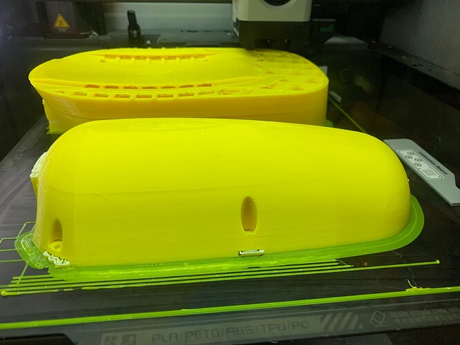

Pic shows a two part fairly large print in progress. PETG with PLA support interface layers. There is a slight layer shift at the 24 mm layer, but I have often seen this in the past.
Note that I do slow down the PETG and ASA max vol speed a lot since the stock settings create very poor layer adhesion. My parts are functional in the ocean so part strength wins over print speed for me.
