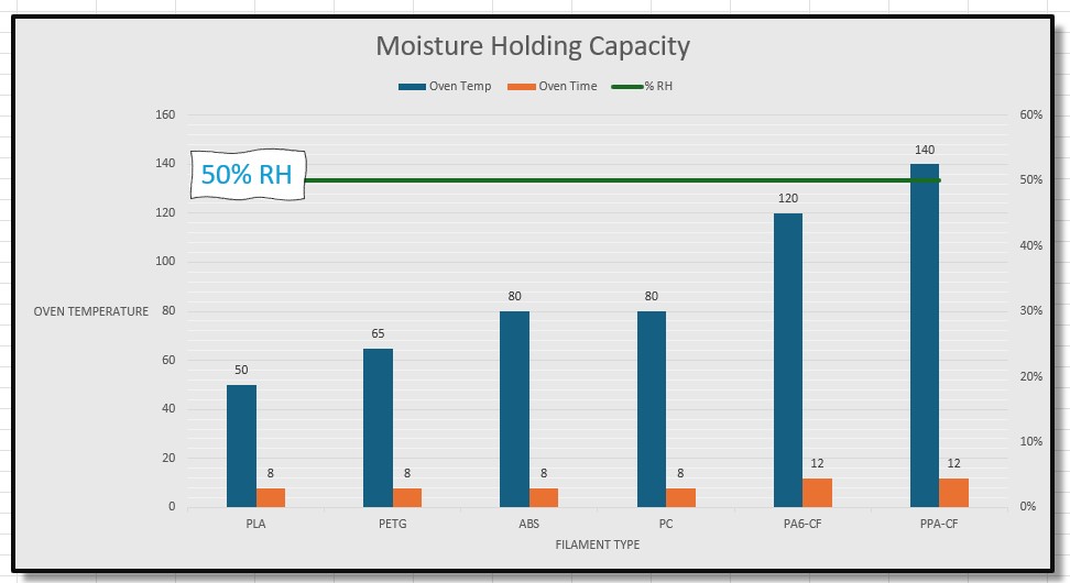

Dryness and humidity are two different things. They are indirectly related but different filaments will have more or less of a propensity to absorb moisture.
Different filaments will become saturated at different values.
So what you’re saying is my wife wasnt lying?
Not sure what you are asking.
Filaments range from drying is optional (PLA), up through mandatory long drying cycle (PPS-CF).
So you go from PLA at one end of chart up through PPA-CF where a long drying time at a high temperature is required
Different filaments are different chemicals which have different characteristics.
