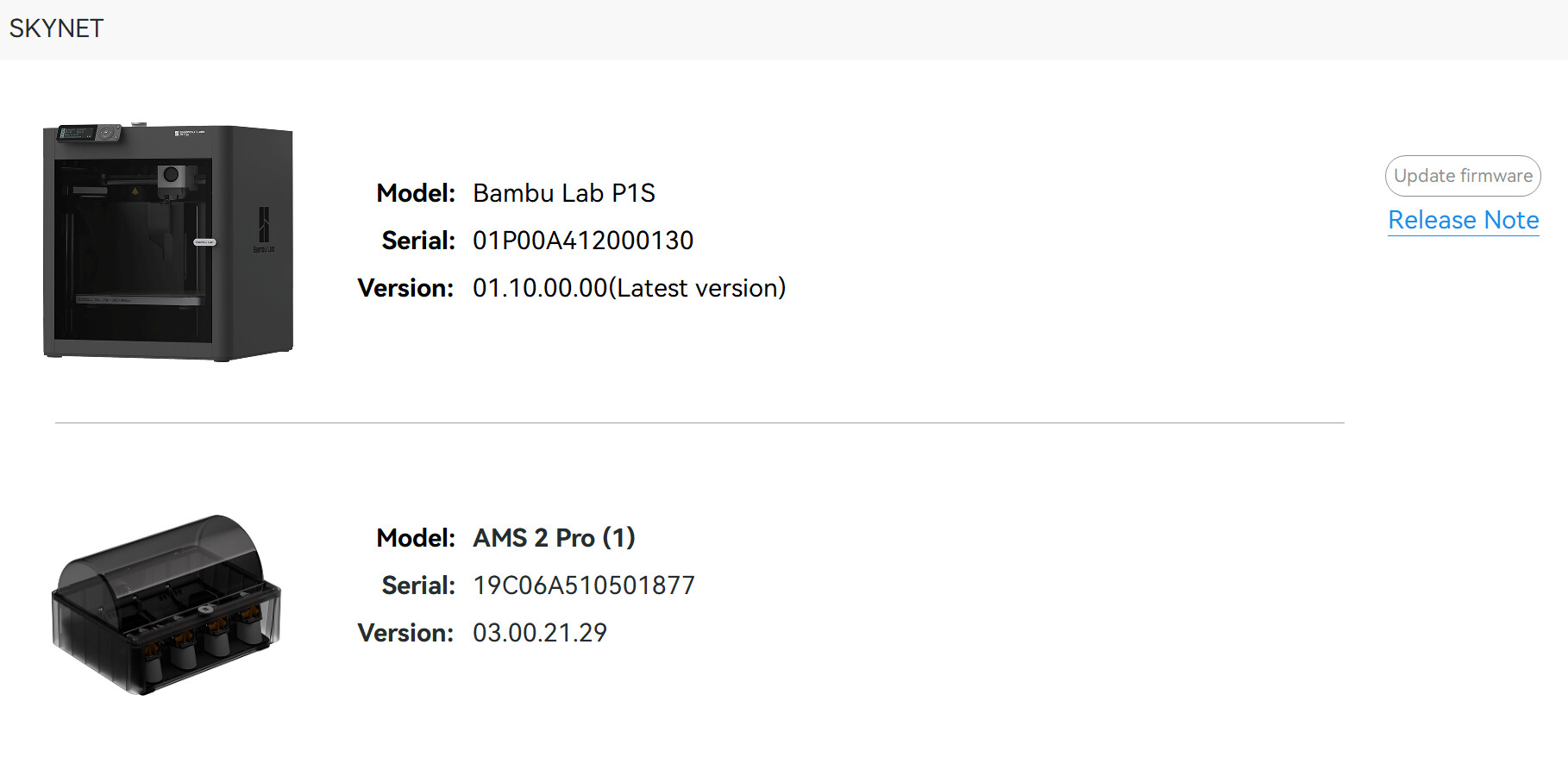

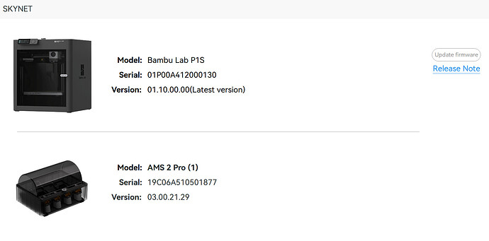

I updated my P1S firmware as soon as the update popped up on my printer today - It sits next to me in the room…… I feel like it bricked my printer….. The printer basically said it cannot do time-lapse video when the SD card is not present / is not formatted… Thought that was a strange message, and it had something to do with the update, so i formatted it - 3 times now my printer has randomly power cycled itself, and the display is extremely sluggish and having visual artifacts of the previous menu item when / if it responds at all… When you go to the downloads page for the P1S there is only the old version there - 1.10 is not there.

Reverting to the previous working version can be done through Bambu Studio or Bambu’s app. I’ve done it myself a few times, and plenty other users have successfully done it as well.

For those of you saying “Revert back a version” - I did! I pretty much did it right after I posted this topic. I just wanted to put this topic out there to get the bug-report out that there was a botched update and that others should use caution…. And also call attention to the fact that they (BL) pushed an update of firmware without posting the firmware to the actual download page of the P1S firmware update versions page… The page still to this day says that the latest version for the P1S is: Version 01.09.01.00 - released 2026/01/27. Clearly either documentation is incorrect, or the update was released to the masses with the incorrect parameters, and was possibly never meant to go to the P1 series.
