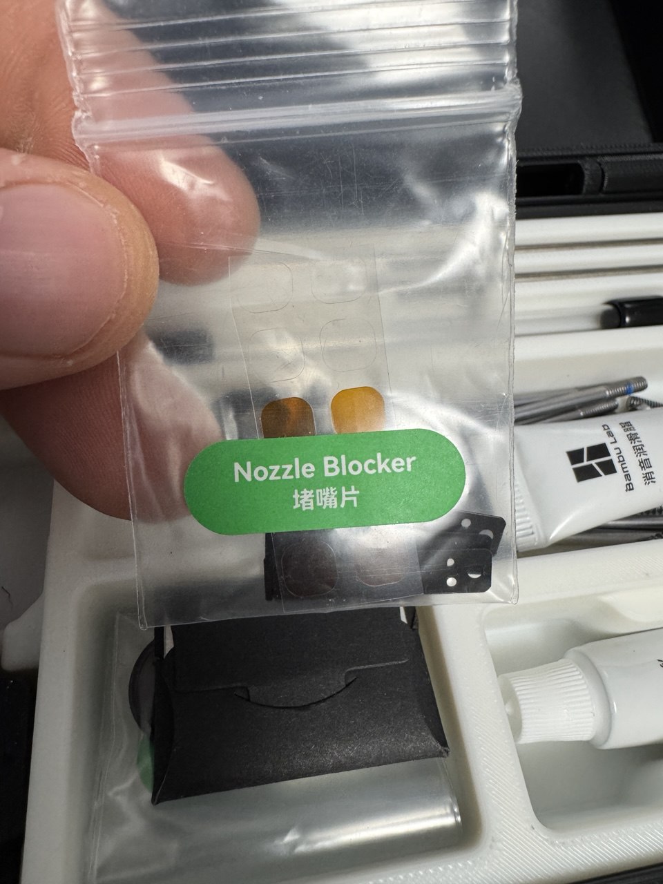

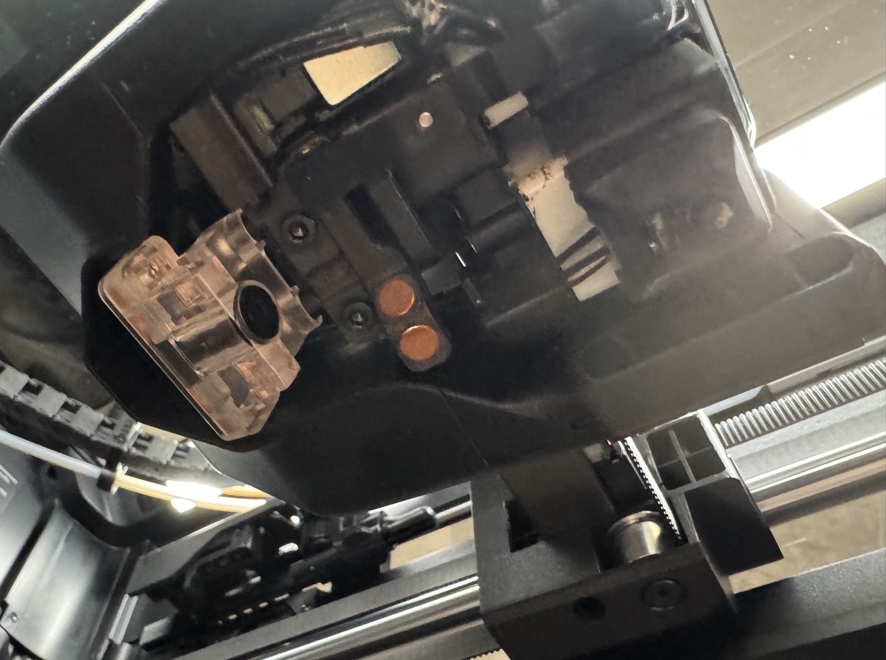

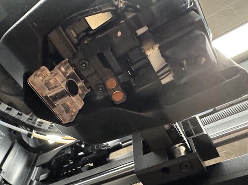

Hi guys, I have exactly the same problem. I noticed that the tall magnet seems to get caught on the edge. I solved the issue as follows: in my kit, there were these orange stickers, and something similar is already stuck onto the magnets under the nozzles — but the middle (angled) magnet didn’t have any sticker on it. So I just applied one of the included stickers from the kit onto that magnet.
And now it’s been 3 days without a single issue during toolhead switching.
Support didn’t give me any answer either, and in the live chat they said they had no idea what those stickers were for — just shrugged their shoulders
I think that some of the units have just a very slight alignment issue that happens to cause the tight tolerances of the flow blocker arm/magnet interaction to bind a bit. After some use of mine, it is working ok now even without using the radius-ed part I used to get it to work. Putting those teflon/kapton or whatever stickers on it lubricates where it hits I imagine.
