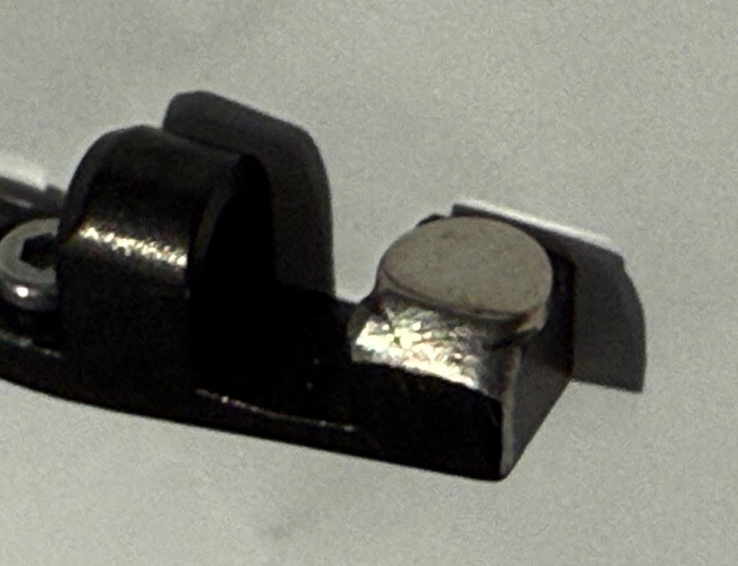

Then I disassembled the filament cooling fan duct and took a look at the “flow blocker”
This flow blocker with a magent mounted on top seems to be the problem!
The blocker seems to “hinder” the travel of the mechanism “deep inside the hotend” which moves the left extruder down and up.
When I “help” the flow blocker with my fingers to reach the end positions, the error message “goes away”.
As a temporary fix, I just unscrewed/removed the flow blocker, and now all works fine and printing works flawlessly.
I will investigate the impact of the missing flow blocker on the quality of my prints.
This is certainly not the final solution, but it works temporarily.
I have the “feeling” that the magnet on the flow blocker hinders when “blocking” the right extruder, the full travel inside the mechanism.
It seems to me that the magnet “sticks out” too high and makes contact with the other side too early, so that the switching mechanism can not fully push out the left extruder.
(Note: the message always only came when switching from the left extruder back to the right extruder)

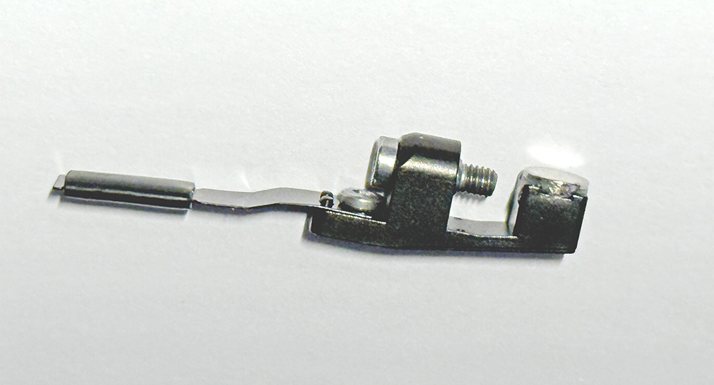

Yes, I have EXACTLY the same issue. When moving to Right nozzle, the mechanism behind the rubber part that blocks the nozzle hits the magnet support area and won’t move all the way over. I can manually rotate it over, and it is ok, but when the nozzles try to switch again as part of calibration, the issue repeats itself.
I also removed the lever, and notice the magnet is high and may be the reason for the obstruction. As in your case, with the lever removed (pic attached of what I removed), printing proceeds as expected with no nozzle switch/extruder switch errors.
After looking at several close-up videos of how the flow blocker got jammed when moving to the right nozzle, I radius-ed the edge that was catching a bit using a Dremel tool, followed by a ceramic file and finally some rouge to make it smooth. The radius-ing includes both the holder that the magnet fits in and the side of the magnet too. See picture. I put it back on the H2D and so far the switching between left and right nozzles (and extruder switching that goes along with it), appear to be working well. It is interesting that not all H2D’s have this issue. I wonder if there is some very minor variance in the mechanism that moves back and forth that causes this binding on some machines. I haven’t gotten a response to my support ticket on this, but I’ve sent very detailed descriptions of my issue and testing with pics and videos. Hopefully Bambu will respond by slightly modifying that radius on the flow blocker going forward and provide those to us. Without the flow blocker, you can do multi-color dual nozzle prints, but the purge/clean up cube is pretty messy and there is always the chance that some excess filament from the currently unused nozzle will drip or get caught on the print underway.
