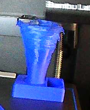

I am new to 3d printing, so I might be missing something obvious, but suddenly a day or two ago I have been having some printer issues.
Have a P1S (with stock hot end) for about a month now (and about 100 hours of prints), lots of good prints. Using Bambulabs filament (Mostly pla, a few PETG and one ABS print. Most is PLA Basic, one or two PLA Matte). About two days ago I had started to have mostly constant failed prints.
It started when I had a failed print with some weak stringy layers in the middle of the print (First time using PLA Basic Grey) - but I was not worried yet as the printer is installed next to the front door and I had a large delivery during the print so there might have been some shaking of the device.
Next few prints also failed using other colours I had used successfully in the past.
Tried cleaning the hot end (Poking the needle into the end to remove a clog if that is what it was). Would print the sample tests well (The calibration squares, calibration lines, and some 10mm cubes I tested in a few colours as well).
Then when I try to do longer prints they fail after the first 100 or so layers. Here is an example of what the top half looks like (I forgot to take a picture before I separated them apart). This was supposed to be the top of a funnel.
Some prints look like this (Which looks like under-extrusion?)
But even though it looks like under extrusion, I did run the flow rate calibration right before printing.
Ive tried cleaning the nozzle a few times. I have also partially removed the hot end to try a cold pull described here: Nozzle/Hotend Unclogging Procedure for X1/P1 | Bambu Lab Wiki
The common problem that seems to happen during cleaning is that when I manually extrude the filament it seems to curve back up towards the nozzle rather then coming straight down. I do eventually get it going straight down, but that seems to only last for a short time before going back to the irregular.
I have not tried replacing the hot end with the spare hot end that Bambu comes with.
Should I reach out to support? Or is there something that I can do to resolve the issue?
Edit, I did try another print and stopped it as the stringing started to happen - here is the shot from the top:
Edit2: I do have a time-lapse of one of the fails, but it is a large file so cant upload it here. Can find a way if it would be helpful! Here is a screen cap of it

Second, the blue hexigon print. The stringing i think is an artifact of the other issue I am seeing. I don’t think it is bed adhesion as the print was quite stuck to the bed (had to use a scraper to get it off easily). Here is the print that I did just before it (it is the 10th print of this one I have done so far)
The yellow circle thing is the top of the print from this print: Box & Bolt, 3D Printed Cardboard Crafting Tools by Valeria Momo & Mattia - MakerWorld. This was in Bambu PLA basic Yellow. I was able to print this in yellow (Same filament roll) after re-calibrating everything and doing a hot end poke with a needle. But then the next print in yellow failed. Here is a photo one before / after calibration (but then without changing anything the calibration starts slip after a small amount of printing.)
The grey one is this print: Millennium Falcon Nest Mini Holder Remixed by nweishar - MakerWorld in Bambu PLA Basic Grey. The green squares you added are part of the model.
I did thought I mentioned that I did calibrate - I ran 3 calibration tests (with the squares and numbers) and 3 or 4 calibration tests with the lines / V pattern to set the K Values.
Regarding drying the filament - I do not have a dryer. I didnt think I needed to dry them right away :frowning: I have put the filaments in a dry box (sealed cereal box with desiccant inside, maintaining 10% humidity level). AMS has desiccant inside as well and also has a 10% humidity level.
Edit: This is the funnel that has the strings at the top: Bosch 800 Series Dishwasher Rinse Aid Funnel by Boxerman - MakerWorld

OK. Armed with the new data, let me go through what is worth investigating one piece of evidence at a time.
  1. You’re ruling out bed adhesion, so cross that off the list.
  2. This new image information on this information is telling. What I am seeing here can be explained by filament moisture but it could also be filament speed. The point is, you can try to calibrate out the speed portion.
  • Try running the printer in “silent Mode” which is 50% speed. This will give you a one-button experiment to see if the problem is flow related at the expense of doubling the print time. However, if it is flow related, then you can focus on filament calibration.
  • This example here that for some reason did not display the first time I read this post, is an example of speed-induced flow problems. As you change layers, the filament isn’t “setting” properly. Slowing it down can help.

Managed to find some time today to go over most of your suggestions. I also tried to reach out to Bambu (as the printer is less then one month old. Wasnt expecting anything based on some comments I have seen here but you never know!).
Bambu said that it seems like a clog and they are going to send me a new hotend. Since the wife needs some prints tomorrow I thought that I would preemptively change out the hot end with the spare that comes with the printer and give it a shot. The spare worked perfectly with no changes (I decided to reset to factory defaults then run calibrations to remove anything I tried while attempting to debug the issue). Prints perfectly. Since I didnt change the colour, ams, settings or dry the filament - I guess this one was actually a clog! Not sure if I was improperly unclogging it or there was some other kind of foreign debris in the hotend that wont be easily removed. I will try to clean it out again when there is less holiday pressure as I do not like to waste!

Hopefully you did not throw the nozzle away. You may be able to ‘save it’. It looks like it was a partial clog. You will have a number over the lifespan of the printer.
The best way to resolve it is to do a ‘cold pull’. To do that you want to heat up the hot end to 250°C And run cleaning filament through it. Only run about 2 to 5 inches or 10 to 20 cmof cleaning filament through the end of the nozzle. Then turn your temperature down to 100°C And wait until the temperature actually hits 100. Then press the extruder gear up so that way the filament will be unloading. At the same time, pull up on the filament at the top of the extruder assembly. When you pull it out, you will likely find material stuck on the cleaning filament. Continue to do and tell the filament is coming out straight underneath the nozzle and not off to the side like a 45° angle or more make sure that the filament is coming out straight. When you pull the filament back out, make sure that the filament is clean and does not have any extra debris. You will likely need to do this 2 to 5 times.
