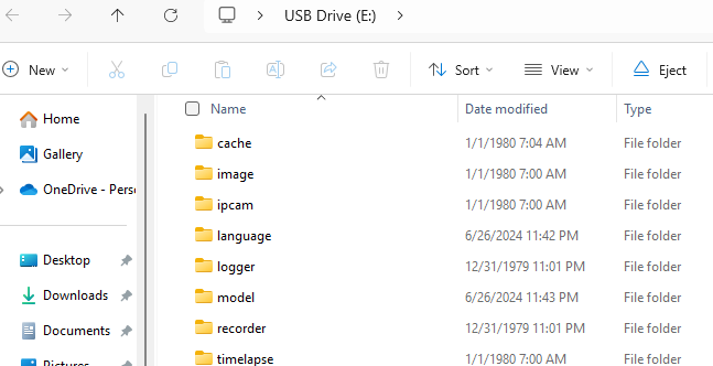

How do I put the SSID…Password, on the SD Card root directory?
I don’t see a root directory.
Edit: Firmware 01.05.01.00, this may need up dated first, something else out of my league. I don’t remember my A1 Mini having these problems.
The root directory is the top level folder.

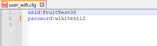

user_wifi.cfg file goes at top level, not in any folders. Once you actually get connected to printer you can delete user_wifi.cfg from the card, until you do a factory reset.
Edit: use something like Notepad or Notepad ++ to create file.
Edit2: you can’t actually switch to LAN only mode until you at least get a SSID to display under WLAN on printer display, then you can go in and switch to LAN only and you can see if it actually picked up an IP or not.

Do you mean “cache”

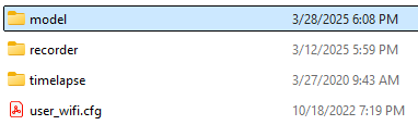

No, it’s the directory those folders are in… like this…
This is out of my league, so I copy and paste it in model folder?
No, you put them in a file named user_wifi.cfg and put them in the root of the drive like in the picture I posted. Jon posted a link to the instructions:
Seeing the connection might mean using the administration interface for your router/wifi device. Not sure what country you are in but with say a xfinity/comcast supplied router you can go in and see both LANs. And it can be a good idea to assign them different names (& passwords) for the SSID, like mywifiname and mywifiname5 so that it is easier to know what you are connecting to. I will say that 2.4 is getting to be considered old school by some people and you may actually find wifi devices that don’t have a 2.4 side.
PrinterMcgee was just showing you an example with the file in place, he (?) just happened to have the model folder highlighted but wasn’t intending to mean to put the file there.

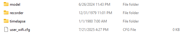

How I got the above file, “New” >“Text Document”, then edited file name, “user_wifi.cfg”
Copied the words in notepad and tried to paste in that file.
I must have done something, it’s showing 1K
When I double click on it, it ask what program to open, then I pick Notepad and it’s there.
To open the file I have to pick Notepad every time.
But will that work when I put the SD card in the printer?
Yes.
You have to open the “.cfg” file with notepad to view it because it isn’t a “.txt” so your system doesn’t know what to natively open it with. The printer scans the SD card on boot for to see if there is a “.cfg” file.

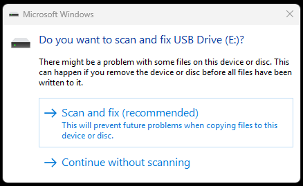

I’m getting this when I connect SD card to computer.
Should I let it Scan and fix.
Or save models, then format at the printer.
