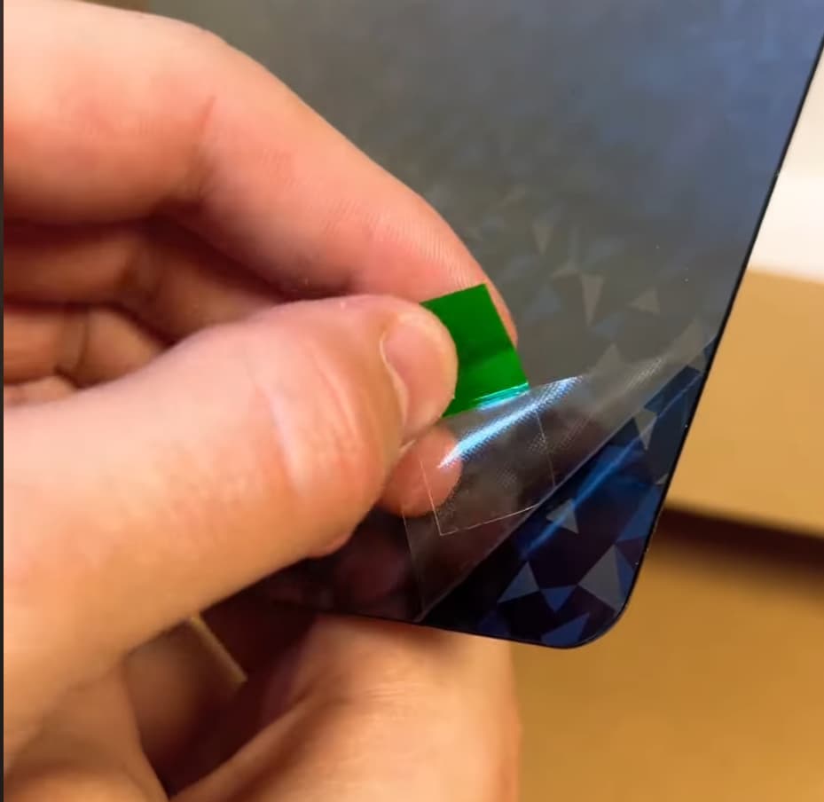

Remove both, otherwise the film may bulge and the plate jump off the heating bed, damaging your printer. That’s why there is a green flag telling you to remove it.
3D effects plate. That explains it.
I thought he was talking about this, I was confused about the clear shipping protector.
https://us.store.bambulab.com/products/bambu-smooth-pei-plate
Thanks a lot… looking at the picture I suspect I should have looked more closely.
