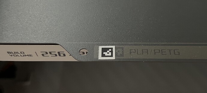

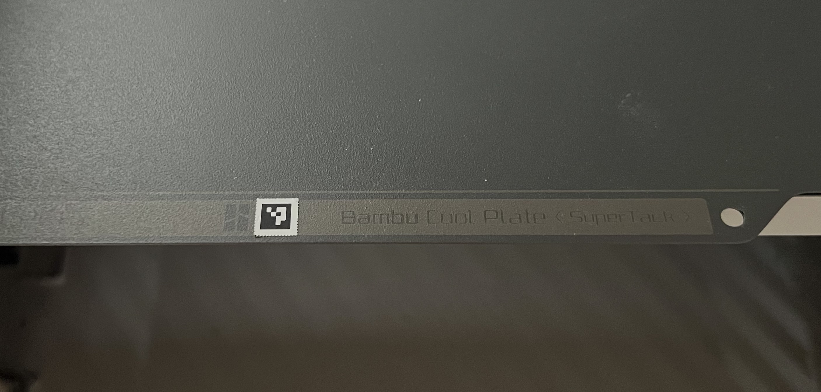

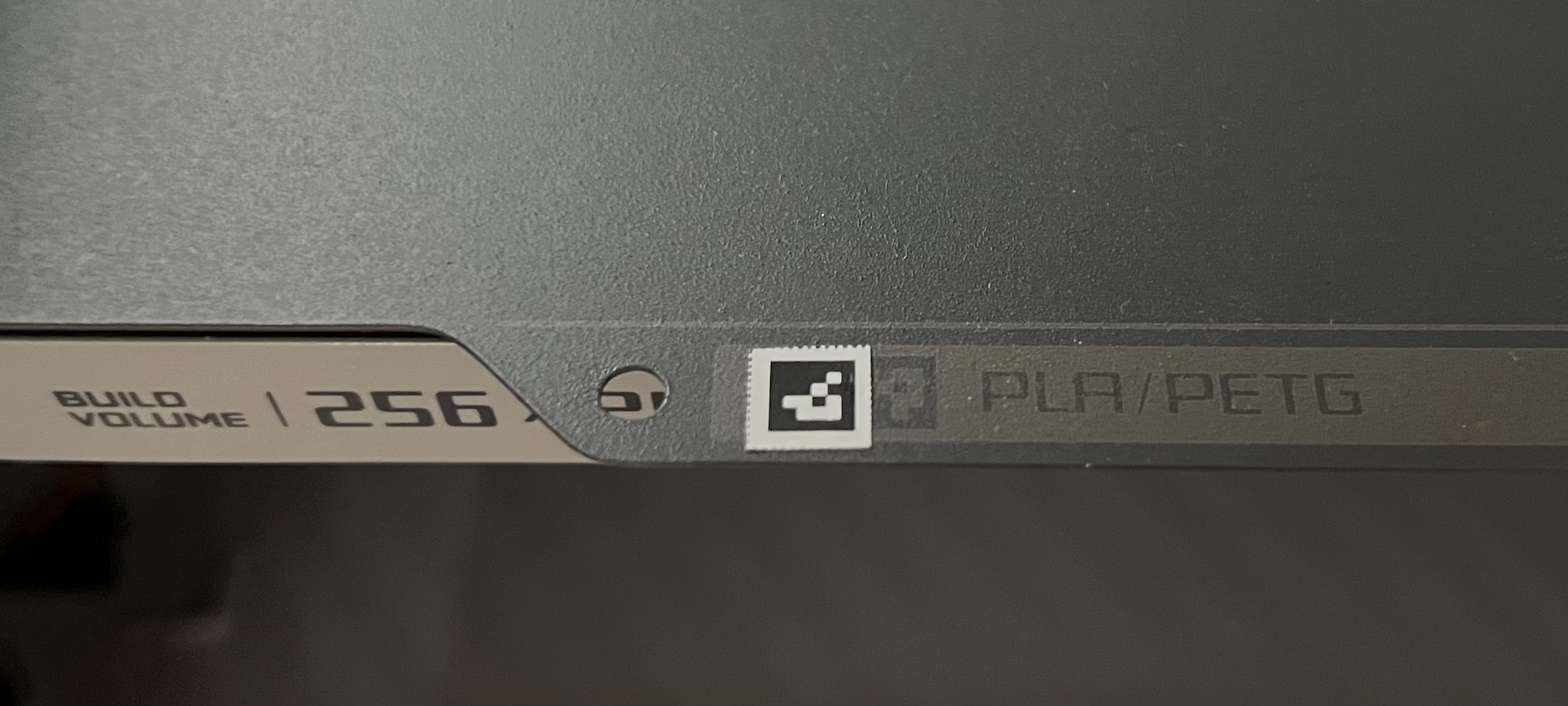

Printing out cool plate QR-Codes and gluing them on fixes the recognition. I guess the original code is too low in contrast. As you can see in the pictures, the position of the code is also misaligned on one side.

Of note matching the position of the QR code on the SuperTack plate to the old cool plate, the positions align and the symbols match. Which suggests that the contrast of the SuperTack QR code is not sufficient for the camera to detect the code.

I used the link above to download the QR Code for the Super Tacky plate and printed out 2 of them on my Brother P-Touch label maker. As stated above, on one side the new QR goes right on top of the existing “dim” one. However, on the other side, it must be moved to the left a little.
Mines detecting one one side, but not the other.

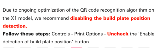

I received a response to the ticket submitted to Bambu overnight. In summary it said that a software update is pending release, disable plate detection until the update is released.

This worked for me. Using the old cool plate code printed and glued just to the side.

Because when you go in the bambulab shop and check for this plate, there is a message like this:
