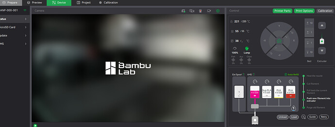

I changed filament trying to print it shows it printing support but still printing same color.
I know rebooting and resetting factory does not change a thing when it comes to using supports. I have printed several but it just ends up printing the same filament for support.

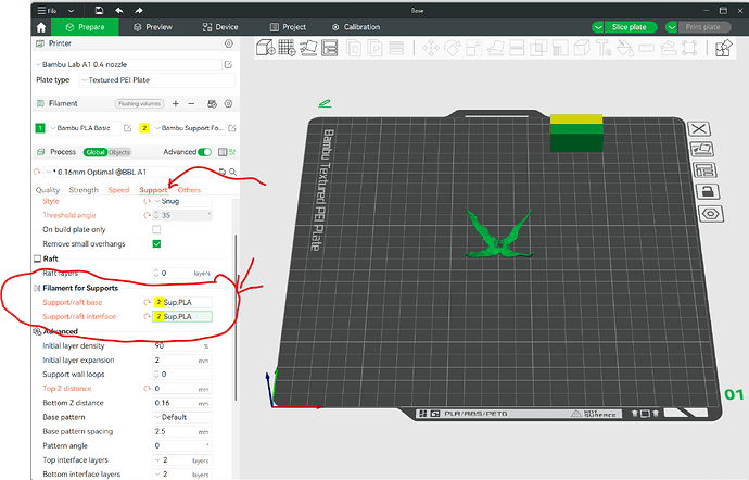

Change the support interface material. The setting is under the Prepare Tab, and then under Support.

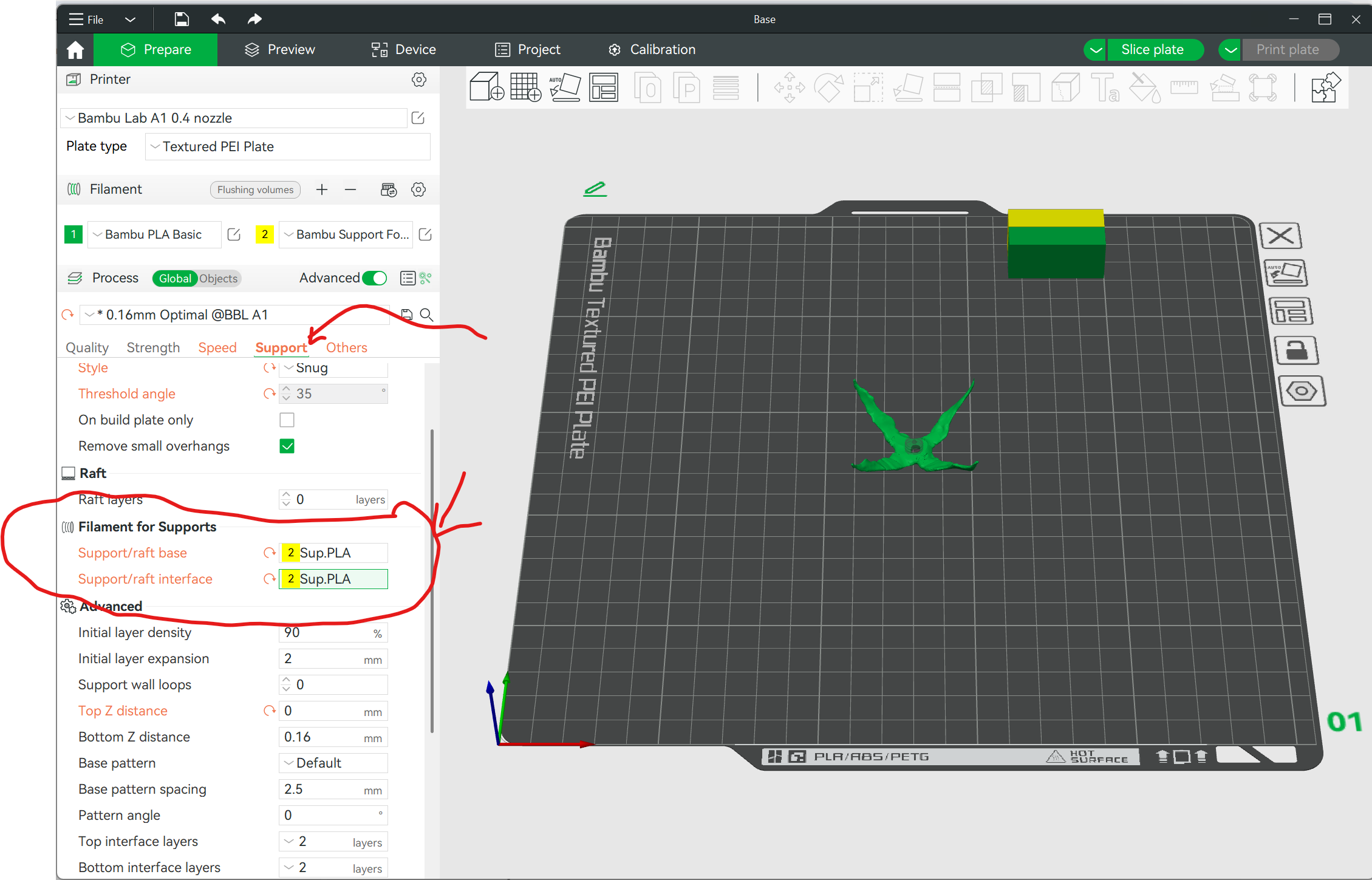

In this screenshot, you have the pink PLA selected as the support interface and not the “support for pla”, try changing that first.
No, in this photo he has default for interface, and the pink for base for some reason.
Ruby_in_Wyoming is correct, the issue is that you are trying to select support material but you do not have it selected for the support. Having it as default means that it will use whatever filament it has in the nozzle, not that it will use the support filament. Also using pink for base is a bad idea as you are just wasting filament for no reason.

Hi ! I had the same problem because I had only one filament int the “Filament” properties. Once the “PLA Sup” is added (using the + button), it’s available in the dropdown.
