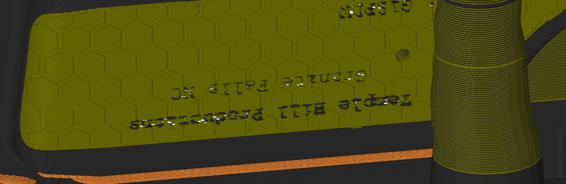

That said, I am doing some color prints, using PETG for interface and black and Green. I am printing text on my model and In the objects tab I have selected black as my text fill color. What am I doing wrong the text is printing the background color and obviously no visible.

Your issue here is a conflict with the imported STL already being colored. This colouring/painting overrides the modifier text colour selection.

Looking further into this the problem is actually that you have the Text set to “Modifier” not “Part”.
The text should have the little green plus sign not the green dot.
You need to change the type. Right click on the text shape and select “Change Type” and then “Part”
Slice it and the text is added.
You are going to need to adjust the text size as some of it is too small for the nozzle/layer height to print.

The issue is that it doesn’t seem like modifiers work on a painted surface.
Here is a generic cube in the same file with a painted surface. I added a modifier text shape on a non painted surface and a painted surface.
When you slice the painted surface text isn’t applied.
Yes trying to do flush. I saw the “modifer” in a youtube guess I misunderstood
No you understood right, it works in many instances, just not this one it seems.
